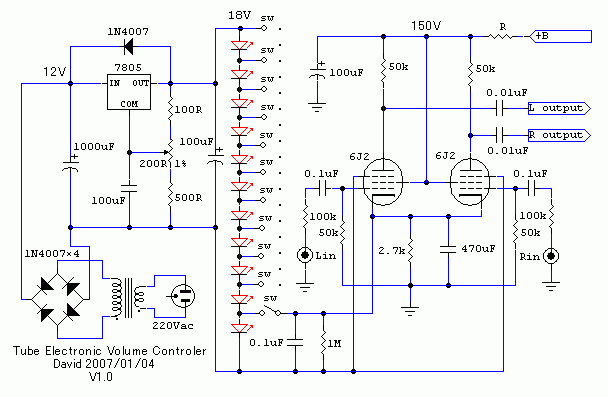

foboleyns said:hey,
here is the circuit my used with a pair of chinese 6J2. 6AU6 be able to instead without modify.
Hello, thanks for your schematic. 🙂
I have two questions.
Can you hear the steps when adjusting the volume?
Why didn't you use a regulating pentode like e.g. EF83 6K7 6DA6 ... ?
I can't find any tube data for the 6J2.
Kind regards,
Darius
Hi
Old thread but wondered if anyone tried foboleyns design above?
Looks interesting........another project maybe!

Using a variable-mu valve as an audio volume control may mean you have decided to choose between noise and distortion. You would need to do some careful noise estimates.
The fact that these are used successfully in AM receivers for gain control is due to:
1. lower expectations of noise and distortion performance,
2. harmonics and low frequency IMD are filtered away by IFTs.
The 6AU6/EF94 is not a suitable miniature substitute, as that is a straight valve. 6BA6/EF93 or EF92 might be better.
