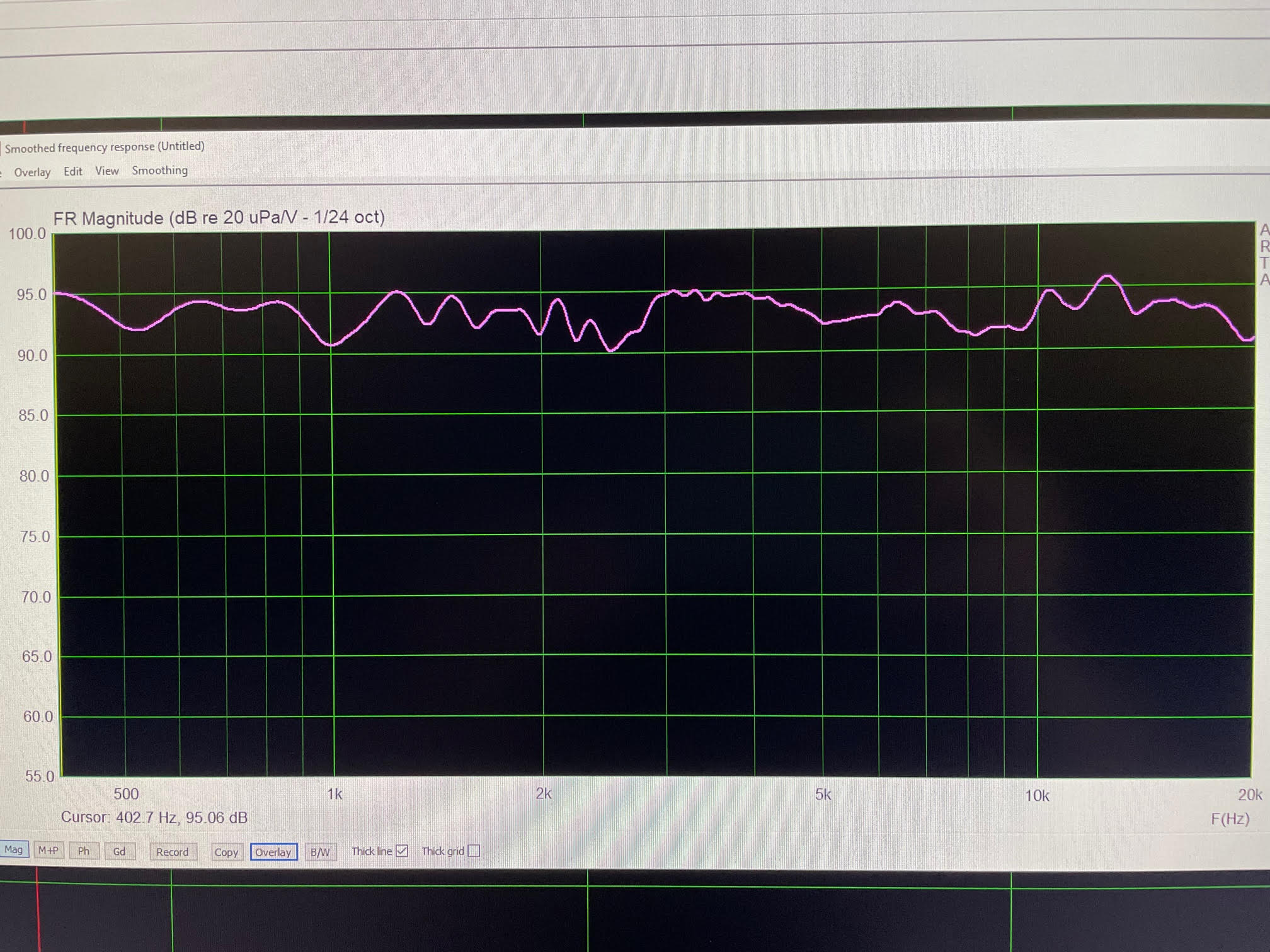

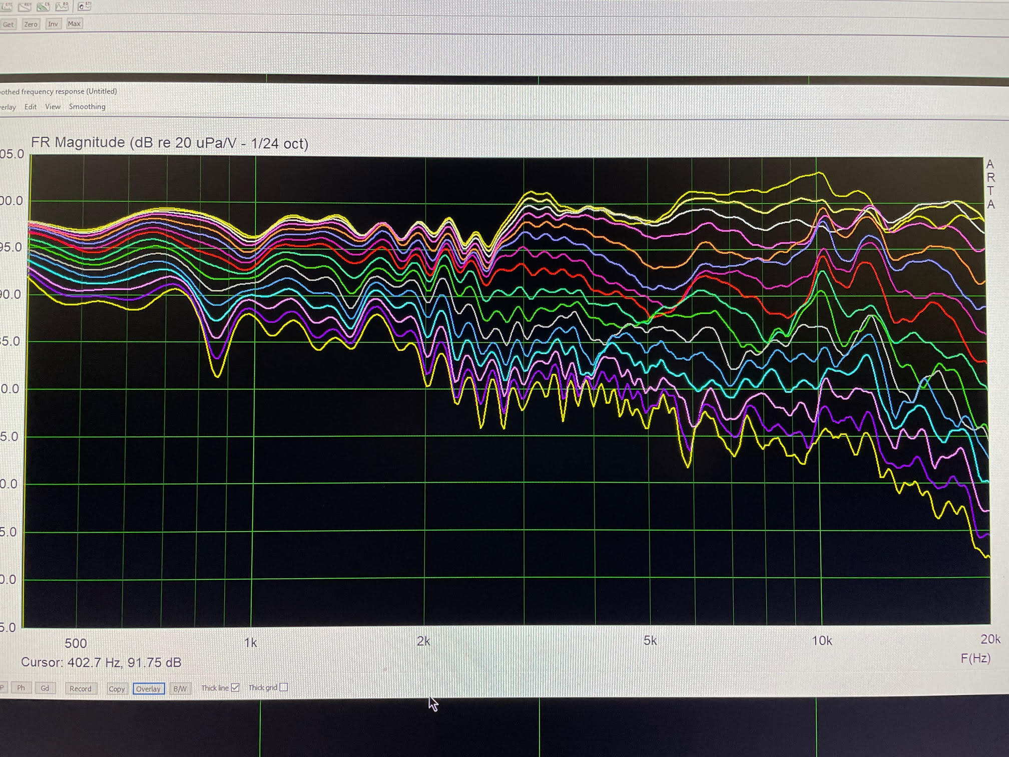

I built this speaker - but went with my own crossover (and bass driver - Dayton DSA-315).
They are a good-sounding speaker - but my only complaint is that they have a really really small sweet spot. The sound changes quite a bit if you move your head even a little.
I think it best to listen to them a further away. Here are some measurements on my speaker 0-75 (in increments of 5). Mind you - this is only 1 meter away from the horn. My crossover was specially optimized for a listening distance of 3.0m - and for the main listening axis at 10 degrees of center.
