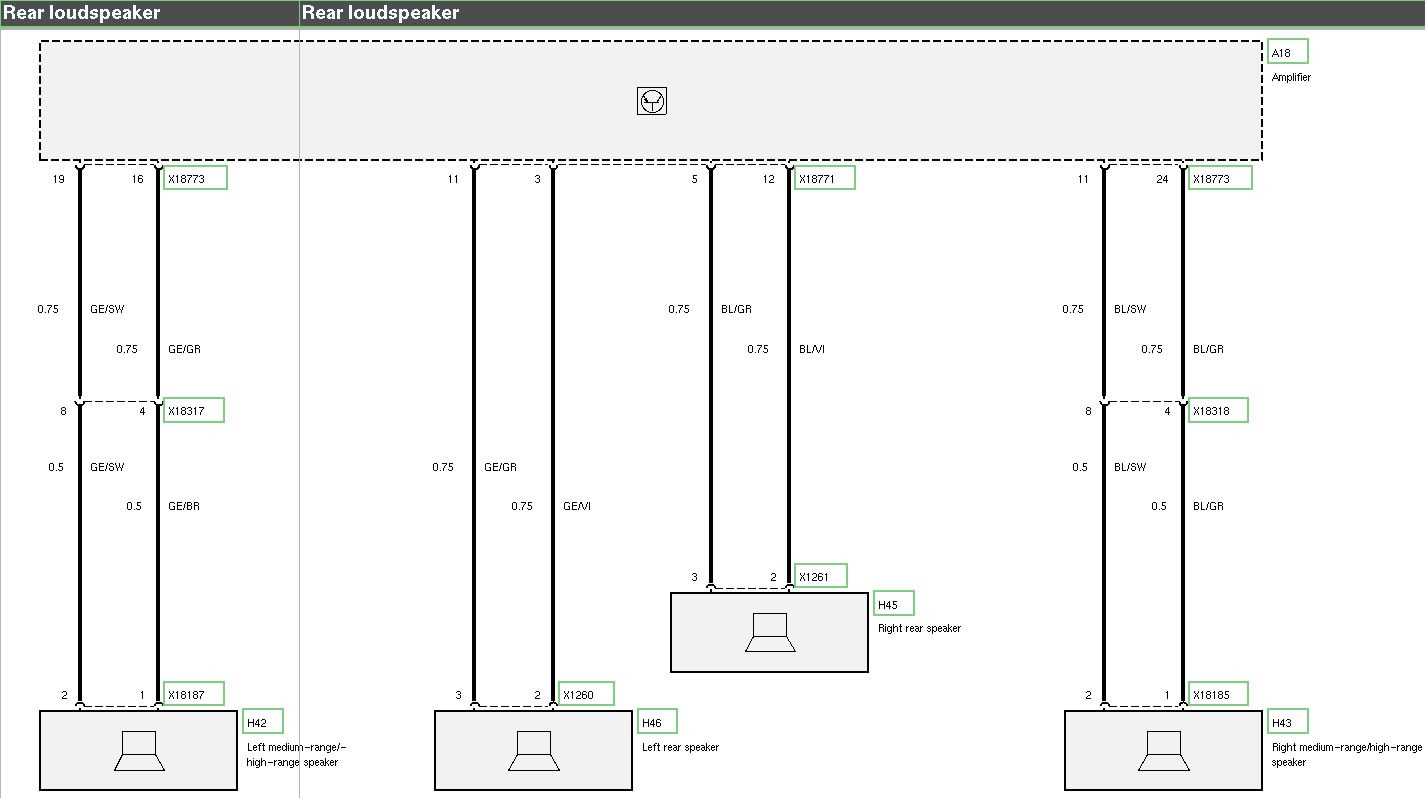

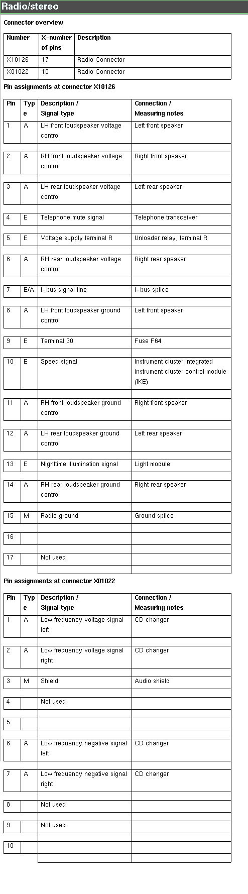

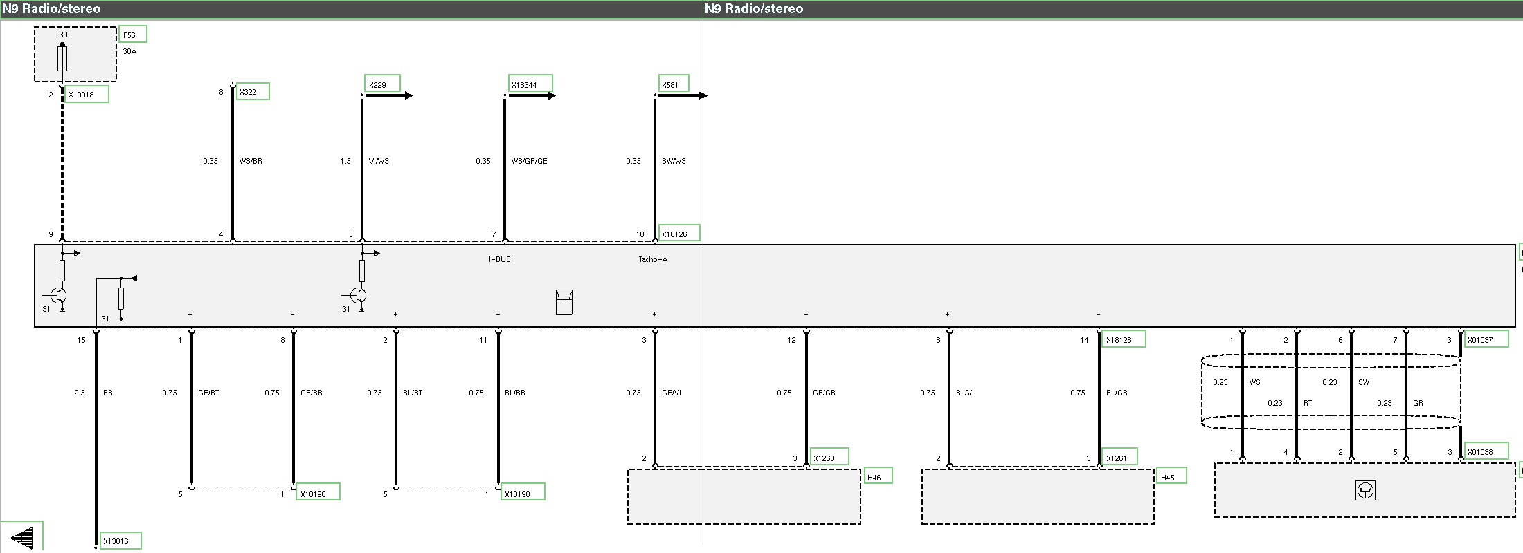

I don't know if this will help you but I have a few things saved for the E39 radio system. The pinouts are for the amp in the back. I'm still procrastinating on upgrading my E39's system 🙂
Hello, the European E39s usually do not come with the trunk mounted power amp that you guys in the US get...On the top of this the E39 was more expensive here when new. The issue is that the amplifier is inbuilt in the cassette head unit ( BMW Business RDS ). As far as I was able to find ( there`s really no info on the net ) it employs two TDA7315 chips for amplification/bass/treble which are located at the end of the unit. As the regulated power supply does not have outputs for heaters and etc. the tube buffer shall be avoided. I will open the unit this weekend and I will try to locate some clean preamp signal, I hope at the volume pot as suggested. If I could do so, then the signal should go to a pair of RCA jacks and the power amps in my trunk should get running.
