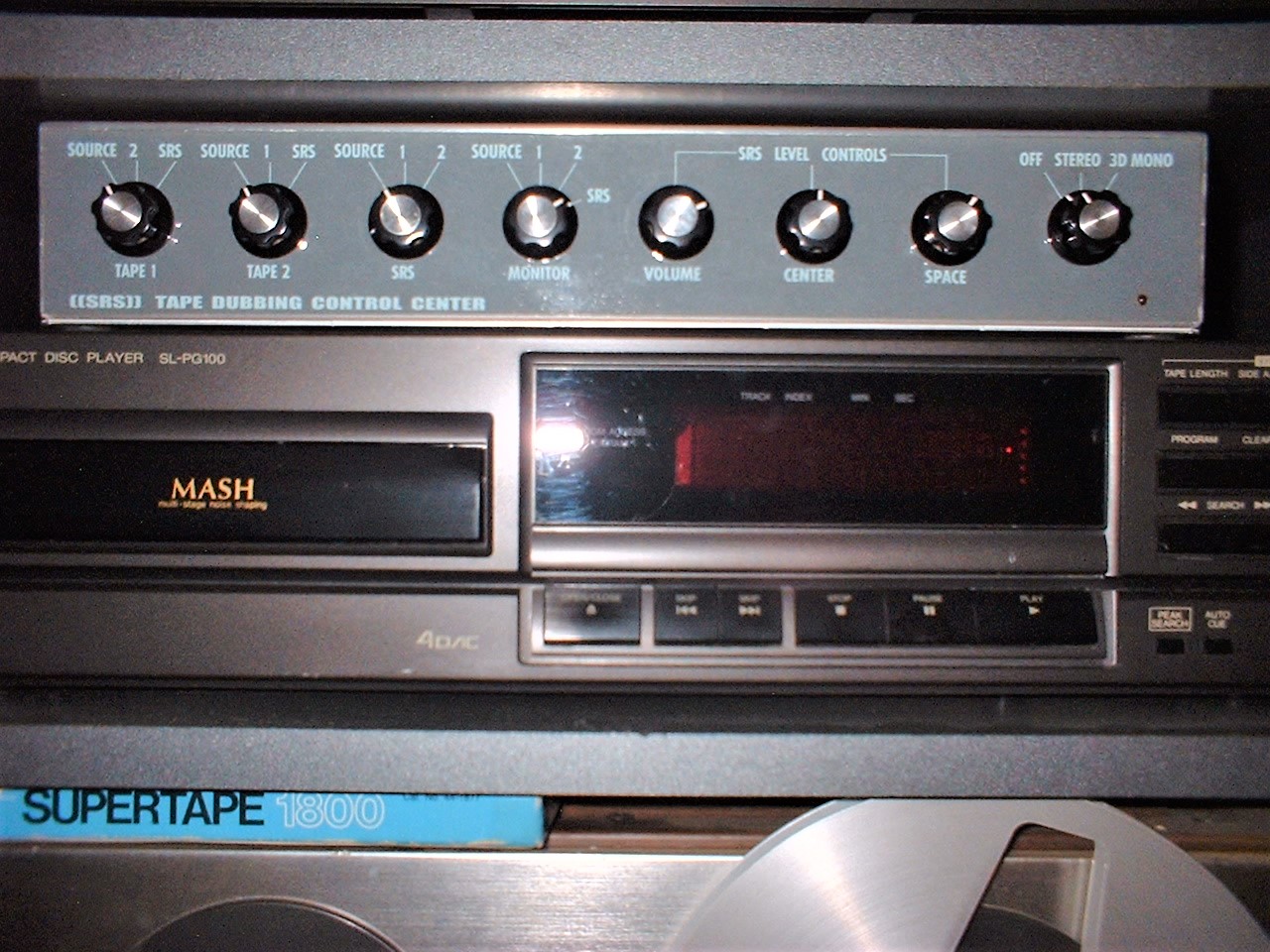

On occasion sometimes, I use a Hughes design of Sound Retrieval System (SRS) through one of my tape loops to give an expansive 3 dimensional quality and depth to the sound.
Even has a setting that enhances mono sound.
I built the system into a chassis along with a multi-function tape record/play dubbing arrangement, so I could also add the SRS into recordings.
For instance, if a tape/CD is played in a car, or a portable boombox, the music surrounds you, makes a boombox seem 6 feet wide.
