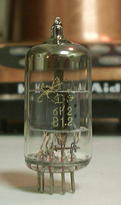

Not very clear from the photo, but my money would be on one of the VHF triode / pentodes like an ECF80 or something?

The wider left section leads be to believe it is the 6GH8/6U8/6EA8/... class triode pentode. Medium mu (maybe 50, ala 12AT7 as I said) triode plus pentode (comparable to 6AU6 or so, depending).

If you could rotate the tube 90 degrees and take another picture, we can resolve whether or not that's a different type of section or whether it's the same, but there's a shield between sections.
Looking by the messy tangle in the envelope base ....Far East certainly made this one....looks like
pin 1 = anode triode
pin 6 = anode pent
pin 7 = g1/2
pin 8 = screen + poss g3,K Pent
Pin 9 = grid triode
I agree with SY
The ECF80 is it's western twin. looking at an old 7199 it seems darned sim....however that was spudded together a bit better.

zxx123 said:I got this from my friend's gear.
However, I have never seen this before?
Can you let me know?
I think it is manfred. by chinese company.
Hi.
The type of this tube is 6F2 in my eye,which is a triode+pentode tube made in Shanghai,similar to the 6BL8.
Maybe I can find its data paper,but not now
cheers
X.G.

I just find one paper for the 6F2 datasheet

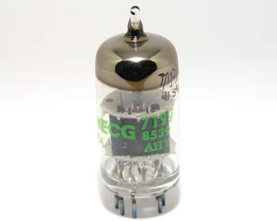

6an8 7199 6au8 6gh8 or ecf86

in fact if this tube comes from any dynaco-heathkit
el34 push-push 40w amplifier like audio institute or dynavox
VR70 ...whitch are st70dynaco 2*35W replica (2*40W for the
markIV)
you should pratically be sure that is't a 6an8 or 7199
equivalent....
obviously....
