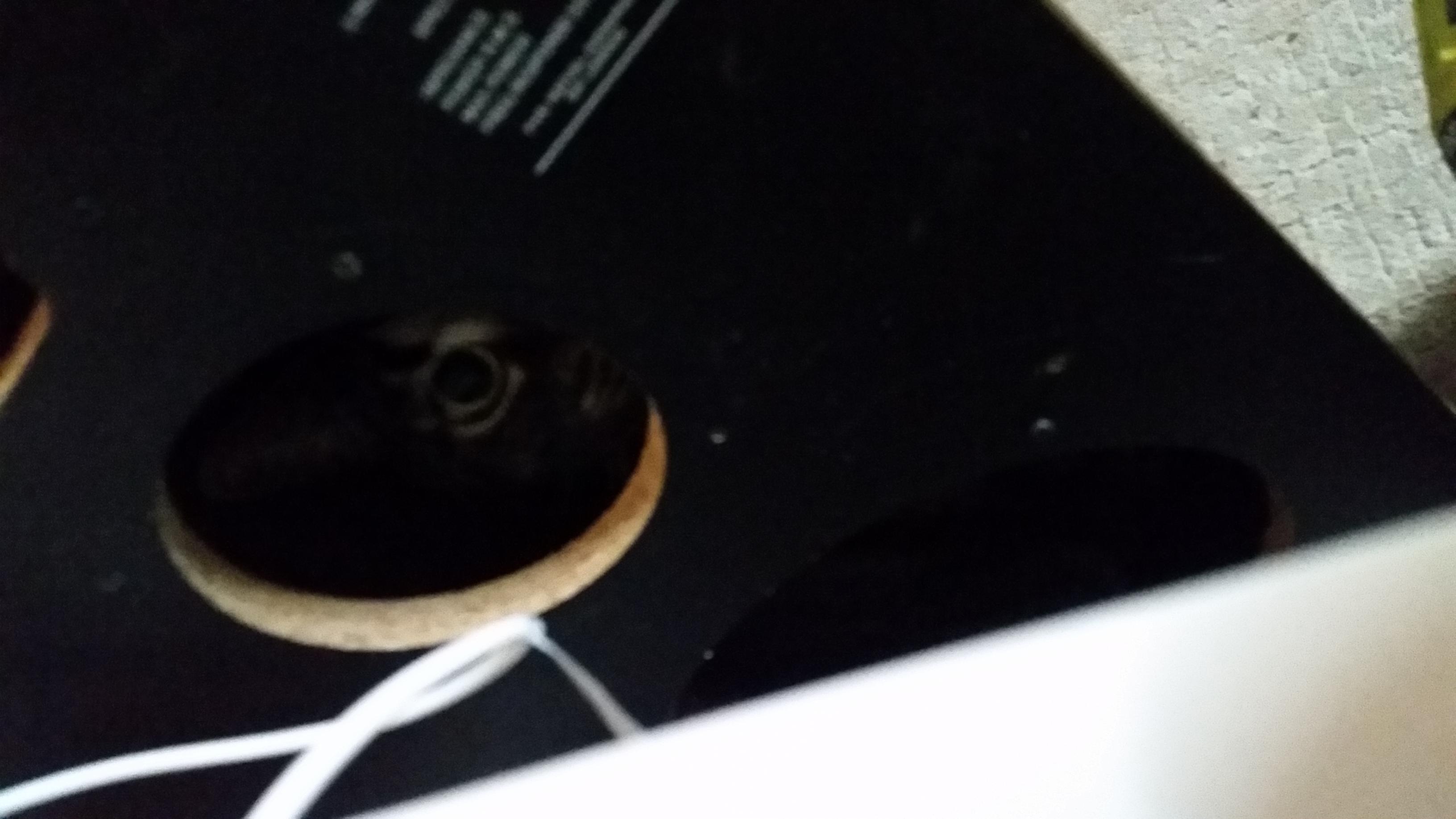

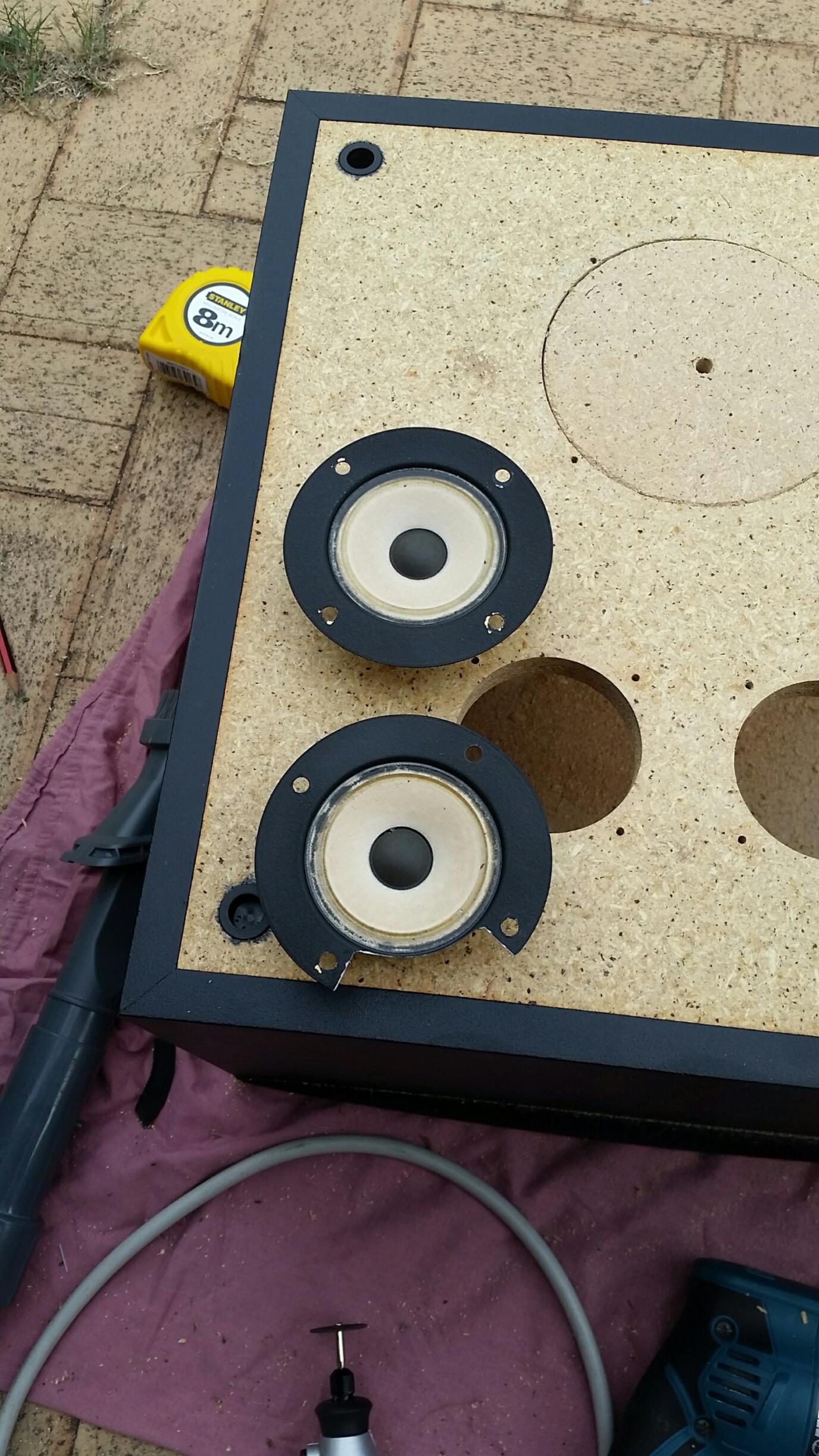

Hi Guys,

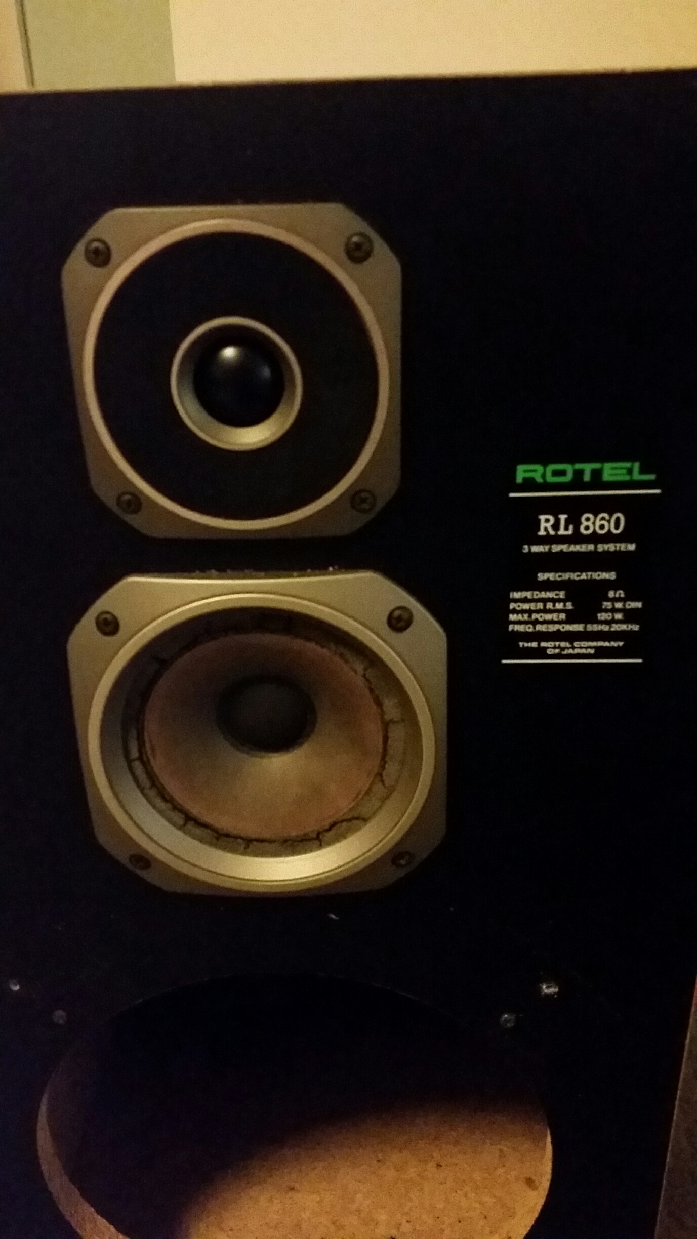

I've been on the lookout for some reasonably priced speaker enclosures to use for my projects instead of relying on my own dodgy woodworking skills when I came across this old 3 way minus woofers. It also came with a cheap all in one stereo + speakers that I'll stick in my office or workshop. Grand sum of $10, not bad at all.

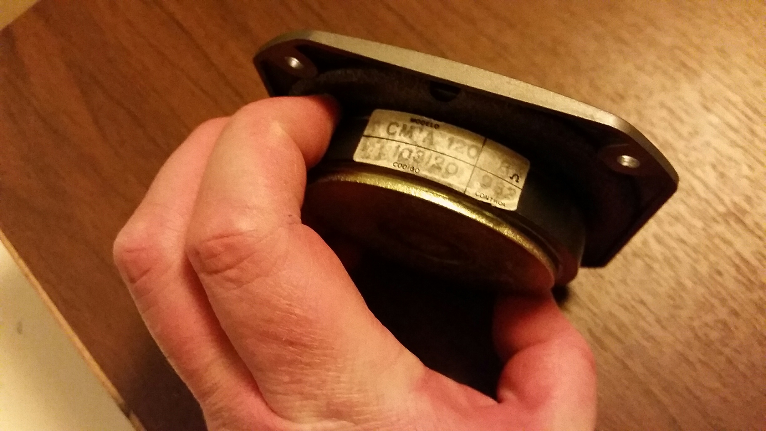

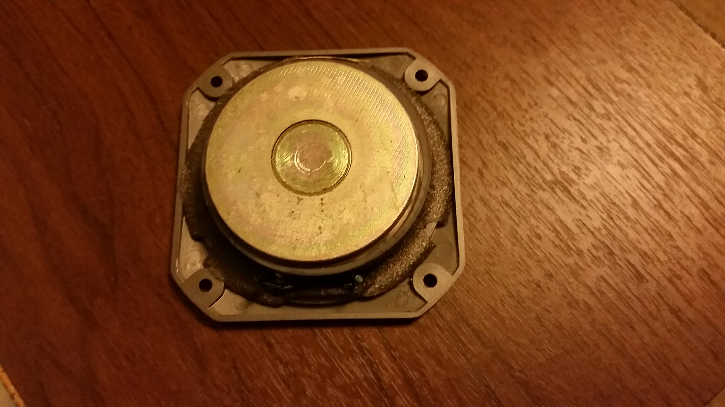

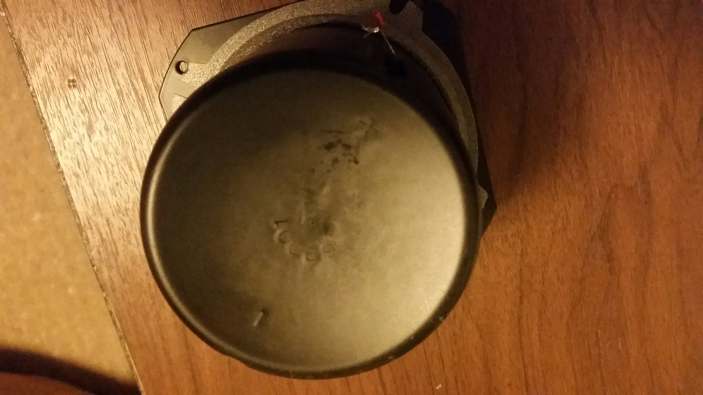

I had expected to find ultra cheap components inside but they seem of much better quality than the last few I've played with. Can anyone shed any light on them? Is the midrange refoamable? Is it worth refoaming? The tweeter has an interesting spongy area around it, most likely a diffraction aid? I can find some info on a Rotel RL850 but not an RL860?

The soft area around the tweeter is definitely for diffraction control. It looks similar to a fostex ft28d. The midrange looks a lot like an old phillips unit. Not really worth the trouble to fix.

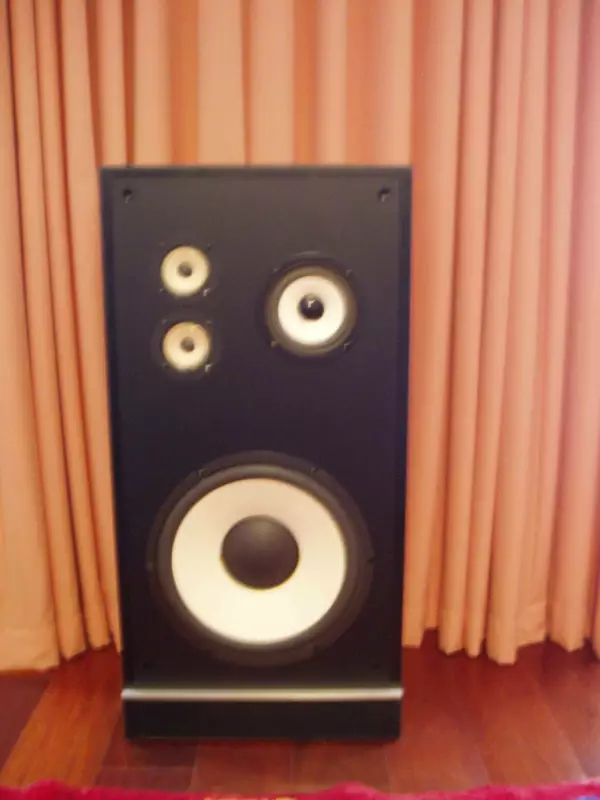

These look like your speakers, but complete with woofer!
Personally, I'd focus on the speaker cabinets alone as refoaming the existing drivers may not be worth the time and effort in terms of results.
But crucially, have you tested the drivers individually to see if they are all working?

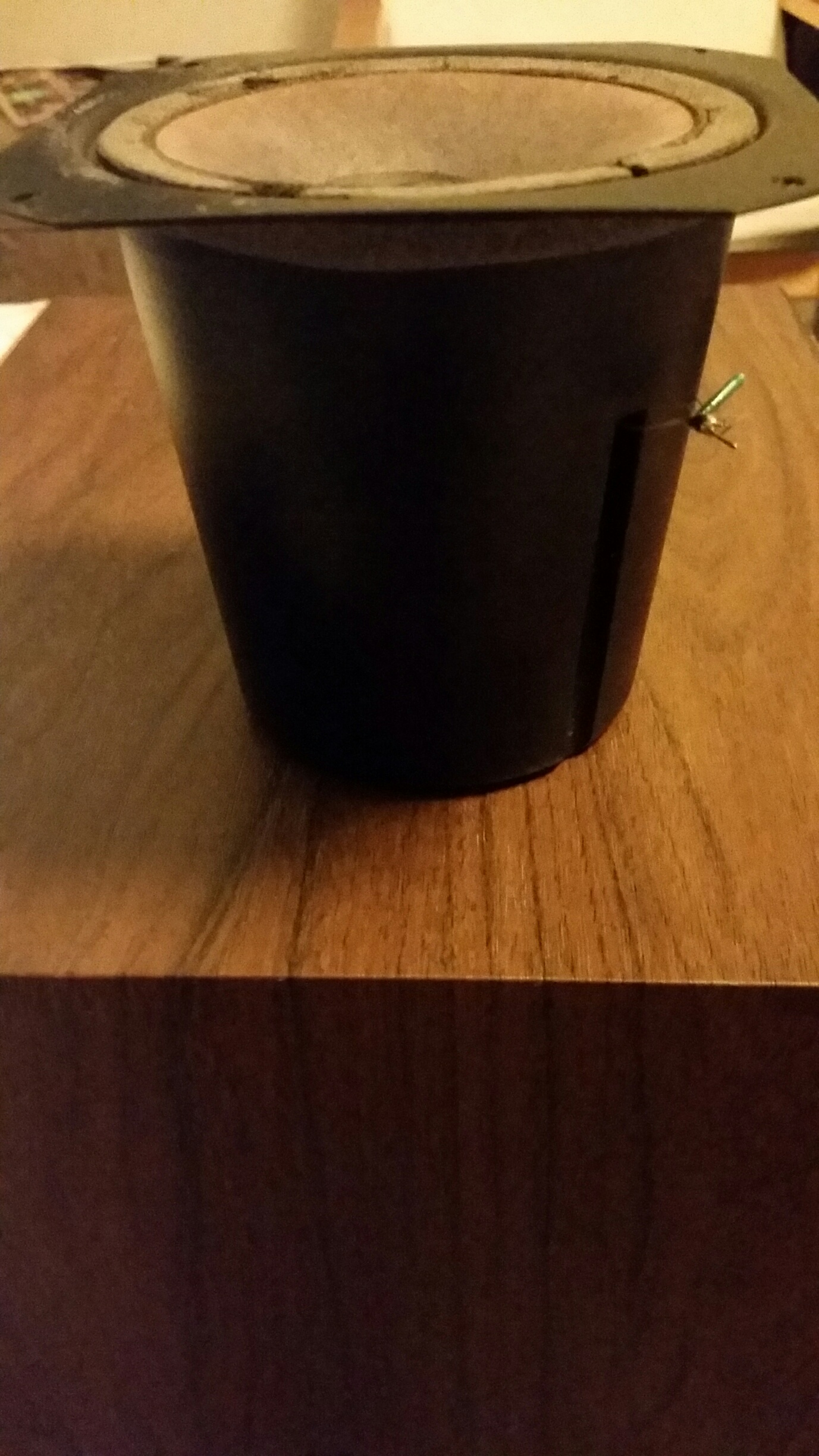

I have the same affliction with the attempted polishing of excrement - though to me old mid-fi speakers are more like an interesting bit of driftwood. Add glitter! My current time sucker is a ten inch three way with a potted 5" mid and I have determined that the plastic pot generates hash in the upper end of its range due to reflection. I fashioned a new enclosure which allows an inch of damping fluff (fiberglass) with the same internal volume and the sound opened up, a bit like what you get by turning off a fan in the room.

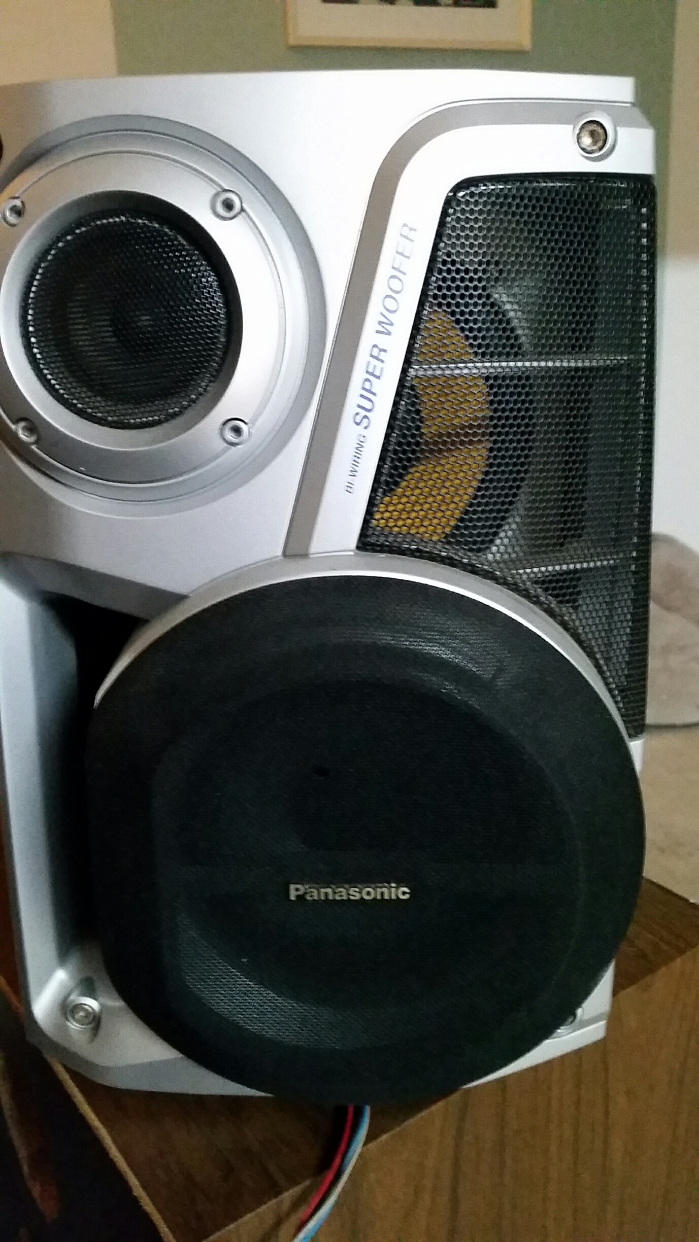

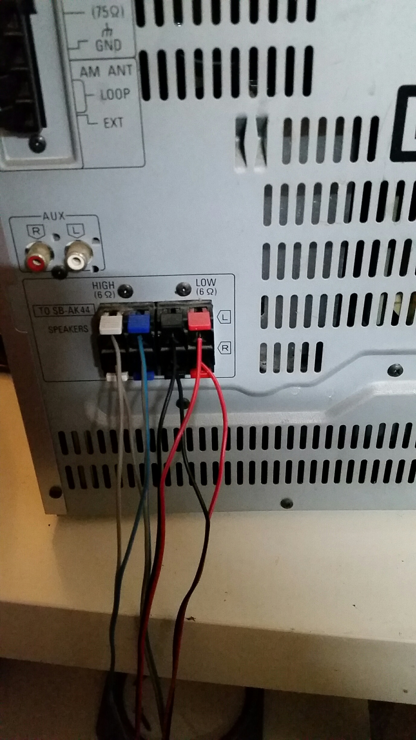

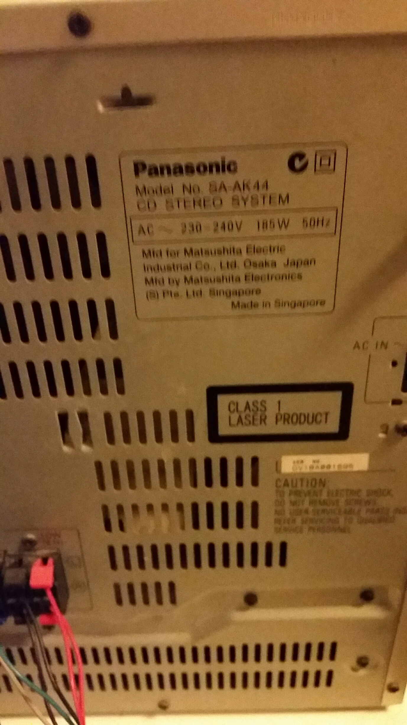

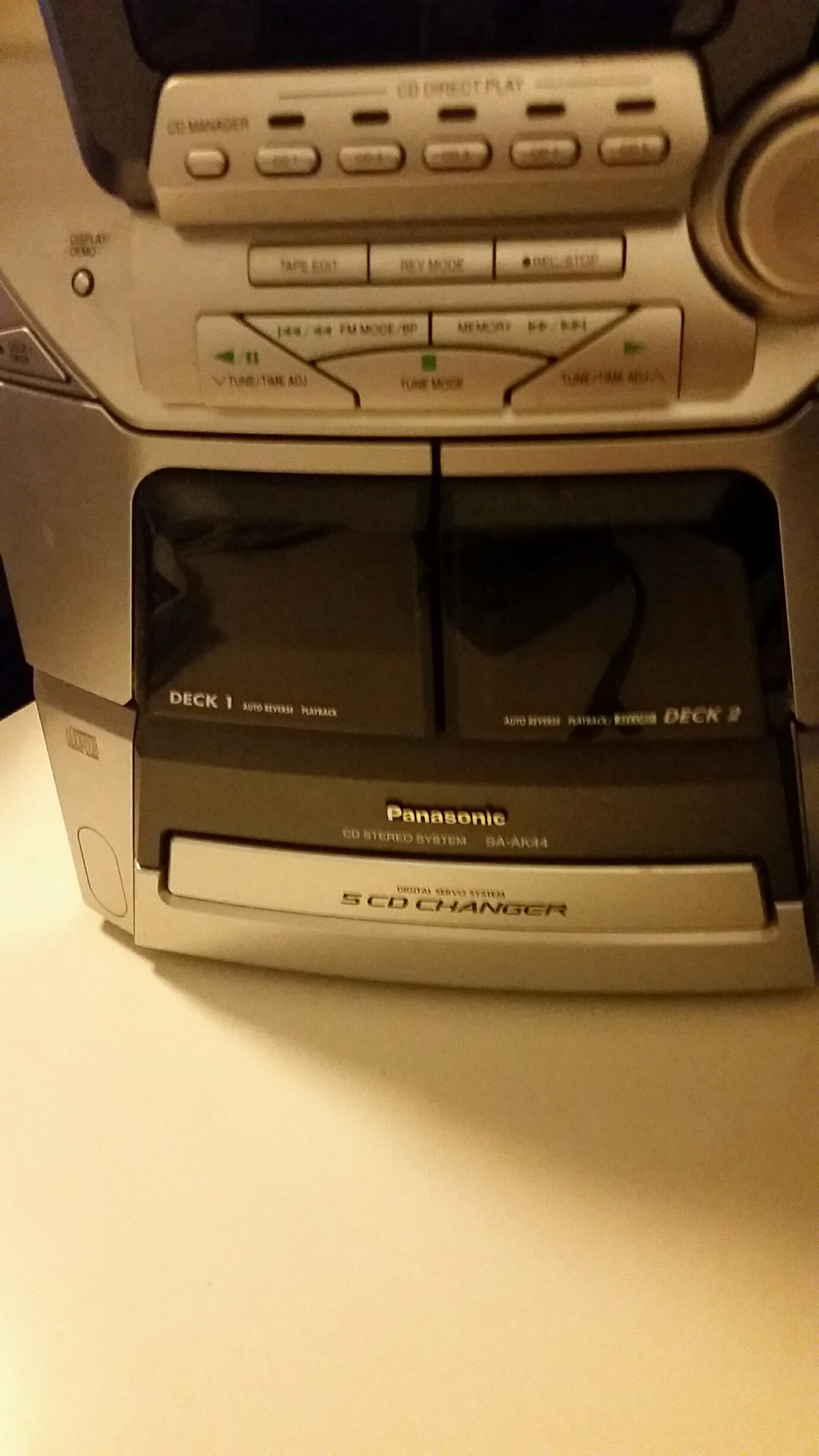

Well this is interesting.
Along with the enclosures I got a cheap stereo thrown into the bargain, the owner had said one of the speakers wasn't working and to be honest I'd barely paid them any attention until this evening.

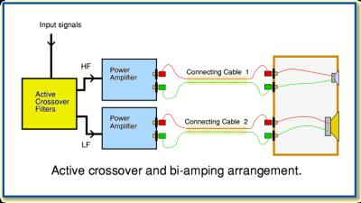

Turns out the system uses a form of biwring/active crossover or something? Sounds not bad, perfect for a noisy workshop office. Tempted to pull it apart for a closer look.
Both speakers are working, the previous owner was obviously flummoxed by the 4 wire speakers and had incorrectly set them up.
I've tested the speakers with just the lows and highs attached, they do what they say. It'll be interesting to see what kind of filtering is happening? Is it quad amped?
