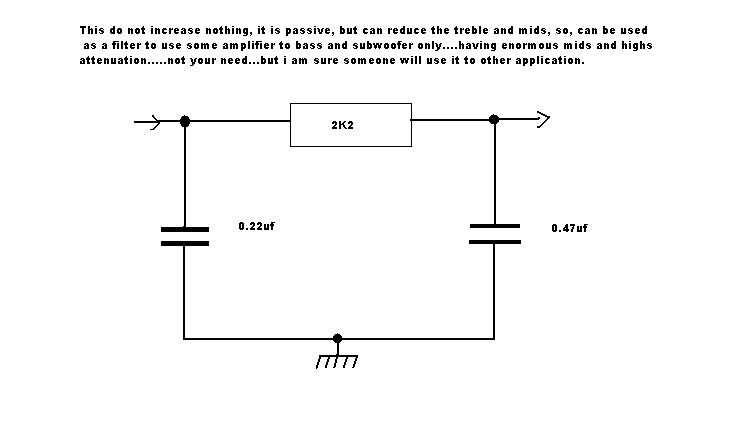

Anybody have a Bass Booster schematic?
This do not boost...just makes the opposite..attenuates the trebles and mids.
And simple and passive...not exactly what you want...but may be helpfull to someone......maybe.
regards,
Carlos

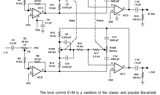

A normal tone control can be used, those Baxandall tone controls
You can fix your treble, or reduce it by 12 to 16 decibels.
And you can increase the bass also.... result will be big bass and some reasonable low mid range....you can include a small capacitor in the input "to eat!" ....to conduct to ground, the mid frequencies....but it will reduce the bass level too.... a little ...but it will do.
Of course can make filters for up and down...high pass, low pass and sophisticate the whole thing...but really...to have more bass, this is enough.
regards,
Carlos
