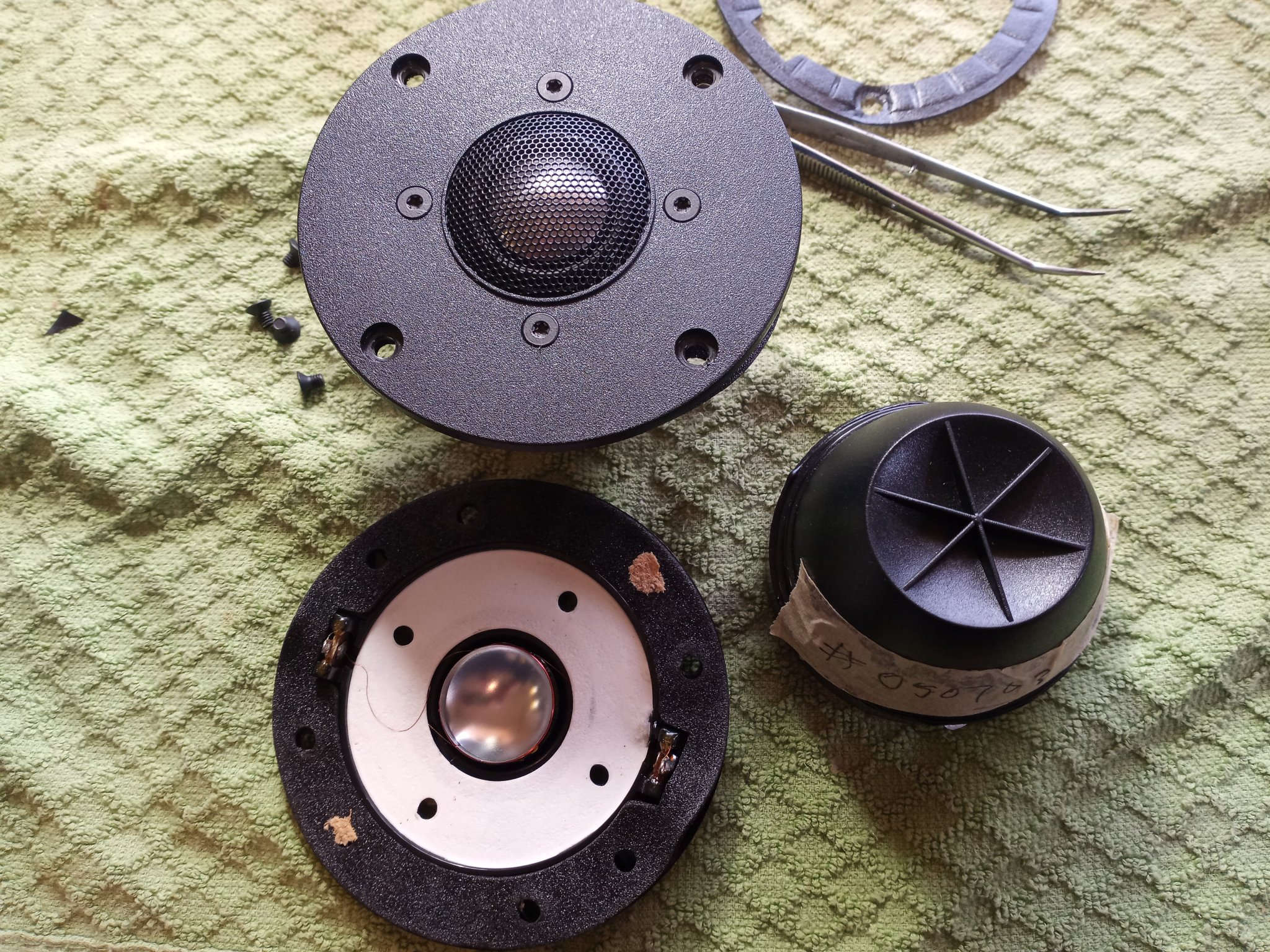

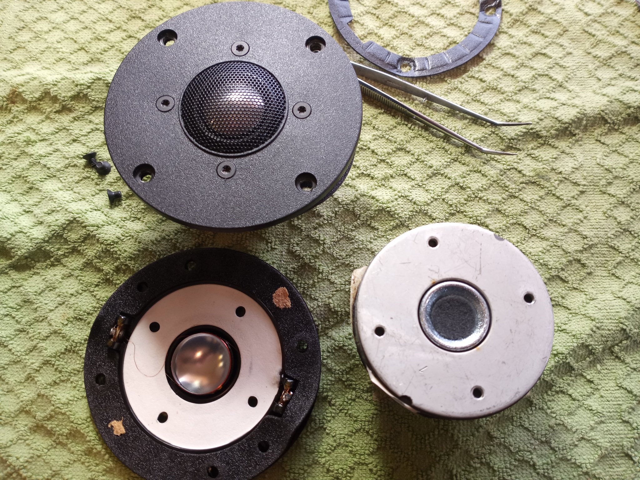

Reminds me of some LPG tweeters from the 1990s. Are there any other markings that could be used to identify it?
On second thought, the back of the magnet is not like LPG designs...

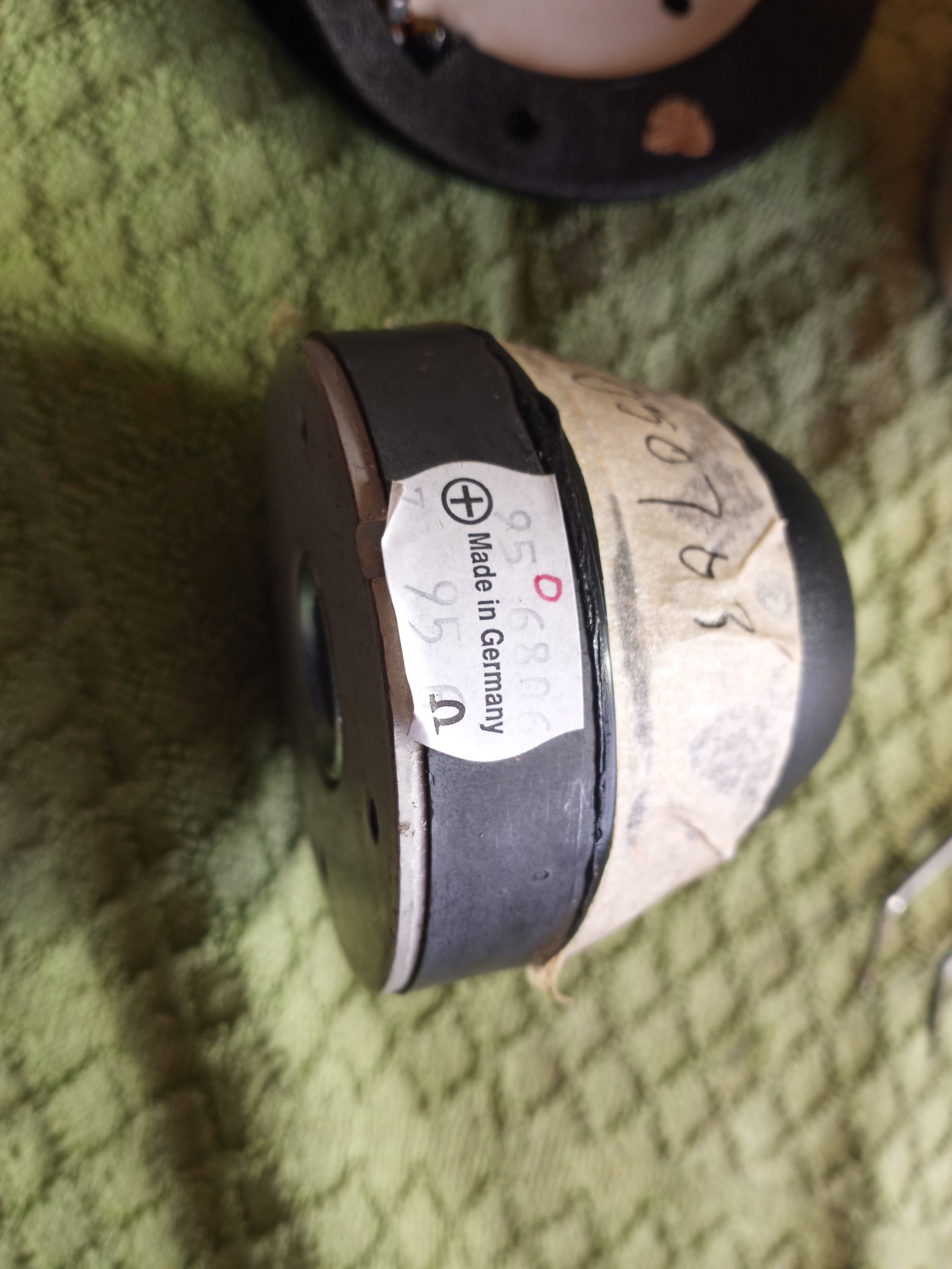

Looks very much old MB Quart tweeter, titanium dome with rubber surround. Model 95-6806.
A bit similar has been in Parts Express https://www.parts-express.com/MB-Qu...-Truncated-Faceplate-6-Ohm-279-466?quantity=1
Correct , that's the MB Quart .I found 3 of them, all shorted . Two 95-6806 and one 95-719 like the one from Parts Express which is not available anymore . Thank You Gents !

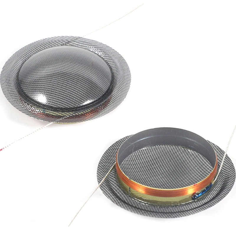

Strange they all shorted. Hard to see the voice coil, but from pictures it looks intact. One can definitely unglue VC former from the dome with xylene and replace VC+former subassembly with a new one. There is a lot of coils selling as complete replacement. Rewinding VC on original former is preferable, but requires more skill and winding contraption with the right mandrel. Speaker repair shops should have no difficulty doing this.

Depends on your aptitude (and attitude : ) towards fine mechanical work, really. 3 (well, 4) new VCs are 4 bucks, :
https://www.aliexpress.us/item/3256804367758160.html
(just discard the silk dome, xylene or razor would do)
![Sc47107060f944df0badb072eda890521d[1].jpg Sc47107060f944df0badb072eda890521d[1].jpg](https://www.diyaudio.com/community/data/attachments/1069/1069507-1211ec89ddedde6e75b743b8ed2820d1.jpg?hash=EhHsid3t3m)
No sense in fussing over cheap drivers, but OP's tweeters are nicely made: Ti dome, heavy magnet, profiled pole piece, damping surround, large damped rear volume. Modern comparable tweeters are about $50/ea. Repaired, they should sound and measure fine.
