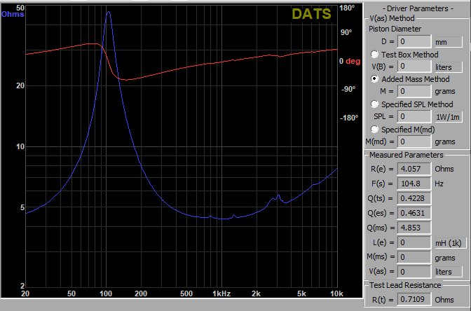

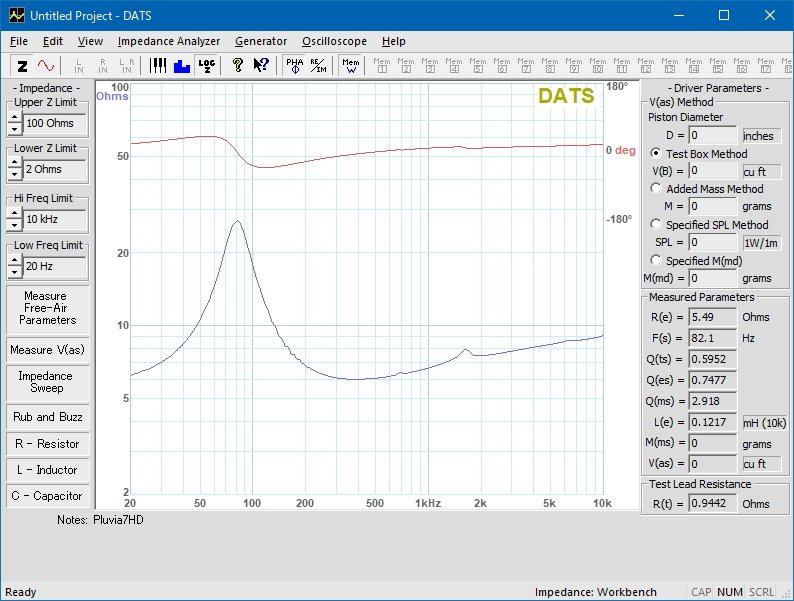

Just bought a pair of 4FE42s because of their supreme specs and sensitivity, but I was a little disappointed with the impedance measurement:
As you can see, it's full of resonances in the 180-300Hz region, and another at 1.3kHz and 3.5kHz.
Both drivers measured similarly.
Is there anything I could try to do with the driver to reduce these?
Resonances in the 180-300 Hz are sure sign that you are doing something wrong during measurement (as other members pointed out).As you can see, it's full of resonances in the 180-300Hz region, and another at 1.3kHz and 3.5kHz.
Resonances at 1.3 and 3.5 kHz may be real, because there are some disturbances in the measured frequency response close to those frequencies:
The most reliable method for measuring resonances is "waterfall diagram".

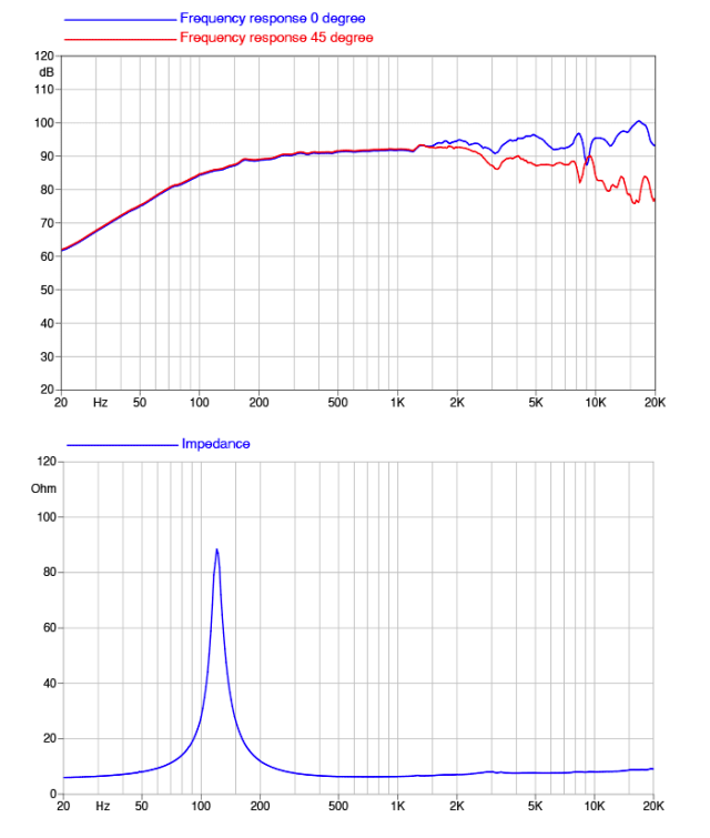

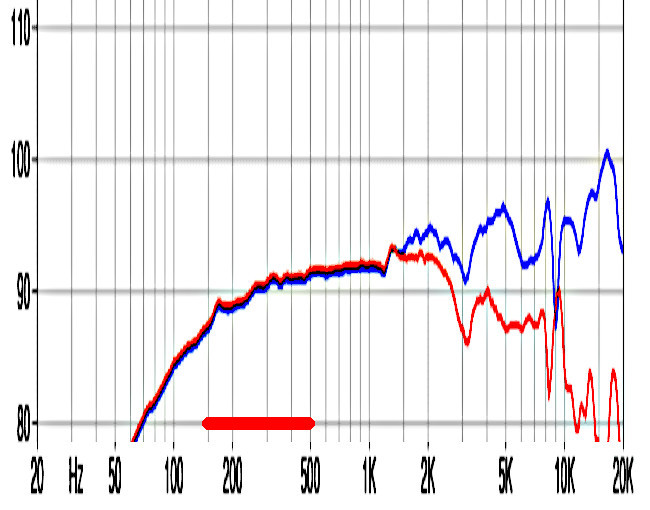

The resonance is most likely not a measurement error, it shows up in the datasheet too, but it seems small because the datasheet has a linear scale whereas your measurement has a logarithmic scale. It would be interesting to see the impulse response and CSD.

Did you suspend these neutrally when you measured them.. were they in a box?
I tried many ways. I measured it both held on a rigid surface, on a soft surface and just held in my hand.
They were a tiny bit different but this one was measured in the hand and was the best one.

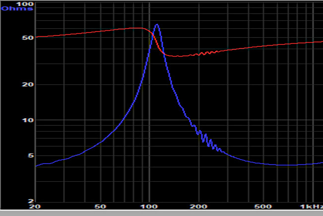

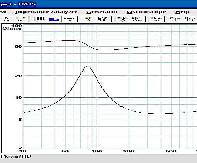

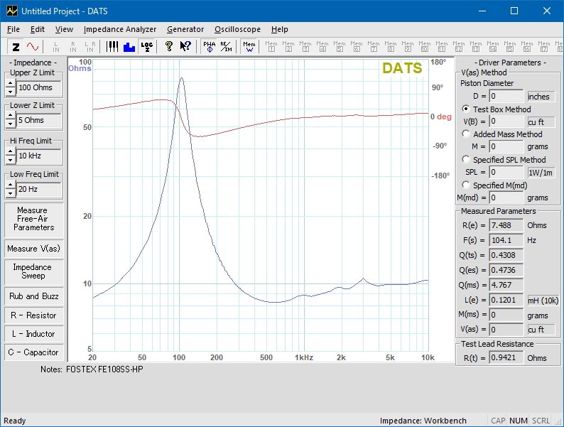

I did also recalibrate the DATS with 1k and the leads and I measured a Faitalpro 3FE32 and it looks fine:

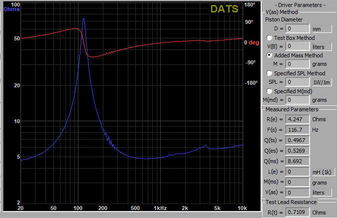

Here's the other 4FE42:

What lower resonances? I don't see anything below 1.3KHz. The thing at 170Hz is unlikely to be remotely related to the driver. The ripples at 200Hz in the first measurement are likely a result of mains hum.
1.3KHz coincides with the directivity breakpoint, it can possibly be compensated with a notch filter because the directivity is still low. 3KHz is very difficult because in order to boost that frequency you would have to dip the impedance by just as much, and the effect of an impedance dip on EPDR is disproportionate. Furthermore if you boost that dip you may also boost ringing that follows it in the spectral decay. So cone treatment is really the ideal solution here, and the results I posted earlier show that the resonance was resolved, which makes it unlikely to be a basket resonance as cone treatment does not affect the basket at all.
Very unlikely that a basket has such a low resonance (200-300 Hz).I just realized it is a stamped steel basket
Also the several similar peaks seem to indicate a measurement issue/artefact rather than a (single) resonance.

Agreed, not a single resonance. But disagreed about the measurement artefacts hypothesis: Three independent measuremets posted in this thread suggest that there might a real problem for this driver in the range between 150Hz ... 500Hz. Because all of these three measurements show the same kind of jaggies all over this frequency range.
First, and maybe most relevant because it's from Faital itself - The FR measurement from the official Faital Datasheet. Here, it's stretched vertically by a factor of 4 in orrder to to better show all these tiny jaggies in the curve between 150Hz and 500Hz. Compare this uneven section with the relatively smooth one between 500Hz and 1kHz:
2nd: the well known, the initial impedance measurement of this thread. Graph here is stretched horizontally by a factor of 2 for better visibility ... jaggies between 150Hz and 300Hz, this time:
3rd: Last, not least, also the 2nd Impedance of nandappe show the same kind of jaggies. Graph is stretched horizontally by a factor of 2 for better visibility ... this time jaggies between 130Hz and 220Hz:

I have 3FE25 laying around somewhere.
Can tap on the basket and the cone to see what approx. it may be. But not today and will measure with phone probably, as cannot set up proper measurement mic or impedance measurement ATM. From the manufacturer graph, there are also some wiggles at 1-2kHz and 3+kHz, but not on low freq. Maybe smth related.
