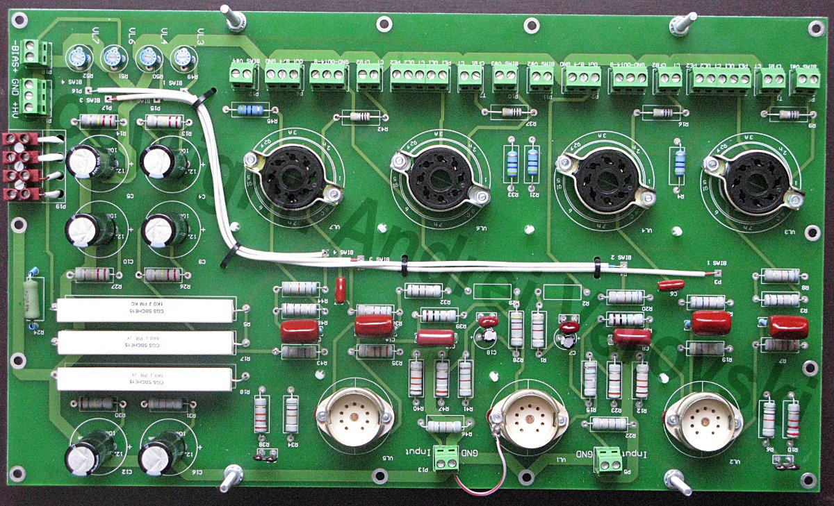

Hi guys,
I'm more of a valve guitar amplifier building kind of guy, although I'm more technical than a musician, however I'm working on my first PCB build and I know PCBs are a lot more popular with audiophiles than guitar amp builders. I was hoping to get some advice from the community here about how best to route my heaters on my PCB so as to best avoid coupling hum into the other components.
I have 5 preamp valves to go into a PCB, at 12V ac, 150mA each, 750mA total. I know that's quite a lot compared to many HiFi amps, meaning I can't run them all on DC, the high current means stronger magnetic fields, and the gain is higher than in HiFi, so the situation is far from ideal.
So far, what I've considered is having the 2 tracks running parallel to each other either side of the PCB to keep them close (the drawback being that they would obstruct both sides of the board, so I couldn't run any signal wire across it) or having them next to each other on the same side of the PCB; and surrounding the whole thing with a ground trace to shield the rest of the PCB, grounded separately to the signal (the drawback of this being that it takes lots of space on an already tight PCB); or just wiring them up with a twisted pair of wires held away from the PCB somehow and coming vertically down to the valve sockets.
How do you guys normally do this, or do you just get away with a simple solution because of your generally smaller currents and lower gain?

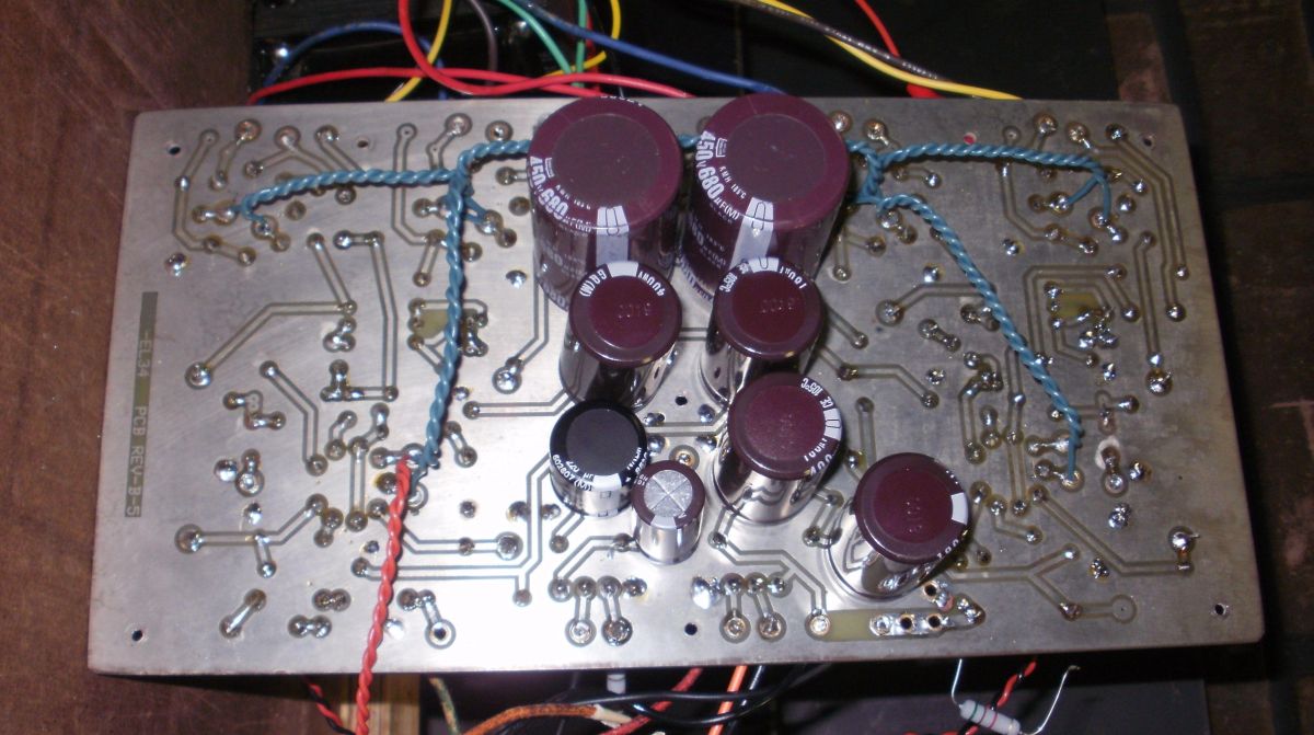

I would use twisted wire, and make sure it doesn't run parallel to any PCB signal traces for any appreciable distance. Roughly, the spacing from the PCB should be no smaller than the twist length.
I lifted the PCB above the socket slightly and added a ground plane between the twisted filament wires and the PCB. That is probably overkill, but it works.

The way to go is to make pairs of holes in the PCB very close to each tube socket. Then use jumpers made of twisted pairs of solid wires to jumper the AC current. You'd raise the twisted pair off the plane of the PCB as far as you can. At least 1/2 inch.
I don't think any PCB layout can out perform jumper wires unless you go "exotic" with six layer PCB designs and interleave the heater traces so they are stacked. Stacked traces can be even closer together than twisted wires.
What matters is (1) the core to core separation, for a twisted pair that is twice the insulation thickness and (2) the distance between the pair and the signal trace.

As far as PCB layout goes: Keep the heater traces fairly wide (40 mil or so) and as close together as reasonably possible (10~12 mil spacing) on the same layer. This minimizes the loop area formed by the heater traces (the loop being the loop the heater current follows). Minimizing the loop area minimizes the inductance of the loop, hence, minimizes any inductive coupling between the heater loop and everything else.
Same goes for the signals. Route signal forward and return as close together as possible. Again to minimize the loop area, hence, inductance. The mutual inductance between the heater loop and signal loop will cause coupling between the two. That's why it's important to minimize the inductance.
