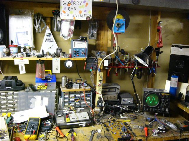

Does anyone here in the group have any suggestions about setting up a dedicated work area for electronics repair/rebuilding?
(or guide me to the discussion if it exists on this site) I'm in a position at this point where I have to re-arrange portions of my basement, and now is as good a time as any to set up a work area. I figure an intelligent layout will make things much more enjoyable. I'm already planning to incorporate comfort and safety items ( think GOOD lighting, non conductive [wood] work desk, rubber mat for the floor and an isolation transformer. Any suggestions on layout ? Let me know.
I've also acquired several pieces of test equipment over the past 10 years. What stuff typically gets used the most on the bench? What's essential to have for working on tube equipment?
Again, looking for input from you folks who have been down this road way ahead of me.....

First off it's gotta be comfortable. Lets face it - you're going to spend a lot of time here.😎
I prefer to stand at the bench to work so a higher surface level means a tall chair.
A high impedance mat with ground connection is highly recommended to prevent ESD especially if you have one of those "VanDeGraff" floor mats! Connect it to mains ground or 6ft+ of buried copper pipe. Much better than metal suface (shorts batteries) or insulating surface (kills CMOS)
Get a variac especially if you're working on tubes. A 1KW is great but Vexpensive, Vlarge😱
Other than that, PSU, meters and scope should take front stage. Rack up the analyzers and specialized gear for occasional use.
Get yourself a good soundcard (Prosonus Firebox will be my next one, EMU1616 was my last) and get VisualAnalyser for free and Adobe Audition if you can afford it. These coupled with MATLAB actually make everything other than the DMM obsolete (but I do like my old 465 glowing in the dark)
Don't forget a good amp and a heavy duty pair of speakers, something that'll take some kicking without degrading
My big omission someplace to keep all the &@*?!!#@* cables and a big bucket for adapters. Oh and all the wall warts.........click...brrrrrr

I am in no way "experienced", but since I am also reorganizing my basement, to move diy there from the kitchen table, I'll keep an eye on this thread.
One of my targets is to have some ventilation that takes out the soldering fumes (I love that smell, but it must be really nasty...)
And if you have enough space, of course make a "dirty" area where you drill or saw PCBs, pull components from muddy videos from the dump, or that sort of stuff, separate from the "clean" workbench.

Thanks for the suggestions thusfar. To clarify a bit more, I'm pretty much a newbie to repair/rebuilding. So even though I have a lot of equipment, I first have to determine: a) what I need to use b) determine if it's in working order, c) actually learn how to use it.
I'll primarily be working on tube equipment so I'm not sure, is ESD an issue with that, or only the Solid State equipment?
Iain, point taken about comfortable working height. I guess a high bench would allow standing or sitting with a tall stool, and I have one of those (nice padded one at that) I do have a few variacs, even a large 20 amp unit. And amplifier/speakers will be no problem. Unfortunately I don't yet know how to use a scope. As far as I know I have an old Eico sitting around here. It's a reasonable size. OTOH, I have no less than three 545 Tektronix scopes, one even has a cart. But they're real estate hogs, and I'm not sure if they're a good choice in this day and age.
2pist / Nanook. Not to worry, my aim is to get organized, and stay out of the kitchen. Lucky for me I've got the space (finally) to set up an area.
Pilli, that's a good point about a dirty area. Saw, grinder, vise, drill press, etc. Keep all the mess contained. I'll try very hard to see if I can carve out that little area. And for the clean/assembly area, I'm already working on a soldering iron holder/shielded muffin fan to remove those toxic soldering fumes. If I want to get real elaborate I can even vent the stuff to the outside. We'll see.
Having EXCELLENT lighting is a given. I even managed to scrounge up a light/magnifier unit.... a nice one. For those of you not familiar with them, Optovisors are awesome too.

Decide how many power sockets you need, and then double it and add a few more. Better too many than too few.

Probably the best bench arrangement is the one found in most professional labs, with 2 levels. A regular tabletop with a half width shelf for instruments about 2 feet higher. The shelf needs a gap to drop leads down if it butts against a wall or is double width. Double width with access from both sides is better. You probably need room for a monitor and keyboard, which can clash with the shelf.
The tabletop is usually high enough to stand at, or sit at using a stool. There may be drawers, but you also need to be able to get your knees underneath. Some lighting under the shelf helps if the reflector throws the light in the right direction.
The entire width of the table should be provided with sockets, including any specialist ones such as telephone, Ethernet, radio antennas and what-have-you. No matter, you always end up looking for a 4-way extender. A venting arrangement for solder fumes is desirable, you can have a vacuum tube on your iron.
Build it strong. Steel is good, where ya gonna ground your ESD strap? BTW, where is ground? And where is your power coming from?
Provide a single point of turn-off with an overcurrent breaker and RCD.

Panomaniac and Wakibaki. Thanks for your comments.
I only mentioned the other 200 amp panel, as that's whats providing me with all the extra open slots for additional breakers. I now have more open slots than I could ever use. AND the panels are close to the area I'm going to set up so wiring should be a breeze.
I like the idea of a master shutoff with indicator light.
Regarding the 2 level "professional" setup, I agree with that. By "double width" did you mean two of these workbenches sitting back to back? If so that would be awesome, I'll have to check the amount of available room I have.
Proposed lighting will have some fluorescents at ceiling level above and just slightly behind my head ( to keep from glaring in my eyes) In addition to that, I'll have some incandescent (or halogen) lights mounted at ceiling level from the right and left side, and slightly behind me. Two types of lighting from three different angles. Plus I've got a real nice circline bulb desk lamp with glass magnifier in the middle for real tight tolerance work.
I can't imagine making the desk out of steel. I am trying to stick with all non-conductive surfaces, wood, laminate, etc. as the tube stuff has high voltages involved. If I need a ground it's certainly nearby. I'll only be a few feet from the large copper wires that feed into the power panels from the grounding rods outside.

Steel frame. We have some purpose made, some from industrial perforated angle-iron which is easy to work and bolt together.

You mention isolation transformers. A lot depends on the work you intend to do. Many TV chassis's and SMPSU's for example are at "half mains potential". If you intend working seriously on stuff like this you need to go down the fully isolated workbench approach. This allows you to clip scope leads for example to a "live" chassis and still be able to touch a soldering iron on the circuit without an almighty bang. Aerials need AC isolators ( the downlead will be grounded ) and there must be no eathed metal items within reach.
In other words an earth free zone -- no earthed test equipment etc.
This is how many service centers are set up, what a job convincing "Healt and Safety" that the earths are meant to be lifted 😉
If you are at all unsure DONT DO IT.
