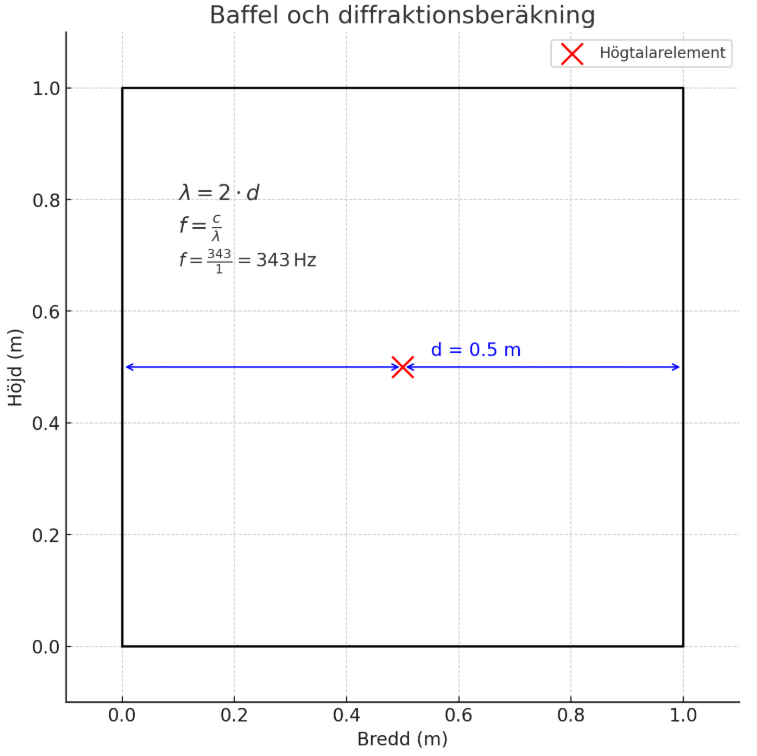

LeifB60 Member Joined 2015 2025-02-27 10:59 am #1 2025-02-27 10:59 am #1 Were can I find a software who can calculate Open baffle? E esl 63 Member Joined 2010 2025-03-05 9:46 pm #2 2025-03-05 9:46 pm #2 The frequency will fall with 6dB / oct from the point where the sound from the speaker front to the rear is cancelling approx 343 hz concidering 50cm from speaker to the edge of the baffle. Reactions: LeifB60 You must log in or register to reply here.
