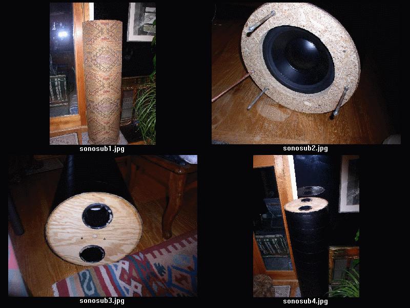

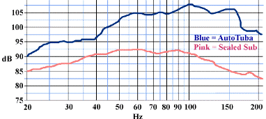

MCM has a dandy little 8" driver that goes VERY nicely into one of Bill Fitzmaurice's tiny horns...
Bogie said:MCM has a dandy little 8" driver that goes VERY nicely into one of Bill Fitzmaurice's tiny horns...
Horn? what does a horn have to do with this thread?
This is about SUB-WOOFERS... not honky-horny thingies...
looks like a mis-post to me
Bogie said:
been there...this is nothing amazing... lotsa hype... didn't like the horn sound... I've built horns way back when... lots of efficient output, not such good low end quality... great if you're into that sort of thing... not for me...
no hoof in mouth disease here... maybe at your end?

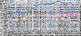

Sorry bogie, I gotta agree with auplatter on this. The auto tuba rolls off at about 8.5dB/oct from 80hz down to 20hz in cab, so in a large room that thing will be a very loud woofer with no low end. notice how flat that sealed sub is, the sensitivity might be lower but with the power handling of todays drivers flat response wins.
