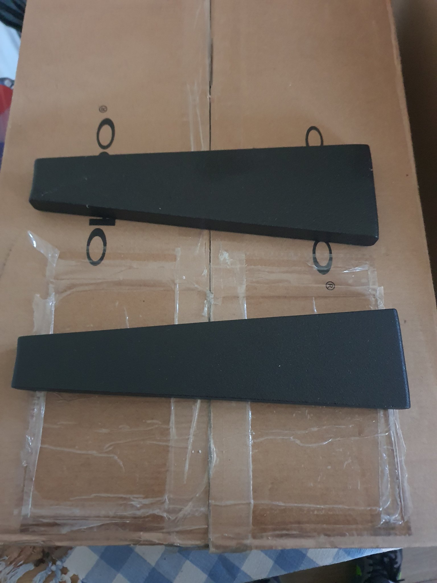

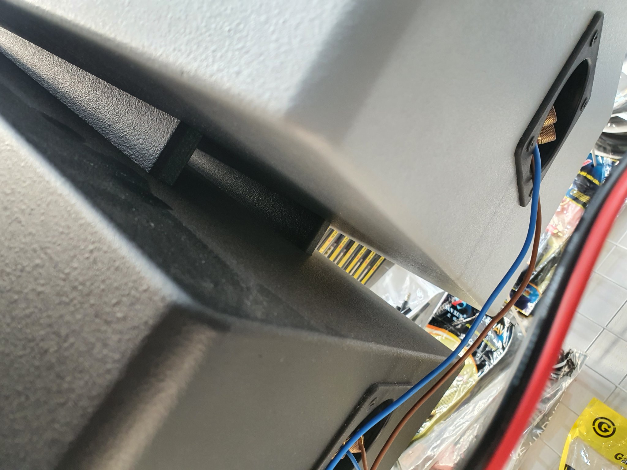

Here's how I designed the angle correction for individual volumes.
These are pads that are placed between the volumes in specially carved rails.

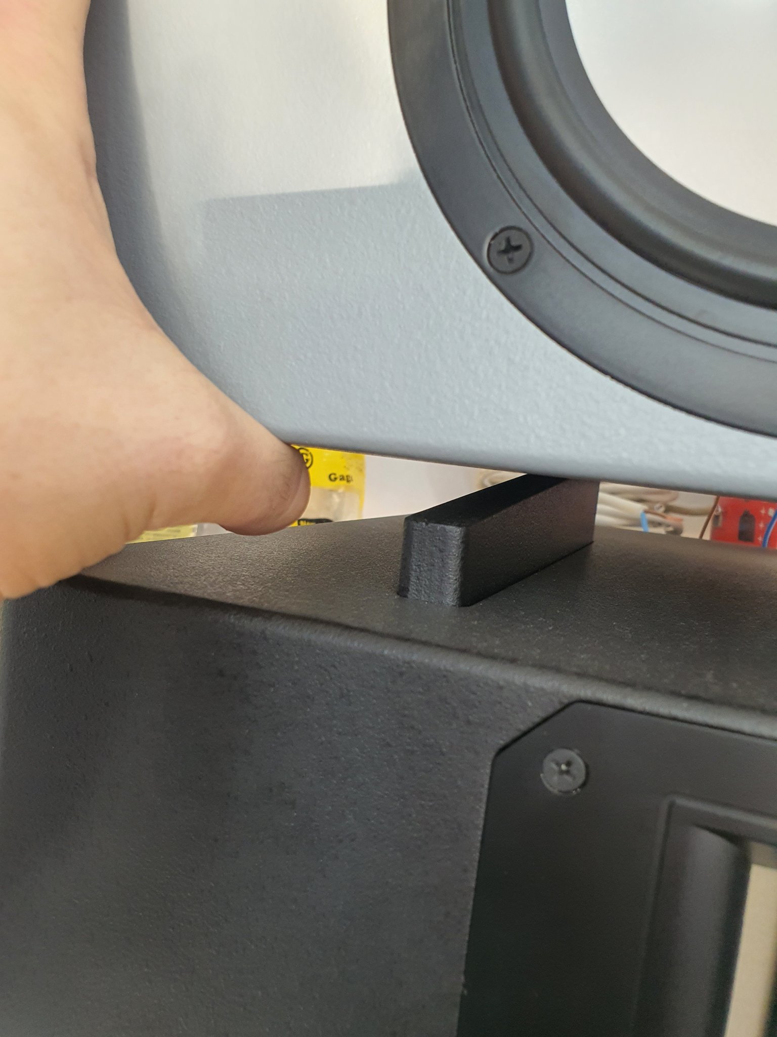

In the following photos, I lifted the box by hand to see how the connectors fit into both volumes.
Each volume has a set of 3 different angle pads, the fourth is flat. The draws keep the speakers fully upright.
This is how I designed them so that they can be adjusted for different rooms and different listening places.

That's pretty much how I did mine, but I didn't think of including slots for the 'wedges', I just screwed them in as the boxes were only intended to be proof of concept. Your solution is more elegant and if I rebuild the next lot in a similar fashion, I'll use your idea.
I had the 15" enclosure angled back maybe 7*, the 10" vertical and the 1+WG about the same as the 15. I don't recall the exact numbers, I just did it with a tape measure, the HP48G and some trig.

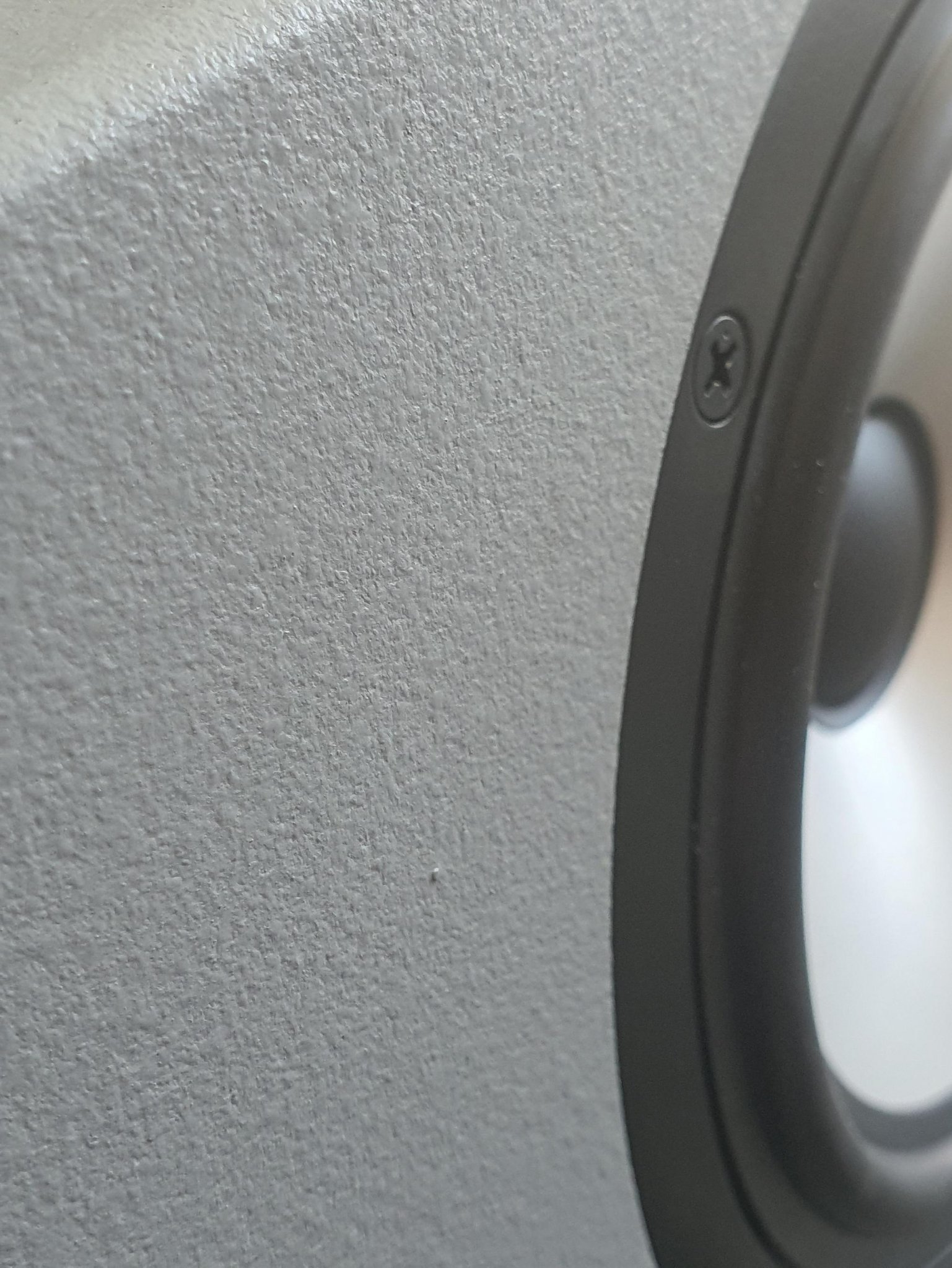

Because the boxes and the finish of my boxes were made by some guys who specialize in the activity, I quote his words from another forum about my speakers.
In this case we use 3 coats transparent two-component polyurethane primer, then 4-5 coats two-component polyurethane paint.
Great embossed coating is obtained.
In this close-up photo, I tried to tell him.
I'd like to ask more about the paint, too. I have used two component polyurethane paint but it does not have that rough (nice) texture, even when I choose 100% matt finish. Can you kindly ask the painter how they make that texture?
FWIW I've actually been choosing two component water based paint recently. I had no idea such a thing existed but it's awesome! Finish quality of solvent but no smell and easy clean-up. Only downside it's still slower to flash dry than solvent based.
Also, I like your choice of birch plywood, not only does it sound better but it's also less dusty when cutting it. OTHO needs more primer and filler than MDF for a smooth finish. Your painter wishes you choose MDF, haha.
Well, as I said, I used the services of professionals, and I can't know the details about the painting. Even if I ask him, I don't know if I will be able to recreate what he said.
