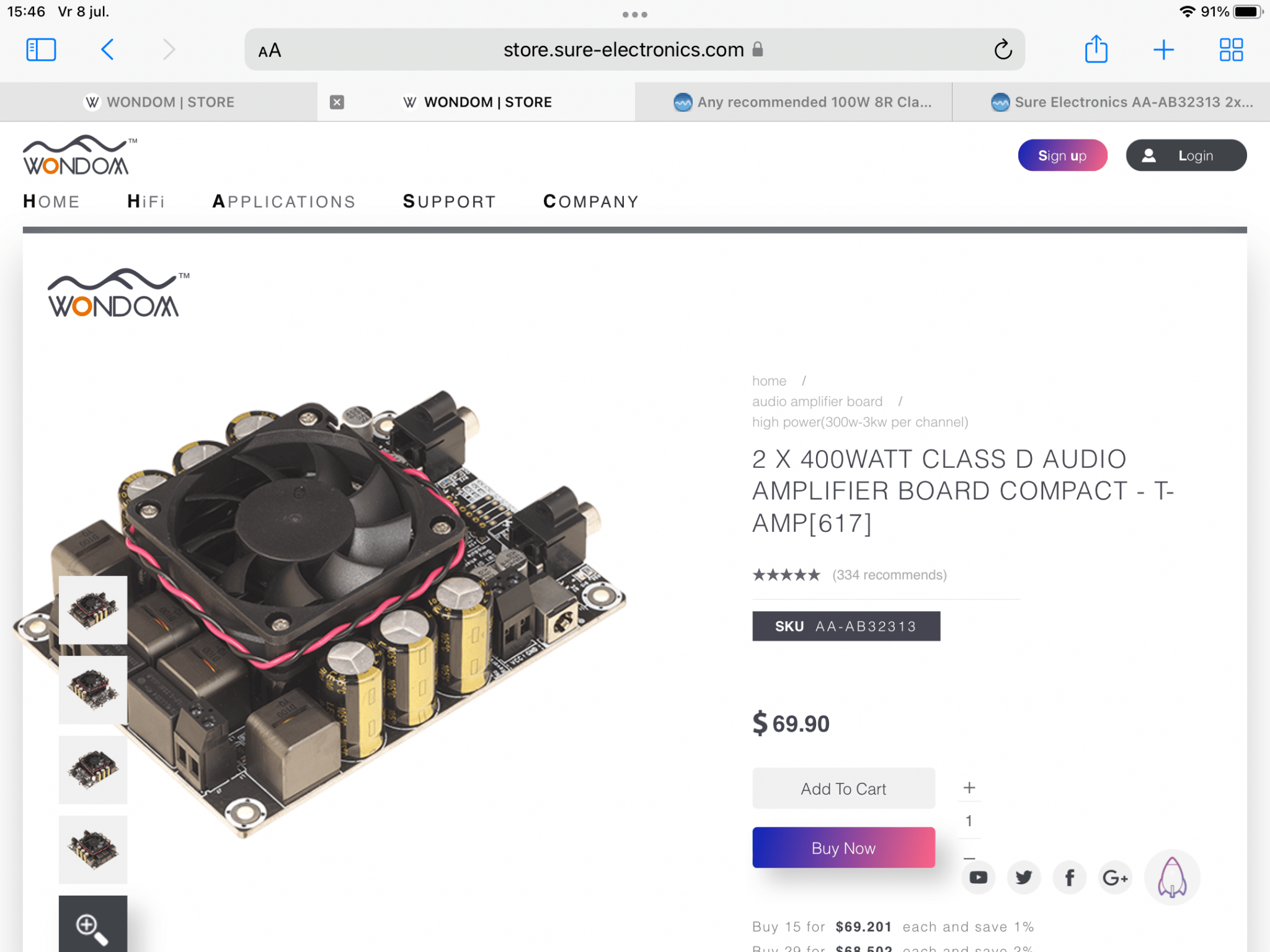

$150-200 with PS and power regulator. I wanted to buy some LLC power supply and make some aditional 5-10A voltage regulator by myself. I have no idea what PS to buy too.Budget?
This one https://store.sure-electronics.com/product/AA-AB32313 has a lot of followers.
His nickname is kremlin.
Also here a big thread.
https://www.diyaudio.com/community/threads/sure-electronics-aa-ab32313-2x400.298796/
I use one for my subwoofer with toroid linear supply.
From the outside it is moderately handsome 🙂
