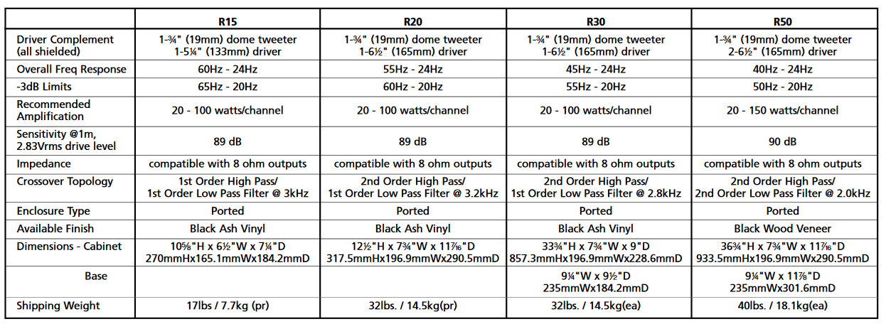

One 3/4" (19mm) dome tweeter, Two 6 1/2" (165mm) driver
Sensitivity @1m, 2.83Vrms drive level: 90 dB
Crossover Topology 2nd Order High Pass 2nd Order Low Pass Filter @2.0kHz

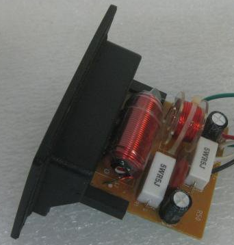

The capacitors I replaced with film caps were 5.8uF and 12uF.

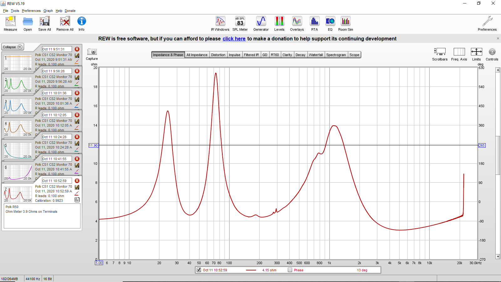

I have attached the specifications from Polk, a photo of the crossover and the impedance curve I measured with REW. Polk says "compatible with 8 Ohms" but they are most definitely 4 Ohms. The two 6 1/2" drivers are 2 Ohms each and are connected in series.
