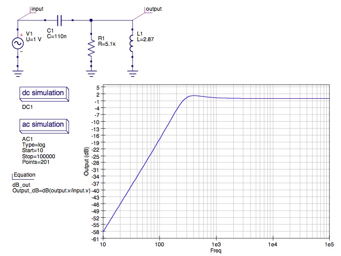

dB solved with example
I did find a tutorial that helped to figure out the dB display. This software is quite powerful and as is often the case that makes it a bit hard to get the hang of it. It turns out that the software has an equation calculating facility that adds your equations to the data set. Then you just graph the results of your equation instead of the raw data.
Here is an example of and LC High pass filter.
Note the equation defined at the bottom left uses the built in voltage dB function.
They also claim the ability to import many (most?) spice subcircuits so I suspect that the ability to simulate vacuum tubes most likely lies in that direction.
Another neat feature is that Qucs includes some interesting tools like filter synthesis.
