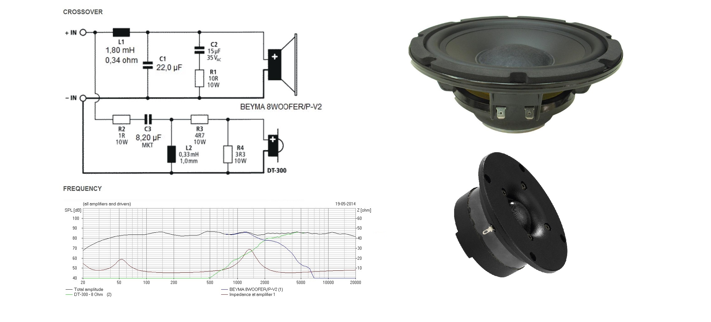

Forget about the Beyma 8BR40/N for now. It will require large volume enclosures.
Beyma 8WOOFER/P-V2, use this woofer in a 50L@30Hz. A reflex might be a good use of this driver for your application.
Beyma 8WOOFER/P-V2 reference sensitivity: 88.8 dB/2.83V/m
Port: 9.4cm x 39cm
Use this crossover as your starting point for your 2-Way with Monacor DT-300 tweeter.
Use one type of variable attenuators in place of R3/R4 for calibration of the tweeter output.

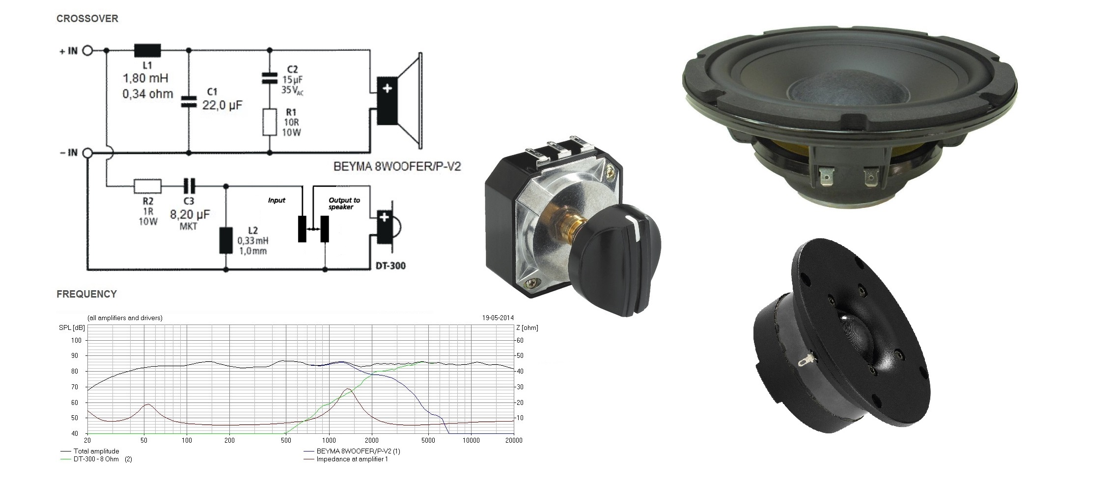

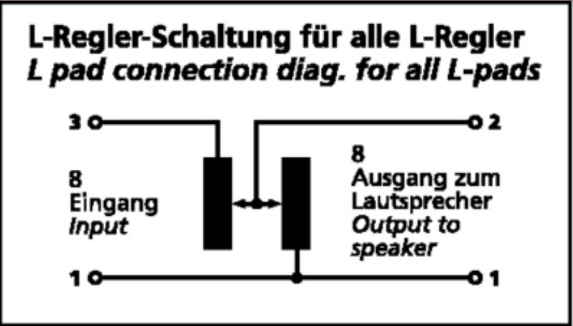

A pair of L-pads are a good choice for a start; I wonder which kind of power rating I may choose, if 10 or 20 W 😕
Or maybe a set of 0,5-5 Ω resistors

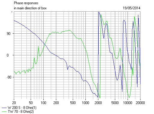

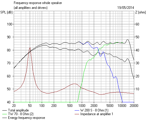

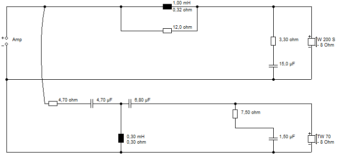

I ran his filter up the flagpole for interest. I used a more conventional tweeter filter. It pushes the tweeter I used here very hard, but I like his idea of a low BSC coil with a 12R bypass. It's valve friendly.

2-way crossover for Beyma 8WOOFER/P-V2 + Monacor DT-300
L1 is a 14 AWG 1,6 mm 0,34 ohm DCR.
C1=22uF
C3=8.20uF
R4=3R3
You can use R3/R4 for padding the tweeter or use the variable attenuator instead. 😀
Check the new components values.Looking good, thanks!!!
