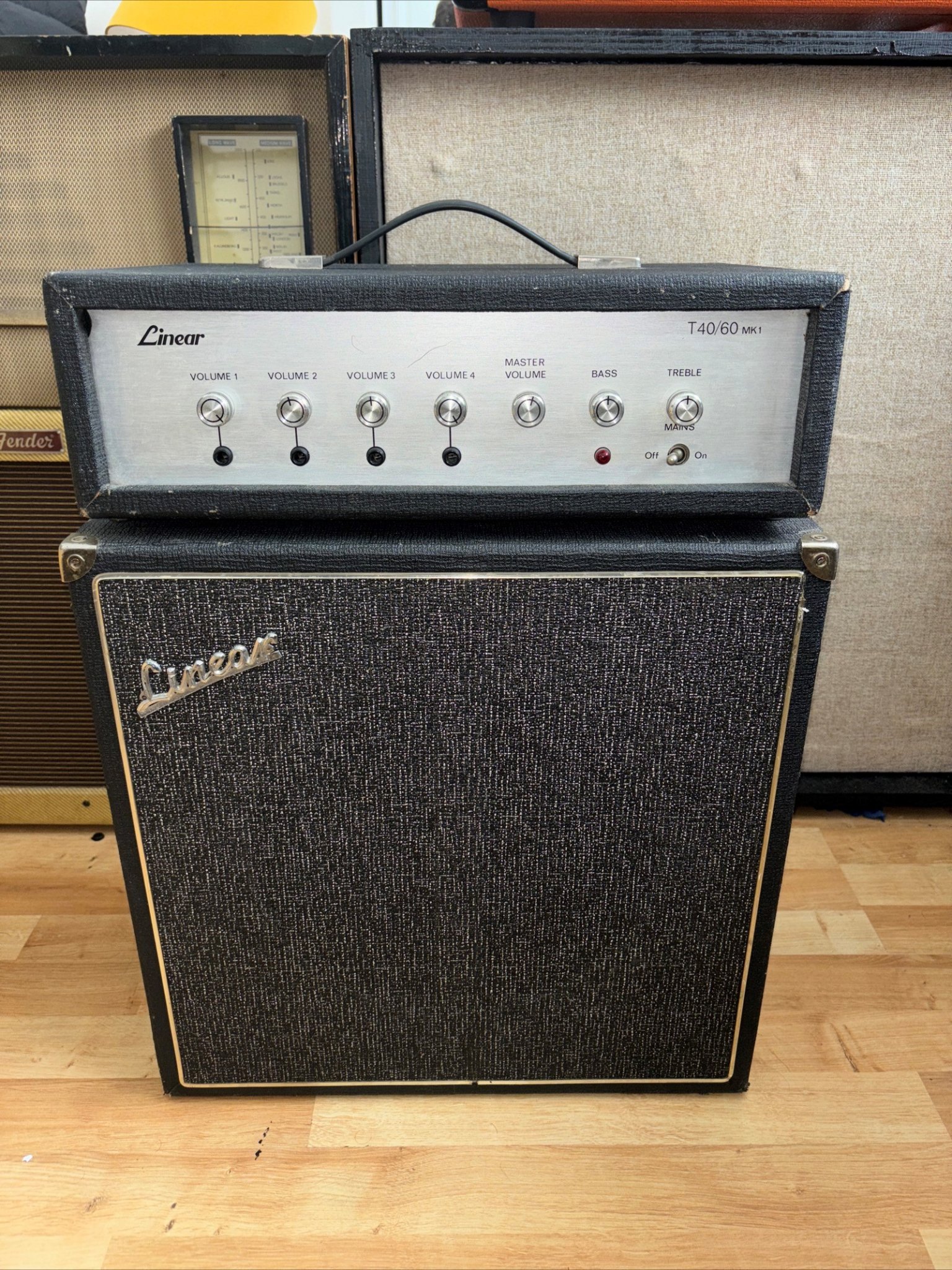

Any info on Vintage 1970s Linear T40/60 MK1 Amplifier?
In the 1970s, everybody and his dog was building guitar amps (tho this is a voice-mike amp). They now seem "unique" or "rare" because a lot of them were crap.
...I am not even sure if it is a tube amp or transistor p.a....
Look at the bottles. (Yeah the text too but I never trust the seller.)

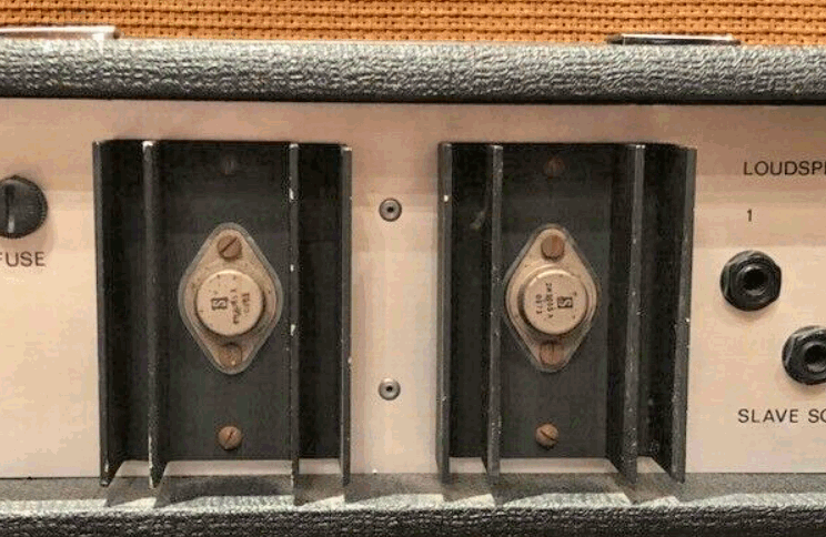

So true. Very clearly transistors (2n3055)
Also looking at the construction of this one, particle board and just an unknown circuitry + probably bunch of parts you have to replace.

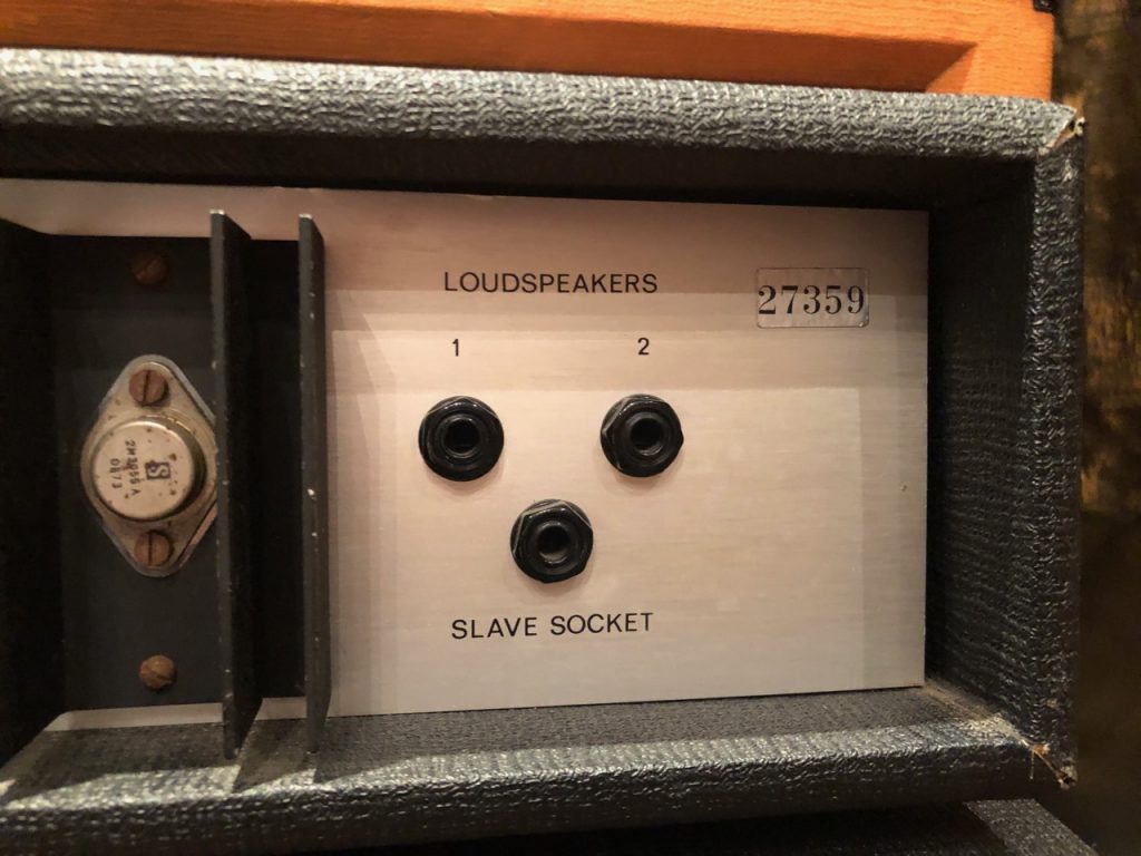

Yeah, I opened up the amp, and looked inside. This is a beautifully made classic transistor amp. The power supply is beefy, and the capacitors are massive. It has the classic audio transistors on board, which are clean and tidy design.
The sound is awesome. Crystal clear, and yet rich and huge rich sound.
I don't have user manual for this amp. I don't know what "Slave Socket" is for at the back of the amp just below Speaker 1 and 2 socket.
And also on the front of the amp, there are 4x different volumes next to the master volume. And under the each volume control knob, there is a socket which looks like headphone sockets. What are each of the volumes , and the sockets just below the volumes for?
The slave socket is an output to drive a slave amplifier. The sockets on the front are inputs - I believe for microphones. It is a 4 input mixer amplifier probably for PA use.

I am not sure about the power output of the amp, because it is not that super loud.
It is good for inhouse practicing on medium volume.
I used to think it could be 40 or 60 Watts output because of the model number, but
it sounds more like about 20 Watts or even less - who knows. Would love to know
the official spec. of this amp, but no data is available anywhere.
The capacitors in the amp look very high quality - no bulges or leaks at all. Look like NEW
actually.
My guess would be that the amp could output up to 40 W when one speaker cab was connected, and up to 60 W when two were connected (parallel connection).
However, the wattage figures could be well be peak values, which are typically double the RMS values.

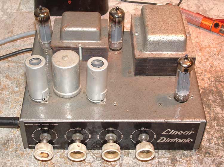

I'm joining in the discussion simply because my first decent 'hi-fi' amplifier as a young teenager was a 15W Linear Diatonic.
Later, I used a pair of 30W Linear Conchords in an early disco setup.
These traditional valve amp designs didn't distort harshly when turned up full, unlike the early transistor amps I tried.
This is it. I connected 2x speakers into the amp. Speaker 1 to newly arrived 1x12 Cab, speaker 2 has another speaker of Surround sound system made by Sony. The Sony speaker has different resistance something like 4 ohms, which is difficult to drive and really quiet no matter what amp is driving it.
I will take the Sony speaker out, and just try with 1x12 Cab. It looks like there could be impedance mismatch between the amp and the Sony speaker here.
What was the impedance of your friend's "old battered" cab and the impedance of your "newly arrived" cab? In the era of your amp, I would expect a single cab to be16 ohm. Two such cabs in parallel would then give 8 ohm.
I'd be wary of dropping as low as 4 ohm with this 1970s amp.
At any rate, do not use the Sony speaker. It is not suited to guitar reproduction and it risks damage to your PA amplifier.
The single speaker cab is all you need, and if it is 8 ohm you would be advised not to connect a second one.
First time, I thought the amp was non working, so it was just quick test trying to find out if it is operational, just in case. And it was. I was surprised.
My friend's old battered cab was 1x12 too. 8 ohms speaker I think. The amp was making noise, and the lights came on, and that was all we tested.
As you say, the 4 ohms Sony Surround speaker is not good match with the amp at all. It is very quiet even at full volume.
My new cab with 1x12 speaker is 8 ohms, and it is quite good. The sound is massive, and reproduces the lows, mids and highs very well. When both speaker 1 and 2 of the amp were connected to the cab and the 4 ohm Sony speaker, the amp sounded quiet. Now the 4 ohm Sony speaker has been taken out, and the amp sounds loud and good. It seems getting sound better everyday. I am going to get some effect pedals to get over drive and blues tones from the amp.
