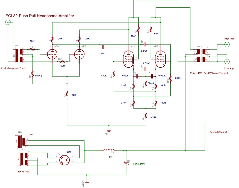

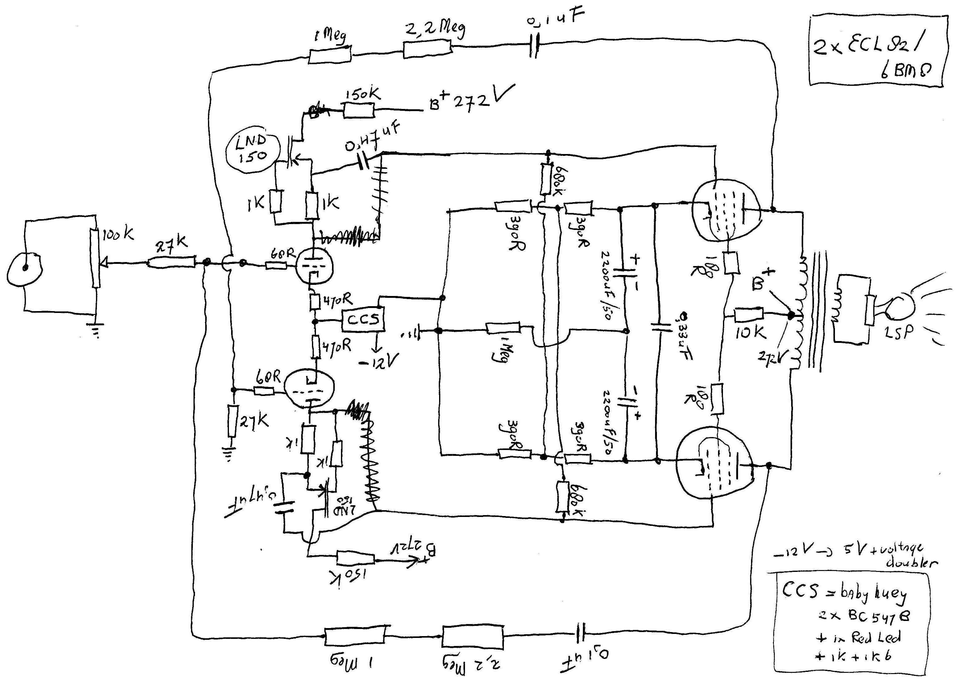

These designs can be found somewhere on this forum. They both work/sound good. Headphoneamp is from Shoog
Hi Gaetan, why did you think this was necessary and what values did you end up using
Hi Jaap, interesting 1st circuit, any more info
Brgds Bill
