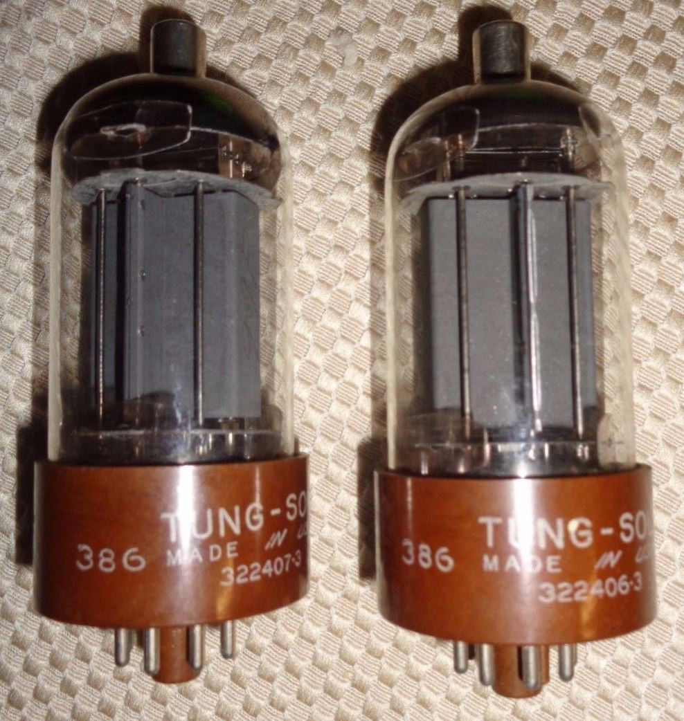

Good evening everyone,
Well, yet another impulse buy, got these for $10 for the pair on that most famous auction site. My first thought is they are 8236s, but hey I don't know. Do the numbers on the base tell us anything???

I have been known to "test" mystery tubes.....usually not destructively. I prefer the term "boundary testing." I find the glow point and back up a bit. Before any testing can be done, the pinout must be determined. The plate is obvious, and the heater should be fairly easy to figure out. The rest should be possible with careful examination.
7403 has an odd pinout, but an easy test. Heater is on pins 1 and 2. Tung Sol did make them, and the square plate looks about right.
The OP had previously stated that he had some 7403's, so some comparisons should be in order.

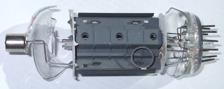

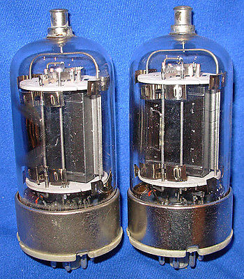

I thought the 7403/3D21 had ceramic insulators. Looks more like mica in the posted pic. Also not sure if the plate cap is matching. With the bakelite base it probably does not dissipate as many Watts as the 7403. (Tungsol 7403 pic below, then mystery tube)

The boxy looking plate looks a lot like that of a Tung-Sol manufactured 5931 (6L6WGA) I have, what about identifying the heater connections, and assuming the glow looks normal, measure the heater current at 6.3 volts - if it's remotely related to the 6L6 family, it will draw ~0.9A.
On the pinout...look inside and make what guesses you can. Test with a tester where the g1, g2 and cathode are labeled...and try some combinations until you find the connections. Look up that base connections in the RCA handbook, then go to TDSL and look for tubes with that basing...then a google images search through the vacuum tube museum should get you the answer...🙂
