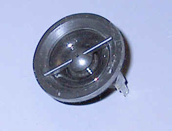

You might try the Audax TM010A1. It is the best small tweeter i have heard I used 2 in my car because space is tight and I am very pleased with them. They are about 1 1/8" in diameter and are the perfect shape to mount on a pole piece. You might also try the TM010A39 which is a slightly larger 8 ohm version. You can find both at www.madisound.com

thanks for bringing this to my attention🙂 the FR looks really good, and its also shown out of its housing, looks to be maybe a 1/2" the dome is about .4" im going to try this crazy idea 🙂 Since I HATE XOs the plan is to let the p13 assume its natural smooth roll off. it looks to be -3 @5K and -6@7K. so a paper in oil cap (also left over🙂 at 5K would match or a cap and inductor down 6 db@7K, if 6 db dosent cut it off fast enough. I actually listened to the p13 by its self for a few months, but finally the missing high end got to me. This is a very smooth little driver, extremely well behaved and ruler flat from 100 to almost 5K🙂

Hi Dave. TM010A7
where did you get these dave? how much? They are perfect. Ill also try the PE269-782 3/8" neo @ 32cents ea🙂 thanks to all of you for the help 🙂😀

I bought them about 6 years ago from Martin Sound, i think they are discontinued, but some calls or emails to Audax distribs might turn some up ... i just looked in the Solen price list and they have a TM010A39 which could be a close relative -- looking on their website it is listed as a TM010A7 and the pic looks right.
