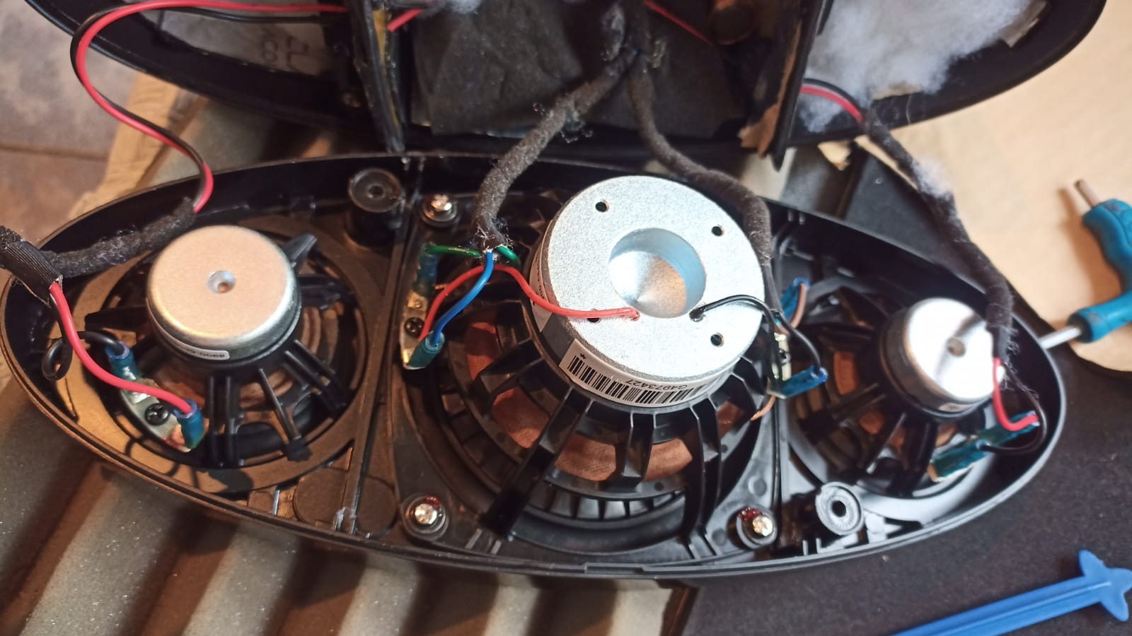

One small example from a respected manufacturer is KEF HTC3001 - 3005 centre channel speaker which uses dividers to split the enclosure into 3 separate compartments to great effect.
https://www.lencoheaven.net/forum/index.php?topic=31371.180
Replies # 194 & #222

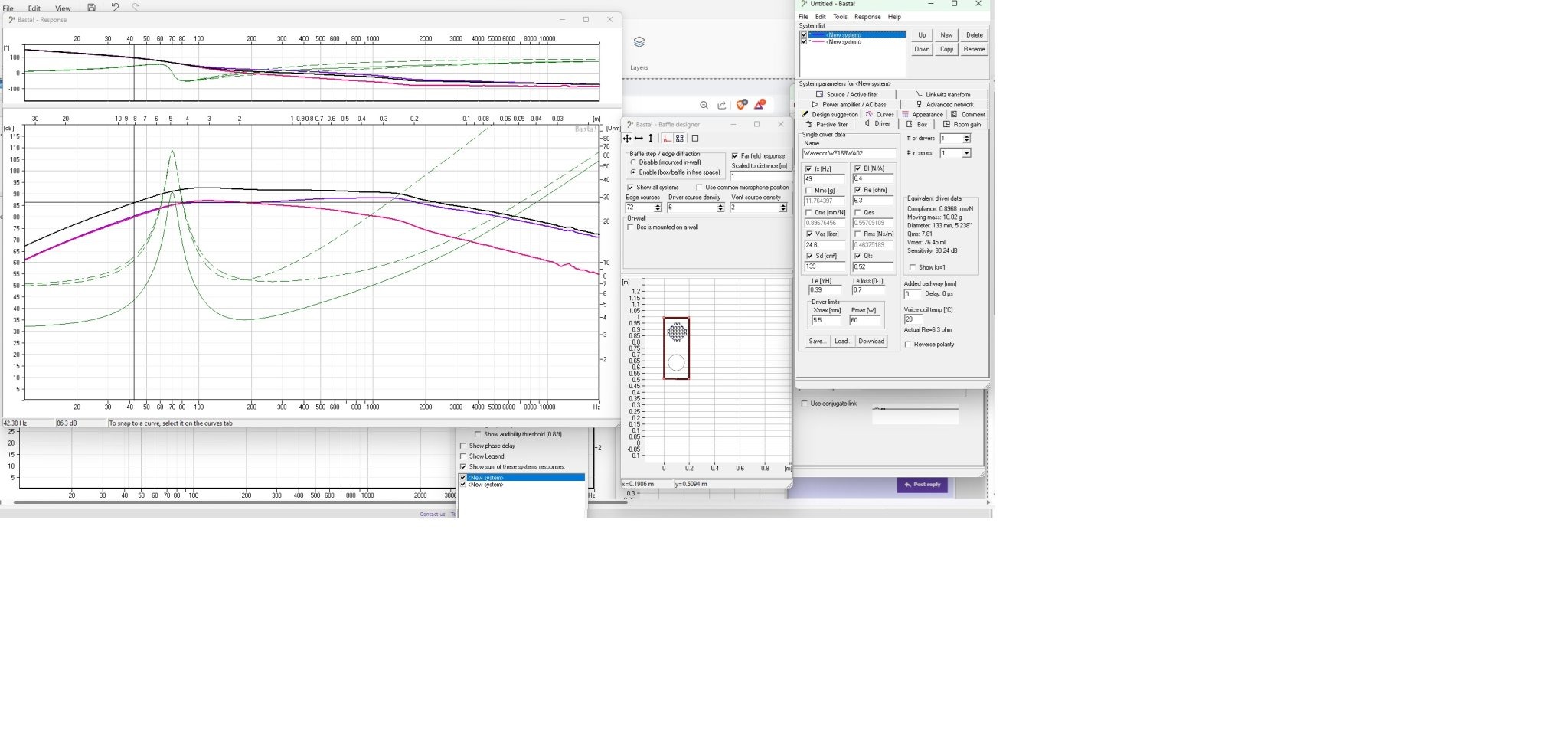

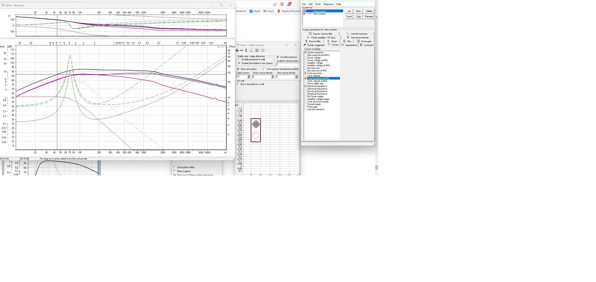

Here's a screenshot from my simulation with Basta which shows F6 @ 43 Hz.
What you see there is one woofer crossed at roughly 300 Hz (magenta), the other crossed @ 2800 Hz (purple). No tweeter in this simulation. Woofers are in parallel up to 300 Hz, that's approx. the baffle step, then the second one takes over. That's why the rather steep rise of the impedance.
Above the FR curve you can also see the phase.
The second screenshot shows the cone excursion and also at maximum output level (MOL).
