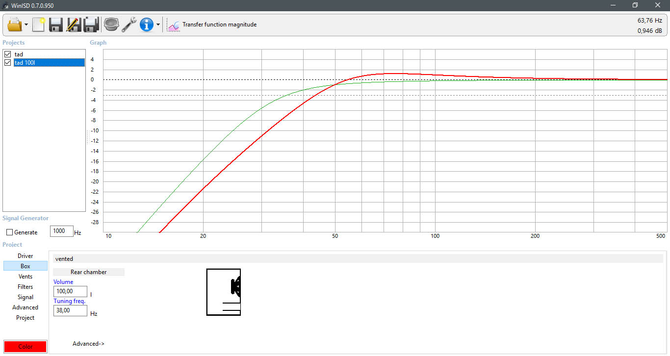

Run WinISD to simulate and you will get something like this.
Red line is 100L and the green is 170L

Another option, I suppose, would be to use a ~90L sealed box, with f3 of ~60hz
The f10 is around 35hz and the sims I ran show the sealed box and the 175L (net) vented box crossing paths at 20hz (~f15)
I could go active with some gentle boost in the 20-40hz range.
Thoughts?
Cheers
Max
Just so nobody starts yelling at me, the 175L vented and the ~90L sealed share very close F15s more like 25hz
f10s are 30 and 35hz respectively
The f5s of the alignments are very different...
So the idea was maybe to go active and add a little bit of boost to the sealed enclosure.
Or maybe try it out first and see what room gain does!
HR calcs a 0.76 Qtc with the 2.78 ohms series resistance [Rs], so basic damping will probably suffice and with only 5 W and bit of room/boundary gain seems like a good compromise. Of course if [Rs] is lower, then for better or worse it will flatten out any mid bass peaking.
