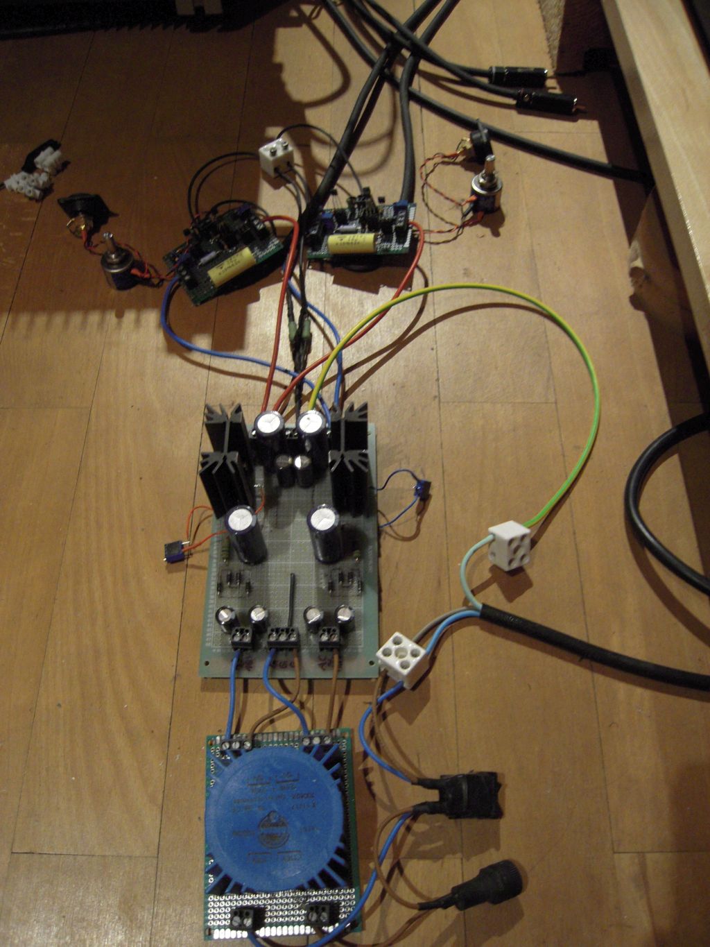

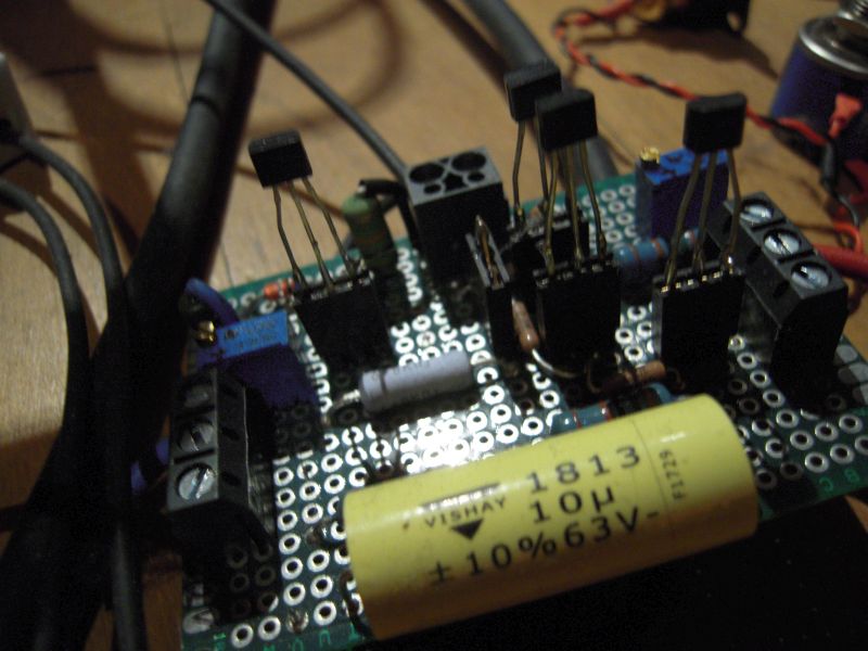

two pics of my ZVN/ZVP3310 -preamp. It never got a case... 🙄

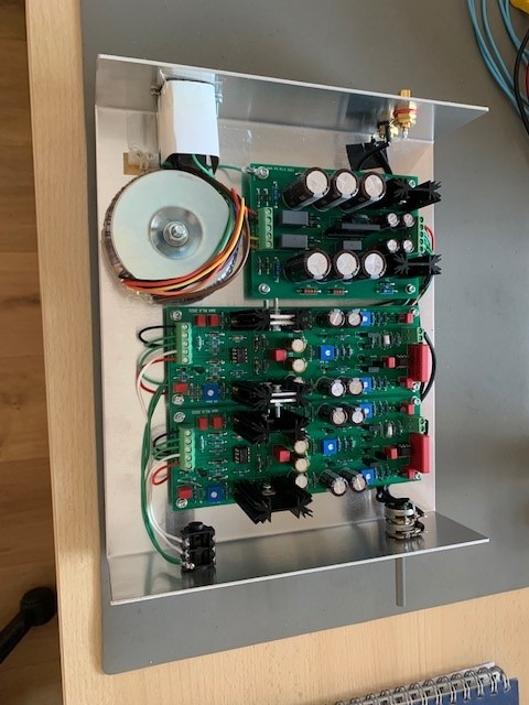

In the interest of sharing I’ve attached a picture of my headphone amplifier build.

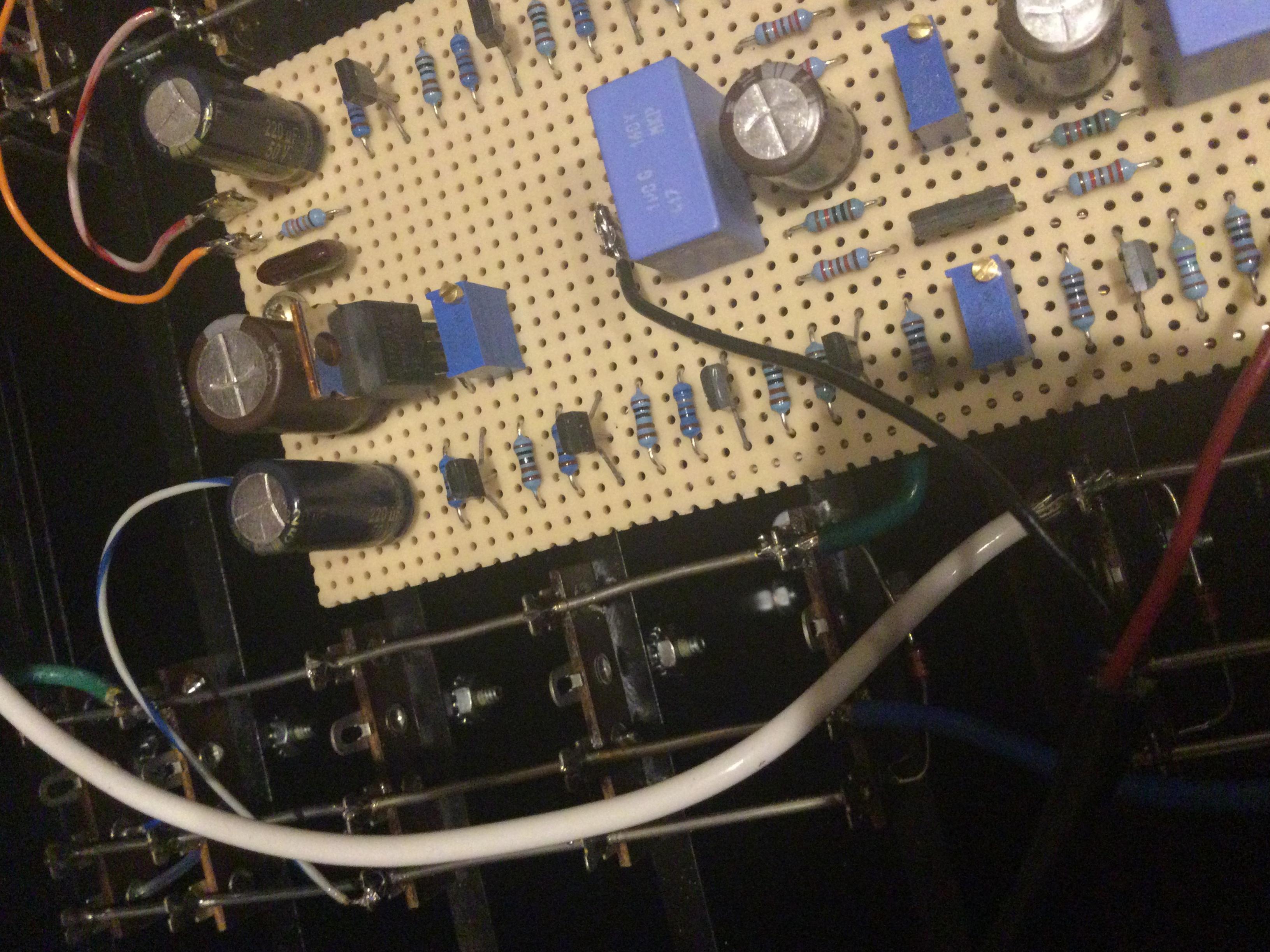

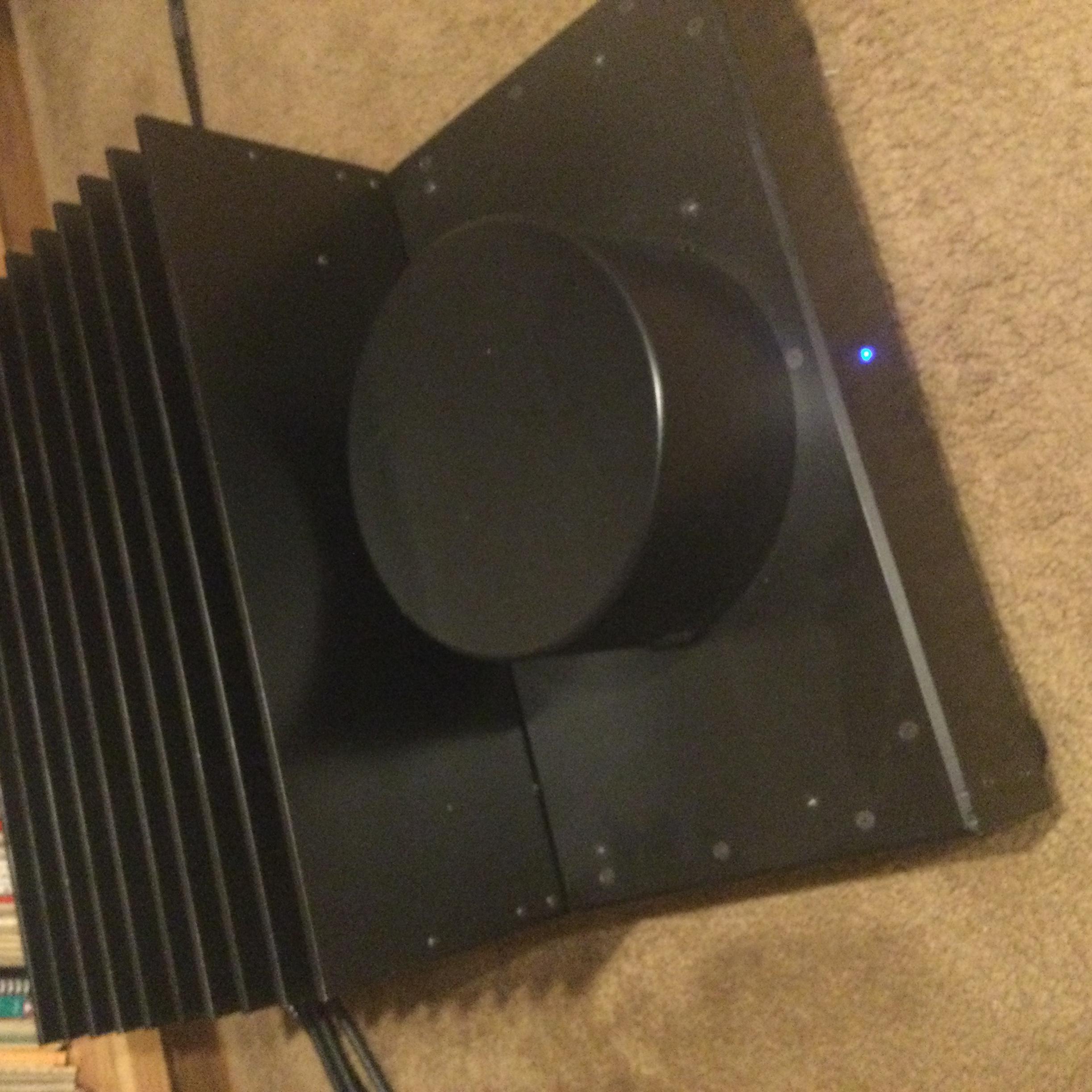

Here are the pics I promised. I am building a 200 to 250watt per channel balanced amplifier to drive a pair of mg3.6 speakers. It has a BA-2 output stage with 5 mosfets per quadrant. The front end will be from the Sony VFET project. However, I don’t have enough 2sk313/2013 parts, so I’m substituting paralleled 3310 mosfet pairs. The front end circuit you see in the picture is temporary and was used as a test bed. The next step is to build the VFET front end with the paralleled 3310’s, test that on the bench and then install it in the amp. Wish me luck.
I included an ‘outside’ view of the overall amplifier. The power transformer is swag from BA 2008(?) and originally had a masking tape label that stated that it was pulled from an XA200 prototype shown at CES.
The amp as shown has been running successfully for 6 months. The 3310’s are not as thermally stable as I would like but they’ve behaved so far.
