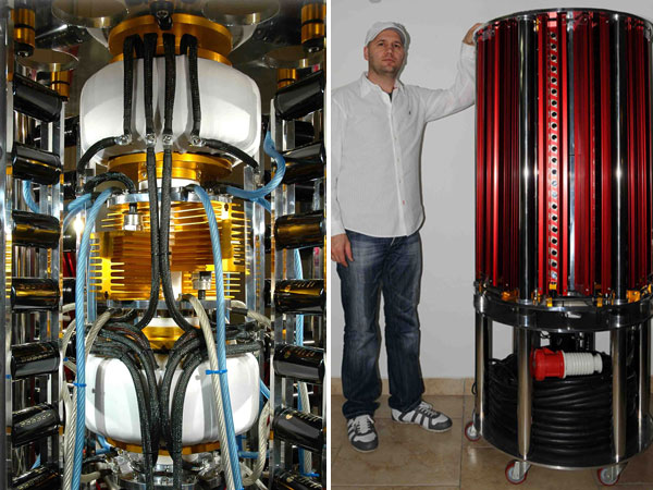

By the way check this (picture) out guys:
In raw terms the most expensive power amp HigherFi offers the Opera One goes for a discounted price of only $490,000 and for those who can afford and wants the best of the best for their music.
