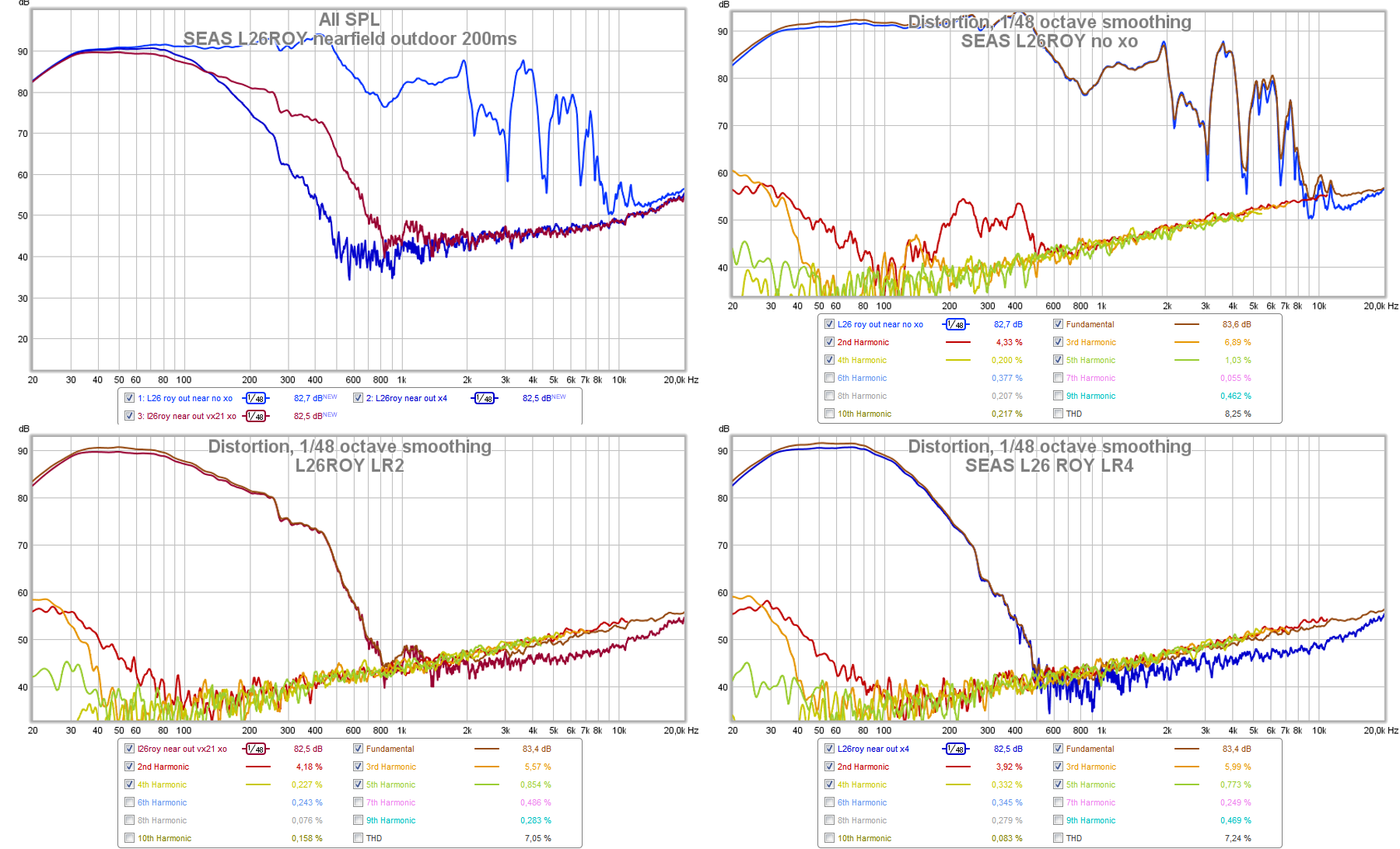

I would not ne so concerned about H3 distortion. Here is an example of my outdoor measurements of SEAS L26ROY4. We can see the H3 distortion between 200-500Hz to disappear when crossover is applied. I suppose the same would happen to the coaxial mid.
Ia am waiting for Troels' work on this one! A coaxial mid-tweeter has some unique virtues and obviously the shallow cone helps to get tweeter response so smooth.
