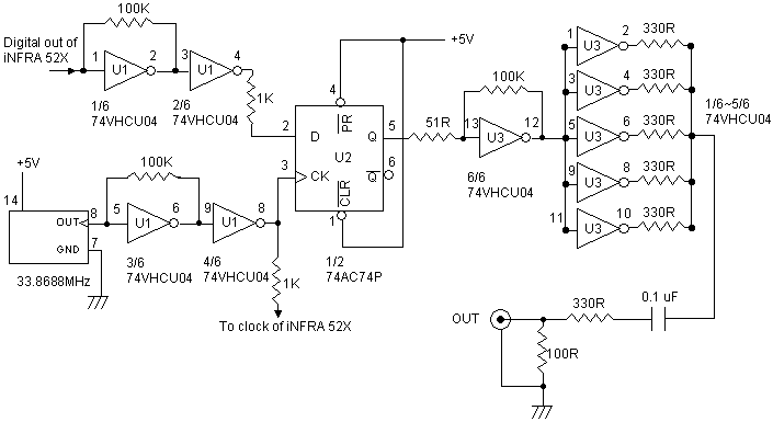

T takashi Member Joined 2002 audioworkshop.com.hk 2003-03-18 4:21 pm #1 2003-03-18 4:21 pm #1 any comment of this circuit? it use a higher clock to re-clock the spdif... Attachments dsix-mod.gif 7.7 KB · Views: 409 Jiiim Member Joined 2002 2003-03-19 2:31 pm #2 2003-03-19 2:31 pm #2 metastability issues Jiiim Member Joined 2002 2003-03-19 2:40 pm #3 2003-03-19 2:40 pm #3 see: http://www.diyaudio.com/forums/showthread.php?s=&threadid=12610 Status Not open for further replies. Share: Facebook X (Twitter) LinkedIn Reddit Pinterest Tumblr WhatsApp Email Link
