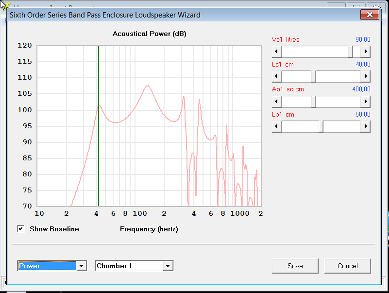

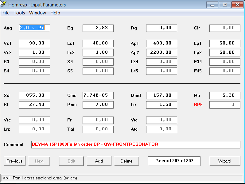

A fast not optimized example of a 6th order bandpass with a large quarterwave frontresonator instead of a front volume of air and a port or passive radiator.
Johannes
