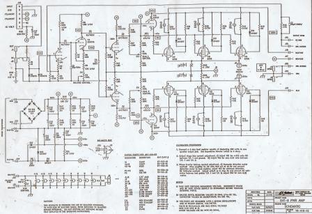

I have this SVT-II but the only schemos I managed to get were the SVT-II Pro which from what I've heard differ a lot, don't they?

ahmmm
thanx guys
but the schematics there have little to do with the amp I have in front of me!
they seem alike but not the same circuits!

well not exactly...
well junction
the problem I'm facing is not exactly that...
the real problem is that they brought it to me and it has no output so I'm searching for a schematic to follow the signal path and see where it's put to gnd!

SVT-II and II Pro are tube amps, no MOSFETS. Both are rackmount, but the Pro has a couple of extra features in the preamp (more bands on the EQ, different line-out, etc.)
