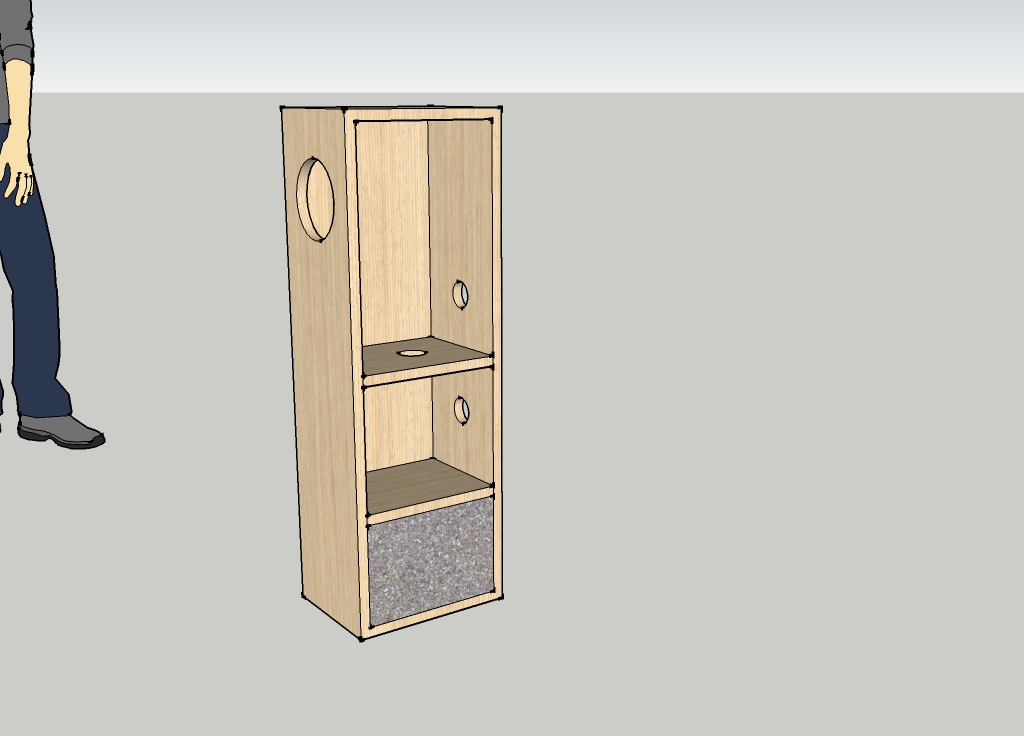

Another option for you to consider is a double bass reflex or dual chamber reflex. This design suppresses cone excursion across two octaves and will reduce movement-related distortion. They're dead easy to design. Given that the FF165 looks as though it needs around 20-25L volume, I would design a floorstander as follows: calculate for about a cubic foot volume; divide the whole cabinet in half with a horizontal divider, then divide the bottom chamber in half again. The top compartment is the main compartment housing the driver and is about 14L in volume, the two compartments below are 7L. The top two compartments are connected via a port and then ported to the outside as usual for a dual chamber reflex, and then you fill the bottom compartment with sand to increase stability and reduce cabinet vibrations.

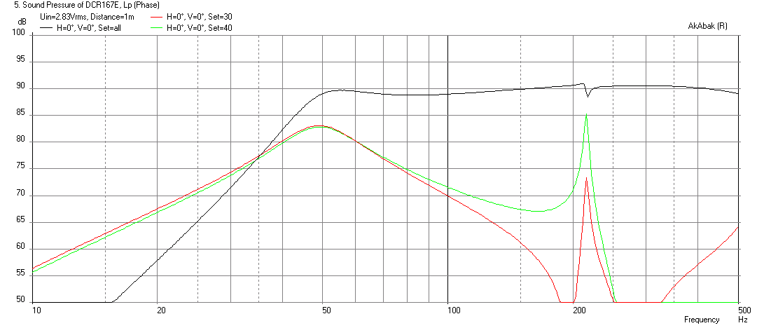

Here is a DCR that is 18in tall x 14in deep x 8.5in wide (internal dimensions), divided in 2:1 volume as described above. This DCR is fitted with an FE167E through a 7ohm and 1.0mH BSC filter. Vents are slot vents for top and bottom at 10cm wide x 0.5cm high x 114cm long, internal vent between chambers is 2in dia hole drilled in 0.5in thick ply.
Freq response produces nice deep bass at 50Hz:

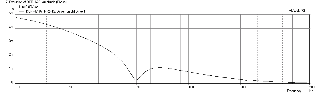

Cone displacement at 2.83v - needs a high pass filter below 40Hz if you have content there:

Edit: Pure conjecture? DCR's are easily modeled in Akabak, and it's not all simulations. I have designed and built them and the model predicts the response quite well. Look here if you want more info:
http://www.diyaudio.com/forums/full-range/252627-viva-la-vifa-curvy-cabinet-dcr-tc9fd.html
Here was predicted response from main and each vent:
Here was measurement (look at shape of green and pink curves compared to model):
404874d1394457660-viva-la-vifa-curvy-cabinet-dcr-tc9fd-dcr-1-meter-integrated-ports-no-bsc-spl.png
