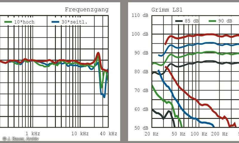

Measurements of Grimm LS-1 look good. This is the speaker that ScottG linked first.
Grimm Audio LS1 im Test - connect
Thanks, Juha! If I ask enough questions, I eventually seem to get somewhere positive.
They are using 6" pipe for half rounds. Guess I will too. That will really begin to look "the business" ... whatever that actually means, LOL. 😀
