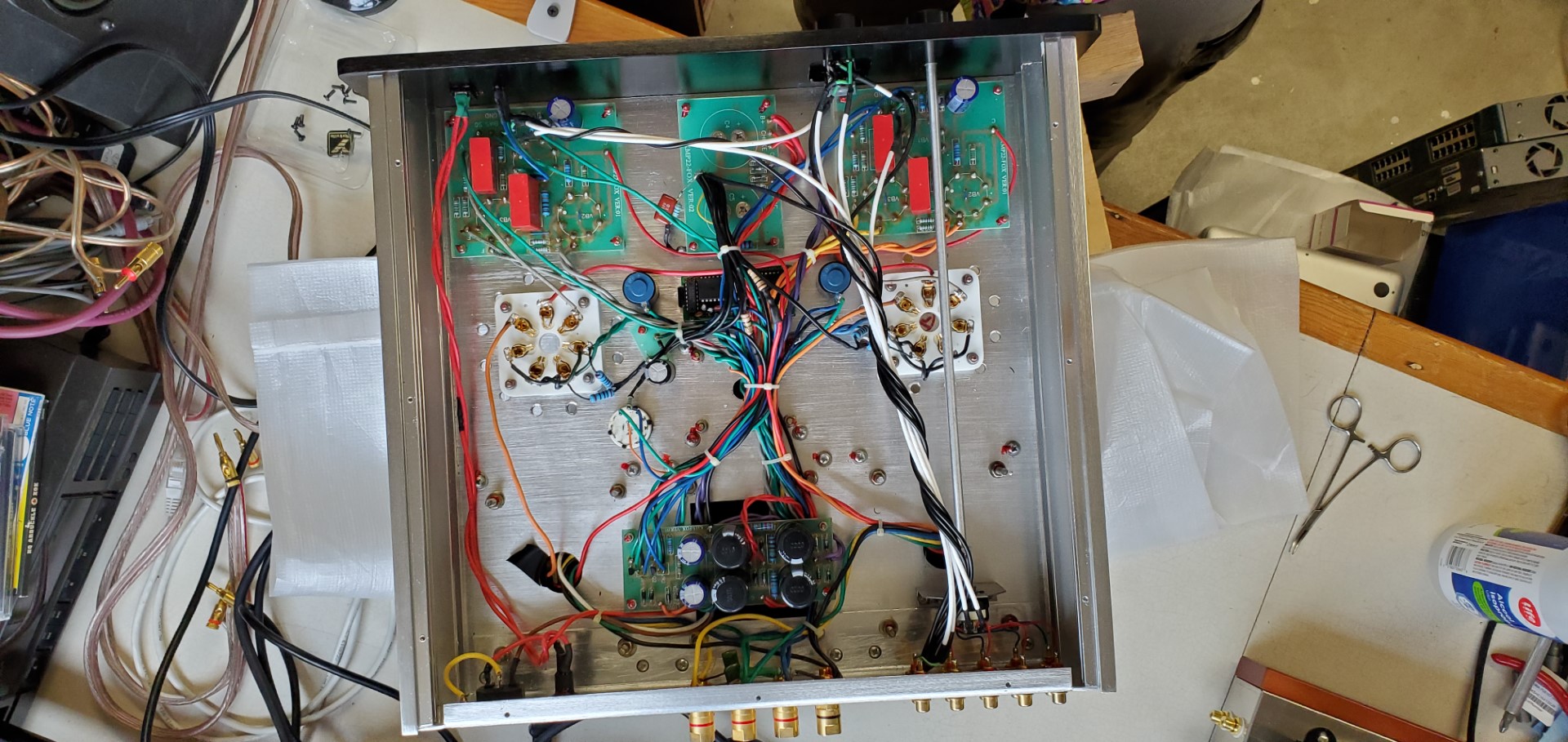

The ALPS pot was getting very noisy and would cut out when adjusting the volume and the output tube socket connections were losing their tension.
I recently (yesterday) pulled it apart and gave it a good cleaning replaced the power tube sockets and resoldered some other poor looking connections.
The Amp is sounding great again thanks to new sockets and deoxit.

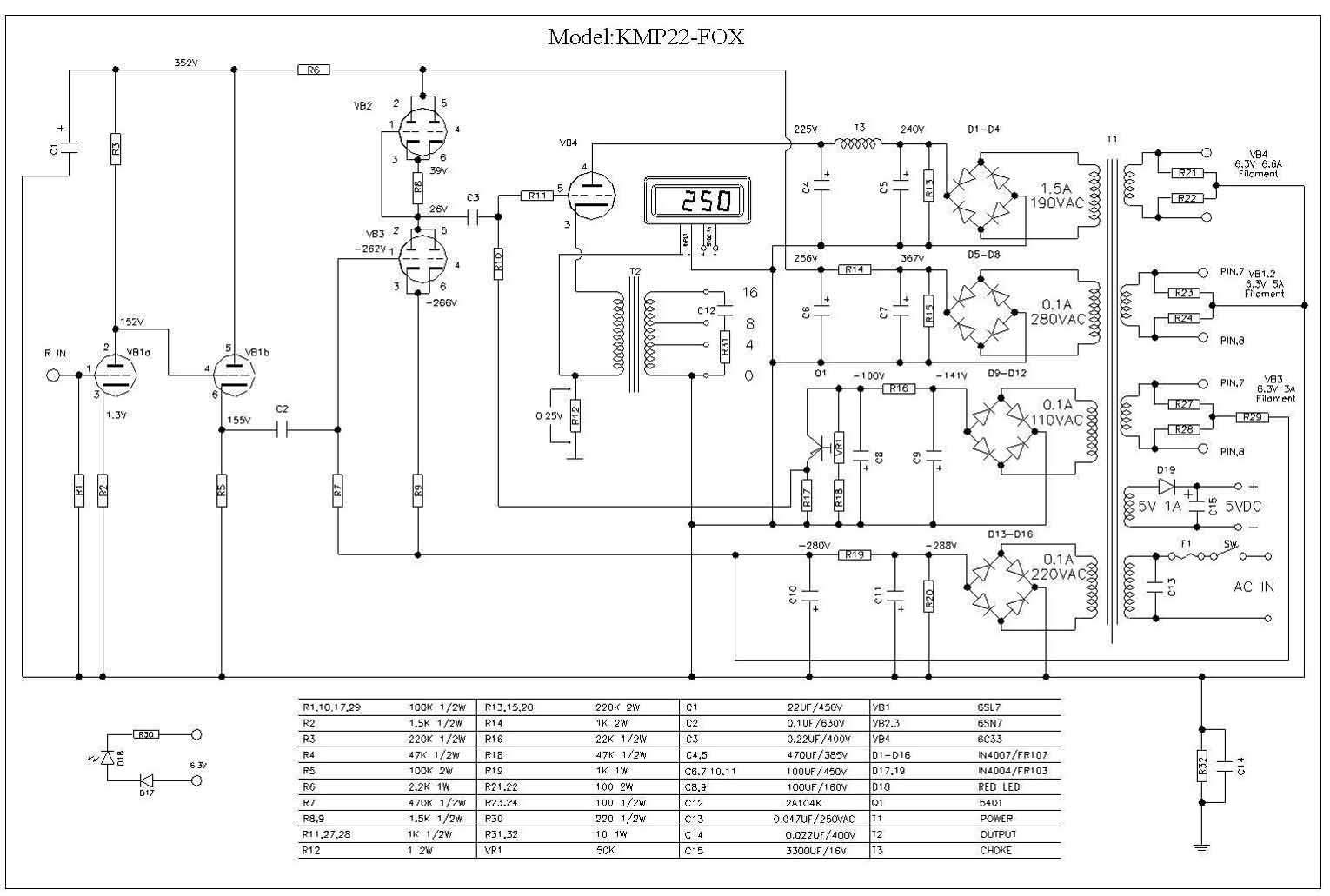

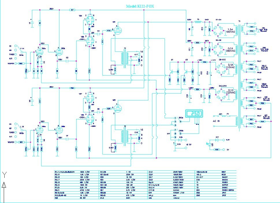

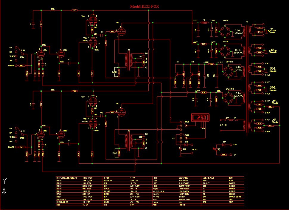

I've been trying to find a schematic for this amp but all I've found is a jpg of the schematic which is too low resolution to make out any details.
I'd appreciate any help finding a schematic.

Re post #3 schematic, that's a horrible colour scheme, why not got the whole hog and make the schematic & writing black on a back background : ) You could use Gimp or similar software to change the background to white, might make it more legible.
Andy.
Andy.
Or you could open the link in message #2 and find the same image in monochrome.
That schematic is a mono block version, I didn't own any, but diy my own which is stereo using a different sch, but also a cathode follower as output stage. What OT is ASL using?
RE: KI22 fox Schematic
comparing the 2 schematics they are pretty much the same..
the difference I can see is in the input stage.
also I'm wondering is there is any difference in the components because of the preamp tube difference. The clear schematic shows the first stage is a 6SL7
my amp uses a 6SN7 and as near as I can tell that's what the schematic shows.
unfortunately I can't make out the resistor or capacitor values.

KI has NFB around the amp, so need nore gain (6SL7). KMP does not. The resistor values do not seem to change; in a 3-stage amplifier, the first stage is not too fussy.
That would make sense But...

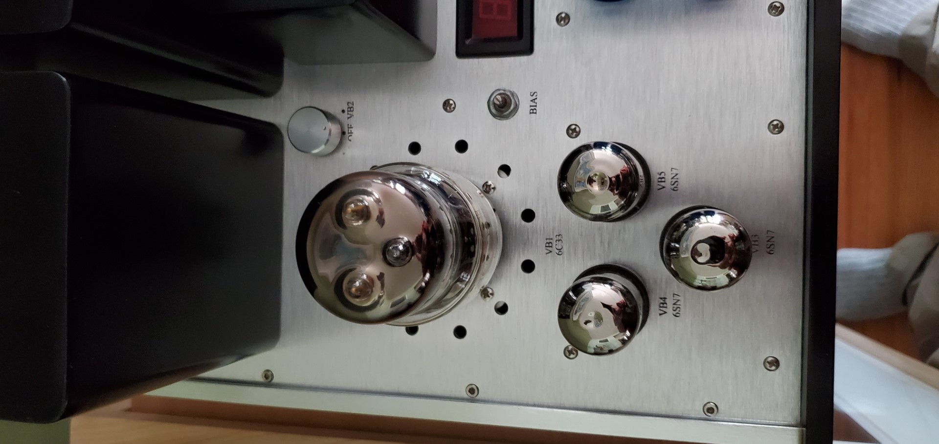

KI is the one with only 6SN7's and the tube types are silkscreened to the top of the amp
KMP is the one with the 6SL7
What is the primary impedance of output transformer T2?
Art
Not sure...
I'd have to take the amp apart again to test it
and it doesn't show on the schematics

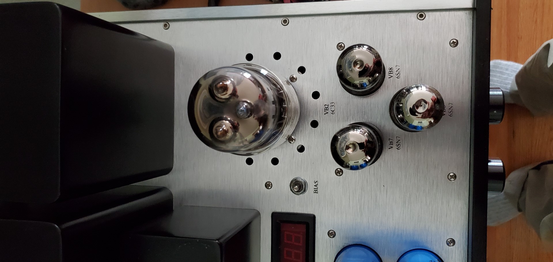

There are indeed 6 6SN7s in the amp.
6SN7EH's to be specific.
I took pictures of it when I was working on it.

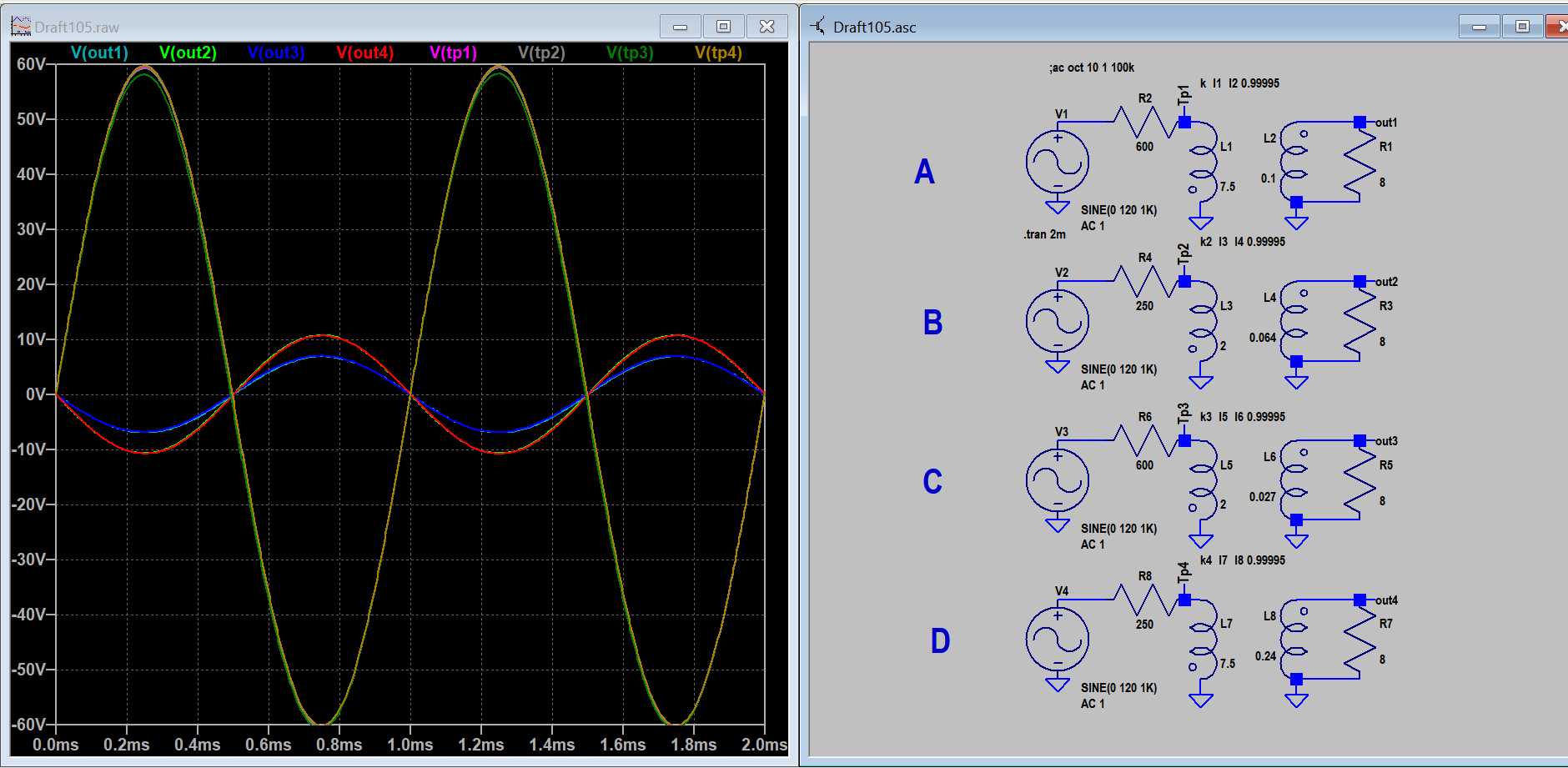

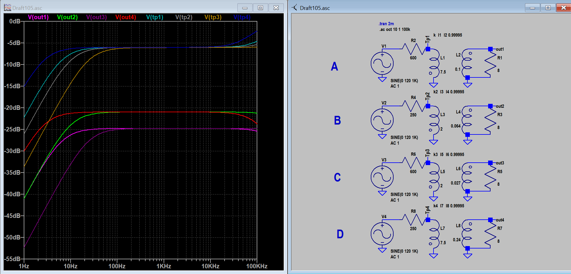

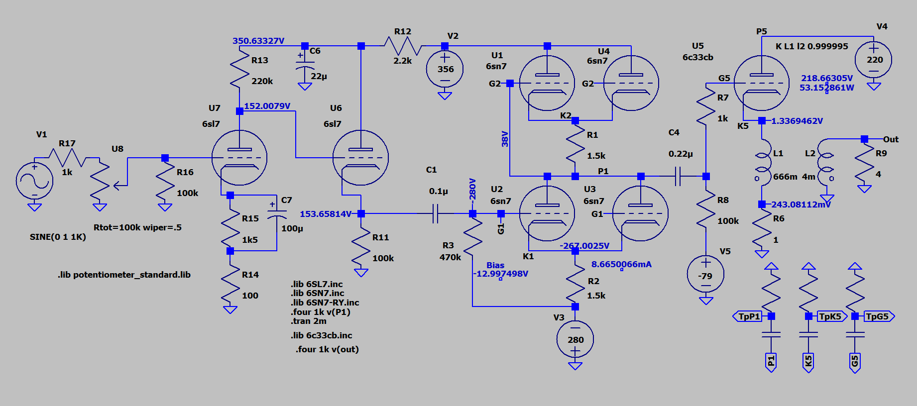

Late to the party, but I'm considering whether it's feasible to replace a failed output transformer (or more likely both, for matching) in a KI22-FOXDT, and I thought I'd post some observations. I should say that I'm not an expert on tubed amps, and way not an expert on output transformers, though that may become obvious.
On the believed-to-be-good transformer, I checked turns ratios in the manner @audiohead suggested. I had the output tube removed and the output unterminated. I came up with 4:1 for the 16 ohm tap. The other taps were consistent with that. So far, so good, I think.
That corresponds to a primary impedance of 264 ohms. I don't know if that's remarkable by itself. But if the output tubes are supposed to have an idle bias of 250mA, as I gather from the above schematic, then signal current can't be more than 500mA peak-to-peak, right? Which would make this around an 8WPC amp instead of the 22WPC spec. Am I getting the math wrong, or is this just a fairly extreme case of spec inflation?
I tried to measure the primary inductance, too, by paralleling a 2uF cap and looking for where the impedance peaked. I came up with 80Hz, which (again assuming my math is right) would correspond to about 2H for the primary. This is much lower than the inductances that are briefly discussed in @Koonw's 6c33c cathode output amp rewoked thread. Is 2H plausible?
Whoops, at least one numerical error there - meant to say primary impedance is estimated to be 256 ohms (not 264).
2H is very low for primary inductance, it should be more like 100H +. Your quiescent bias current normally gives little indication of output power, but then this amp is different to your normal PP or SE amp, other more experienced builders should be able to give a better answer than myself. All I can say is that in a valve amp the OPT acts as a current transformer converting high voltage low current to low voltage high current, the more voltage swing you have on the primary the higher the OP will be.
Hope that helps, not the perfect answer but as no one else has chipped in hopefully better than nowt, Andy.
