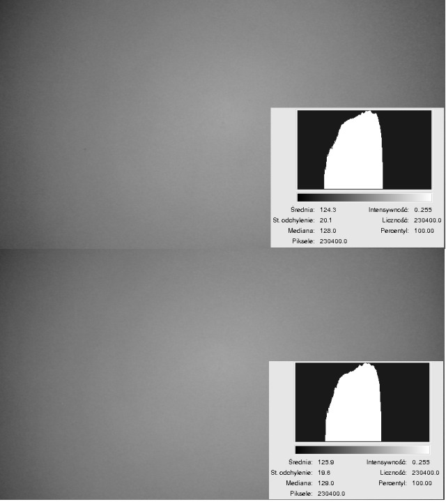

Being curious, and reading all that buzz on the Lumenlab forum, I tried it myself. Despite I was very skeptical that it might be really beneficial (except some particularly bad LCDs), and seeing, that some of the Lumenlab members are kind of "undercover salesmen", I decided to give it a try, at least hoping it would improve brightness somehow. And it did, by less than 1% 🙂
Here is the result of before and after shots of a white screen, only central 16:9 part is taken into consideration. Sorry I forgot to switch language for the histogram window, "srednia" means "mean value", "st. odchylenie" means "standard deviation".

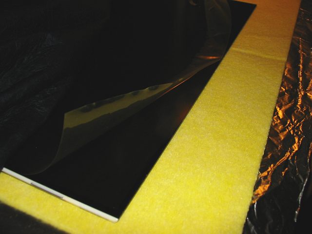

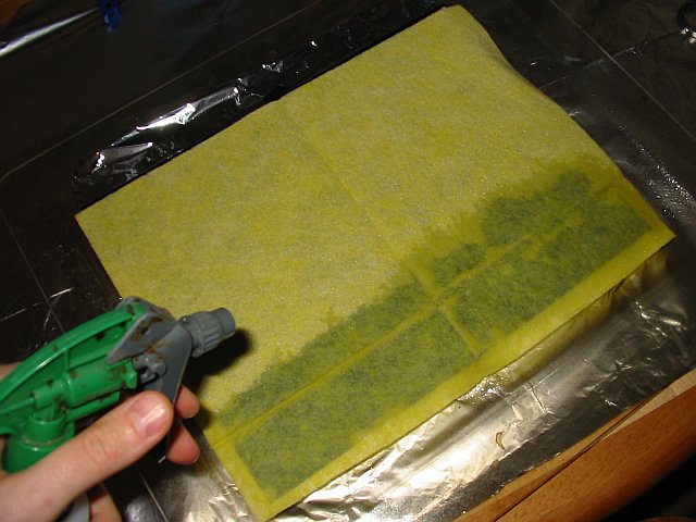

And here is the procedure:
- put the LCD flat, protect the connector boards, the LCD should be facing up with the side you are looking at in your desktop monitor
- put a very soft towel on the LCD
- soak this towel with lots of water
- cover with plastic foil, to protect the water from evaporating
- leave it for several hours, I left mine for about 4 hours
- gently try to pull the antiglare film on the corner
- BE CAREFUL, DO NOT REMOVE THE WHOLE POLARIZER
- check twice if you are not removing polarizer! It was possible in my case!
- thin, colorless plastic foil should go off
- the underlaying polarizer is very fragile, be careful not to scratch it

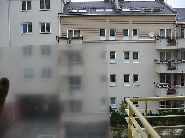

And this is what I have removed from my screen. This film is almost transparent, does not block much light. By the way, I damaged two pixels, I don't know why, perharps static electricity did that, so now I have two dark spots. Not a big problem, but it certainly happened during this procedure, so be careful.
Here are my conclusions:
- if there is any improvement to the projected image, it's neglectable and not worth the risk and work involved
- this film is diffusive, as you can see in the picture, but that does not mean the projected image is diffused in a similar way, so removing this film will not make the difference like in this picture. In fact I can't see any difference, the picture on my screen is neither sharper, nor brighter, nor has better colors, it's all the same like before.
- removing this layer will make the LCD more fragile, as the polarizer can be easily scratched or damaged, and is enormously difficult to clean!
- if someone persuades you, that it's a magical cure for all the weaknesses of our DIY projectors, and all you need is to pay an "entry fee" to get to the these "secrets", rather consider it as a scam. There are no "secrets" in these projectors, it's a well known construction, based on widely available knowledge.

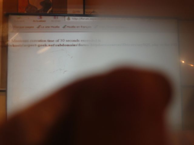

I've been seeing a few things here and there about removing it but was skeptical of the risks/rewards. Thanks for the info!
just wondering pepe, are you sure this is the antiglare you remove.
i remove now 2 film from my lilli the front side is the ag and the back side is some protection film.
So some lcd do not have antiglare or might have antiglare and a protecting film.
on the left the protecting film (from the back of the lilli)
on the right the antiglare (from the front of the lilli)
you see clear difference since with the antiglare you cannot read the text while with the protection film yes

Yes, it was an antiglare (or both antiglare and protection), now my LCD is shiny and transparent, like a piece of a dark glass.
yes, in fact i didn't pay attention to the picture you took of your AG.
Does the AG was on the side of your projection lens in your pj??
