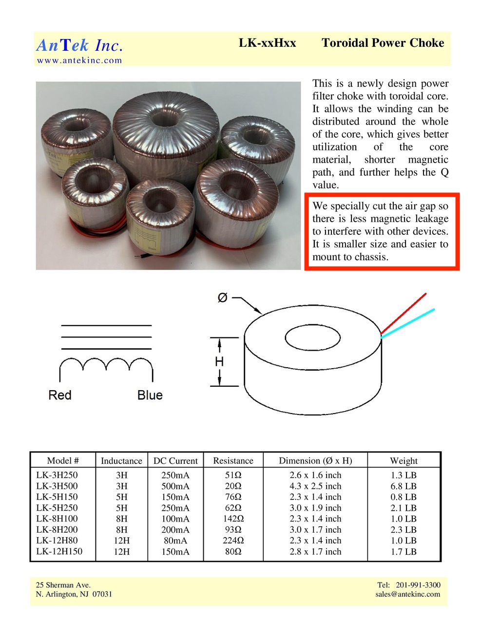

Antek is now making torroid chokes
I was at Antek ordering a torroid transformer. And at check out time they popped up a new product line. Apparently they are making torroid DC chokes now as well as their power units. (yeah). The last time I was at Antek early this year I didnt see anything in chokes.
Now I thought torroids and DC didnt get along? Is there a secret sauce to winding a torroid for DC choke use? These are priced pretty competitively.
Do you think one of these would work as a choke input configuration as well? Or is that just pushing it too far?

The frequency response plots on Antek's site are very unimpressive, showing -9dB down at 20K. I'd be very interested to learn more about how they actually perform- I don't want to believe it's that poor. If anyone is willing to buy one and take some measurements, I'm sure we'd all be very interested to see.
The frequency response plots on Antek's site are very unimpressive, showing -9dB down at 20K. o see.
Theres that, but on the left end of the graph the bass response is pretty impressive. But then again no mention of how hard it's being driven to get that graph. All items are PP though so Antek hasn't even ventured into gapping. Still it's nice to see a mfg bothering at all in tubes. Many here post using power torroids as OPT with a lot of guessing and compromising.

Can anybody comment on the possibility of one of these torroid chokes used in the choke-input position?
A torroid seems like a much easier object to pot yourself than an EI choke, no nooks and crannies, its a smooth round object. That is if it can serve in this position and potting would make any difference. Also, in theory, wouldn't magnetic coupling with other nearby components be better with a torroid choke over an EI? Leaving more wiggle room in how a given chassis can be laid out?
I'm building the "Franks 6SN7 Pre Amp" right now, that tiny little Antek 12H 80ma choke looks pretty good for the chassis I want to make.
Magnetics Inc used to make toroid cores with a magnesium oxide coating on one or both sides of the magnetic strip, before winding up, so as to make a distributed gap. All of that strip length gap is effectively in parallel though, so would be difficult to make a significant gap for DC that way. Maybe could wind the magnetic strip with a plastic sheet bonded to it. Only other way is to cut a gap and insert a spacer.
I'm using one of their chokes for the B+2 in my 845 amp. (I wrote to be sure it would handle the voltage and found it would be more than enough). I've also used one of the little ones in a 5687 WOT pre-amp. I've had really, really good experiences with Antek's power transformers and chokes in both tube and SS applications. Always very affordable, shipped fast, and worked exactly as I expected.
