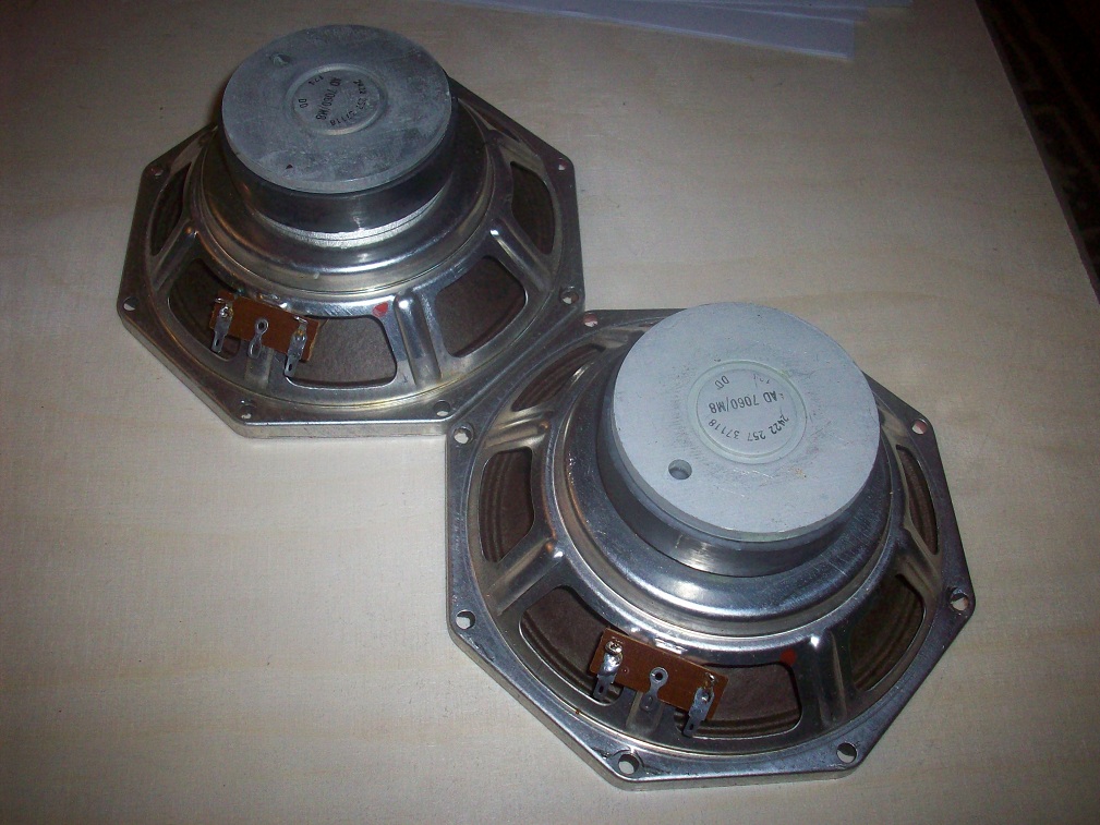

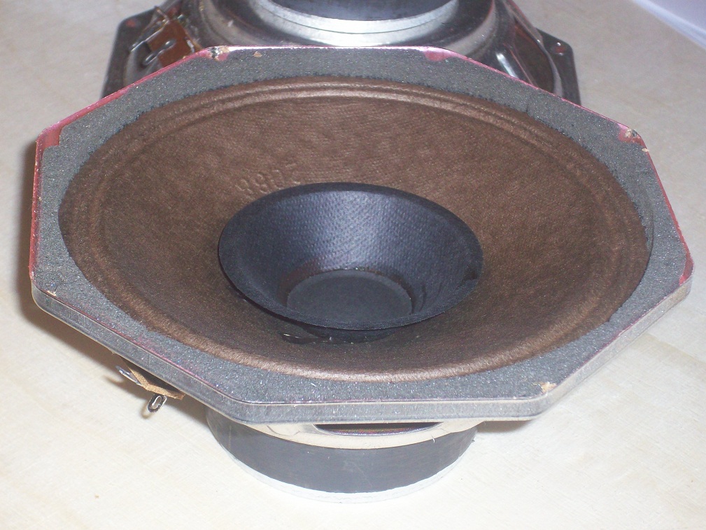

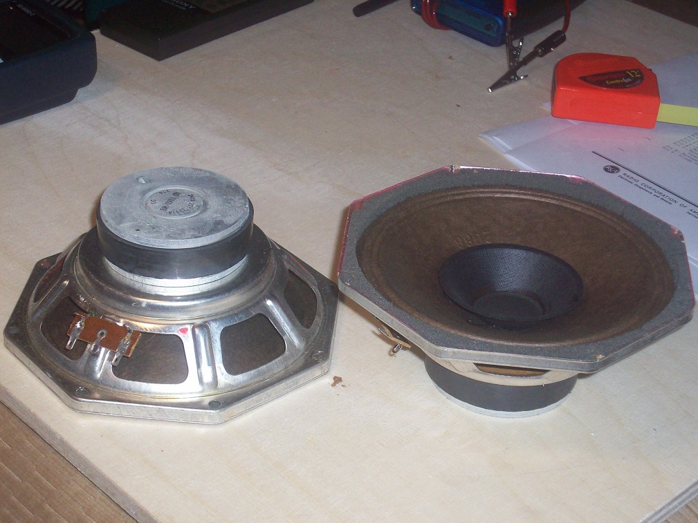

Another vintage Philips FR joins my slowly growing stable: AD7060/M8
I grabbed a super cheesy pair of Noresco 511 bookshelves at the thrift for almost nothing, not even knowing what driver hid behind the non-removable grille: but I knew it was a single 6 incher, from feeling the cutout.
As I suspected, a Philips fullrange, model AD7060/M8. Ceramic magnet, whizzer cone. Otherwise similar-looking to the older quad of AD2700 I got a while ago: same basket, same cone and surround but different magnet, whizzer a bit different, dustcap is not the same as well. Hope their Qts turns out to be a bit lower than the 2700's 0.9 that kind of limits their applications.
Here are some pics:
Will run some test to get T/S parameters and post back here.

I finally got around to measuring the AD7060's parameters, here it is for reference:
Philips AD7060/M8 T/S parameters (average of two units w/ very little deviation)
Znom: 8 ohm
Re: 7.85 ohm
Fs: 46Hz
Qms: 3.36
Qes: 0.875
Qts: 0.694
Vas: 46.1 liters
Sd: ~133cc
SPL: ~89dB/W/m
Played around a bit in WinISD and they seem like they would be happy both in sealed and BR enclosures, with a slight hump in the bass. They could do OB as well, without expecting foundation-shaking bass. Might also be interesting in a TL.
