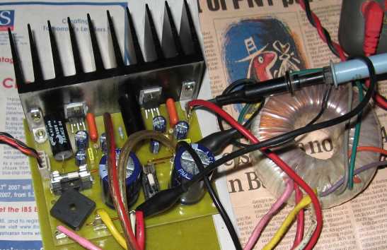

Another TDA2050 amp built and tested..............
Joined 2002

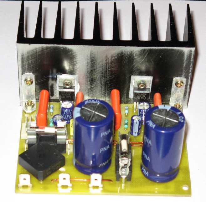

After seeing so much written about the TDA series of chip amps, I couldn't resist testing the TDA2050 which is so cheap over here.
All parts are standard and the circuit is off the application note. Only the gain has been increased slightly due to component value changes. Input R = 47K and input C = 1uF ( Philips film )
Feed back is 47K and 1K with a 47uF electrolytic to ground.
Supply is +/- 25 volts dc from a 50 VA(!) torroid . I didn't have anything else.
The heat sink is too small for loud listening levels. The temperature was about 50 deg C I guess. I couldn't touch it for more than a second. Will check that tomorrow.
The sound was..... well...... incredible for a $1/- chip ! The first few minutes it seemed to be a bit rough in parts but as time went by it got better . Will have to let this play for a while before coming to conclusions. It looks like voice will be fine, deep bass is definitely there. The sound is tight and treble is clean .
However at times things are not OK as I seem to hear background trash. Mostly with complicated sounds. Might be some RF hash . Might need some compensation caps . Right now there are no compensation caps anywhere.
Supply cap is only 4700uF per rail but seems to be fine.
Never expected this to sound so good. Background noise is inaudible . Will check that again tomorrow. I'm going to get some more boards made and build a few more. Good to have some low cost good sounding rugged amps around for experimentation.

Some observations:
Running it at full blast .....just clipping ...at least 30 % of the time, it sounds good. Test signal was pop music off a CD player.
Heat sink temp rose to 60 deg C at the chips.
The 50VA torroid just got a bit warm.I was expecting it to get hot.
DC off set was less than 3mV on both channels.
A bigger torroid with 10,000uF caps might improve the sound some more. My speakers are nominally 8 ohms . They dip to about 5.8 ohms in the lower mids I think .
With some tweaks I think it will sound even better . As it is , it is great. I'm happy I tried it. Will have to refine the pcb a bit.
Great $1/- chip .
Tweaking it too much would be expensive and therefore pointless because the higher powered chips are also not very much more expensive and offer better performance.Over 90% of the cost goes towards the rest of the amp.
Cheers.

As mentioned earlier , the transformer is currently a 50 VA torroid as that was all I had at hand. It’s too small but sounds surprisingly good and does not heat up much playing into 8 ohm speakers at full blast . I will be ordering a 100 or 120 VA 18-0-18 V unit .
The heat sink is also a bit small. I managed to reach 68 deg C playing loud on 88db/watt speakers. No harm done. In a proper case with fins on the outside it should be OK for music.
I changed the speakers and the occasional roughness in mid range mellowed down a lot. Then I changed the input cap to a Solen film cap. Now it really sounds very good. It might just sound as good as a LM3886 . I cannot vouch for that until I try it out in an A/B test.

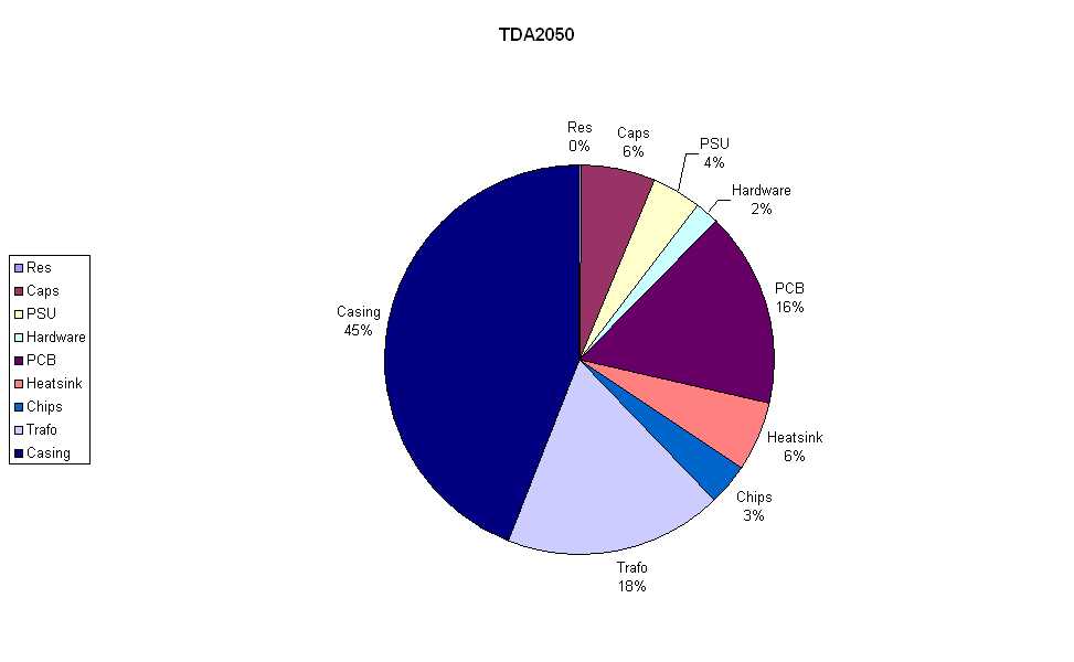

What makes this amp so interesting is the heart of it cost next to nothing and it sounds so good with a respectable 20 watts per channel! But then that is true only for a DIY amp. This is also not for people who like to rock the house down.
I made a pie chart to compare the cost of various parts of the amp. Looks interesing.
Resistors are less than 1% of the cost ! The ‘power devices’ are just 3% of the cost !
The casing ( Aluminum box ,RCA sockets and speaker binding posts, IEC socket, mains filter ) is the most expensive part.

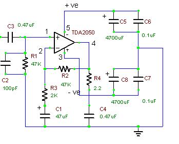

I've attached the circuit I've used with the component values shown on it.
The supply and supply fuse is shared between both channels.
I used 5 A slow blow because I had it . I've just changed it to 3A slow blow and it's working fine. I've used it about 4 hours now with the 3 A fuse and playing it pretty loud ( ocassional clipping).
This is a non inverting scheme and gain is +48 ( +33.6dB ).
So assuming a maximum theoretical 35 watts into 4 ohms , the input required would be just under 0.25 Volts.
Output is at pin 4 . The small +/- supply indicators near the opamp is part of the software package. You can ignore that.
Pin 5 is the +ve supply and pin 3 is the -ve supply.

what gain? 1+[47/2k]=24.5 (+27.8db)
Why the decision to set NFB to F-3db=1.7Hz and then filter the input using C3 to F-3db= 7.2Hz?
Where is the T fuse?
If, in the supply, then maximum continuous peak current into your 4ohm load is about 4.2Apk (35W). I have found that a supply fuse (after the main smoothing) of about half this value will allow the amp to run reliably. You could therefore try F2.5A or even F2A and see which does not suffer nuisance blowing.
I just lost a long reply. So here is a gist of it.
1. Sorry I made a mistake. The first amp had again of 48. The next one was as shown in the diagram = 28 .
2. The capacitors are so because that's what I had. I had only that value Solen to use and it sounded better than others I had.
3. The fuse should have been between the 4700uF and the rest of the circuit.
4. I have only 3A nd 5 A slow blow fuses at hand at the moment!
Thanks for pointing out the errors.
As it's shown the amp sounds good.
Cheers.

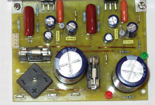

I added some LED's to indicate the presence of power , both before and after fusing !

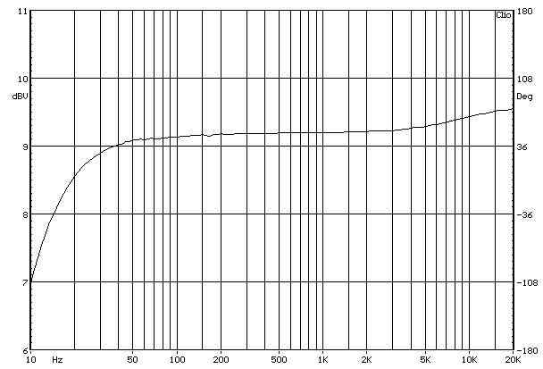

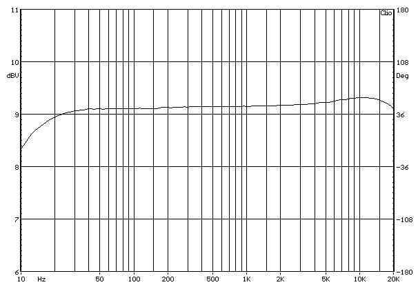

Today I did some measurements. The HF on this amp has a peak of about 1db or so at just beyond 20Khz ! I can only assume it's inherent to the chip. If I add a 39pf cap to the NFB resistor ( 47K ) it flattens it out and starts to roll off beyond 20Khz.
The peak is dependent on the speaker load . 4 ohm showing slightly less peaking. However the amp sounds fine and not 'bright ' because of this. I'll post some response plots later.
Distortion is poorer than an LM3886 but still quite low. I pulled out my LM3886 board to make some comparisons. The LM3886 is slightly better but not apparent on casual listening. The Lm3886 however has far more power ( with a dedicated 220 VA torroid ).
So that still means that the 2050 is an incredible bargain . The chip is one fifth the cost of a LM3886 chip . Today I measured the power output using a low quality 15-0-15 transformer . The output was only 12 watts into 8 ohms before the amp clipped due to a sagging power supply. However in listening tests the amp went pretty loud even with that.
Good tight bass too. Since my speakers are 8 ohm ( 88db/watt) rated they might be a comfortable load for the amp.
With less efficient speakers (86 db/watt ) the amp does lack a bit of steam if you want to play it loud. My 86db/watt speakers are also 4 ohms and so it adds to the power problem.
I'll post some measurements later.
Cheers.
Frequency response
Here is the response of the amp in stock mode.
Unloaded the HF peak was almost 1.5db and rising. With a 8 ohm load its still about 0.5db at 20Khz. With a 4 ohm load it is a bit less .

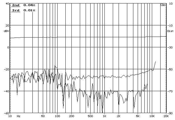

Distortion
Distortion at 1 watt with a 4 ohm load.
The picture gets clearer when you see the FFT . The 2050 has more harmonics visible than the LM3886 . That's probably why the LM3886 sounds cleaner . Not really too noticeable if you do not make a comparison side by side. By that I mean you listen to the amp without looking for differences.
