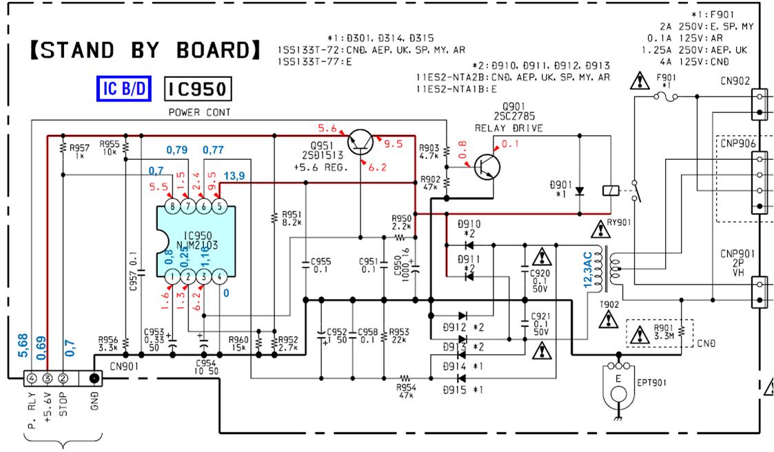

Hi.
This is what I read from the circuit.
All the DC voltages are measured from the Ground.
Transformer AC voltage is measured between the transformer secondary.
Standby board is disconnected from everything else.

If you have 1.8v on the base you will not see 5.6 on the output. You should be seeing around 0.7 to 0.8 across the base emitter junction in this state. Do you ? The transistor may or may not be faulty.
Just jumping in here... C950 would be a typical problem area. Unless you scope check the rails don't assume they are clean and correct.
Although the transistor is quite high gain I would think most medium power NPN such as a BD131 or TIP41 should be suitable. It may well be OK though.
Yes, I realise that 🙂 Although you measure 13.9 volts instead of around 9 volts that can't be taken as a guarantee that all is well and its high just because its unloaded. If there were excess ripple on the rail then a DVM reading is useless.
Also check R950, make sure its not gone open.
I can't offer a quick fix for this. If the passive parts are OK and the reservoir cap OK (it probably is OK but I would want it proved so) then unless you are 100% confident in checking the series pass transistor and interpreting the results I think you have to swap it out.
The IC isn't a regulator as such, its a reset generator that monitors the rail/s, although it does offer the facility to generate a user programmable output voltage. Only when all other possibilities are proved OK would I suspect the IC.

I was just looking at your diagram and voltages again.
Q901, the relay driver. Do you have 5 volts on the top end of R903 when you try and turn it on ? I notice you marked that line as 5.68 volts. If you do have 5 volts present on that line and the relay isn't firing then Q901 is faulty.
