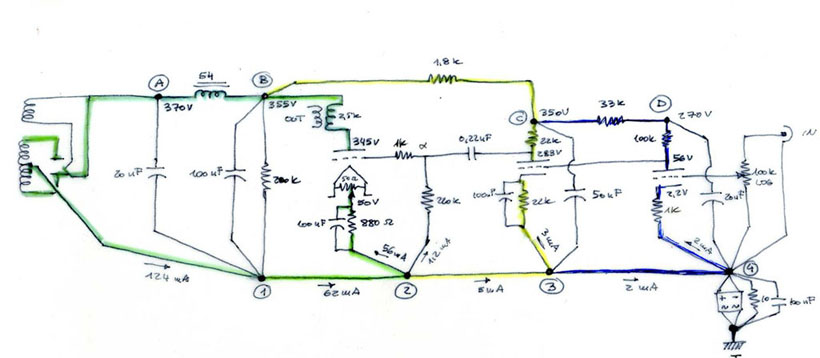

Thank you very much for your comments. I didn't have any tube guru either, but I learnt a lot from your posts, athos56, arnoldc and others! As the amp worked correctly at the first try, I havn't tried anything else. I'm specially proud of the low hum level (my first tube amp, a EL84 SET, hummed a lot) as I have followed the advice of SY and others concerning the ground (see the attached file), arranging the wires as if they were water pipes (I undestand hydraulics better than electronics)
