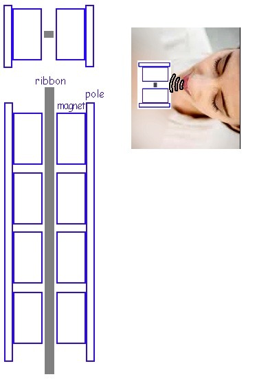

Another ribbon mic I made this one a little longer than my previous one and it uses a proper ribbon xformer.
I didnt want to use actual material they use in ribbon mics for the ribbon but it so super thin its very hard to use so I used ordinary aluminum foil.

I am intrigued by the positioning of the ribbon here - it does look unconventional or am I understanding this arrangement wrong?
Looks alright to me? With Alnico we have to use tapered iron poles to concentrate the magnetic flux of a large magnet to the small gap at the ribbon, to get best performance. With newer Neo** magnets we may not need the poles if we accept less-optimum performance.look unconventional or
OK. I just thought that when singing into it, you'd sing towards the corrugated surface and here it looked to me that wasn't possible as there are things in the way.

As I see it, the acoustic path is wide-open.sing towards the corrugated surface and here it looked to me that wasn't possible as there are things in the way.
Anyway: hold some small magnets up to your ears and listen to a singer. It is hard to block sound. In fact some microphones are little sealed boxes with tiny vent tubes.
I see it now: just victim of an optical illusion: I really thought the ribbon itself was facing to the left on the picture. Or old age is setting in firmly!
