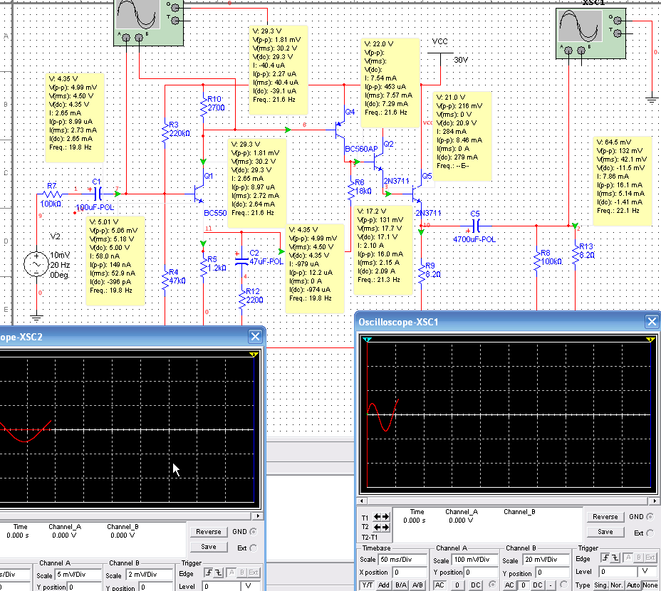

Hi hugh,
http://www.rudistor.com/sound-lab/ar3eng.htm
Whats wrong with above circuit ?
I see 330 ohms in parallel wasting signal AC voltage unnecessarily. Unnecessary heat is dissipated on those resistor. its a bad design i think.
Can we replace those resistor with current source?. I don't mind transistor dissipate the heat not the resistor. I don't like any resitor and capacitor on my Output Stage and Input Stage. As it distort signal.
let me know.
Alexk

Alex,
Yes, you can replace the three 330R resistors with a CC sink. No problem; this will give superior performance, no question, as the output transistor will then operate in constant current, rather than vary with signal.
HOWEVER, this is a headphone amp, and signals will not be all that high in amplitude, perhaps 5Vpp at the very most.
Thus the current variation will be low anyway, and the worsening of distortion minimal.

Again, you seem to be missing some basics. Resistors and capacitors distort, but transistors do not? What mechanisms do you think are responsible for distortion in amplifiers in general?
Without these basics I don't see how you could feel qualified to judge how good or bad the design is. Subjective evaluation of how something sounds is one thing, but there is very little subjectivism about the vary basic laws of physics - unless you are capable of creating your own universe 🙂
The amplifier you linked has several problems, one of which is trying to drive a 32 ohm load with a 110 ohm output impedance. Fortunately, this is not a major issue except for the fact that it is very inefficient and produces a hump in the frequency response at the resonance frequency of the headphones.
Second, the power devices used are not well chosen for the application, but again, it will work - just not as good as it could.
Changeing the resistors for a current source is not a good idea unless some form of NFB is added. As far as efficiency, it will be the same with the resistor or the current source - either has to dissipate (standing current times half supply voltage) Watts of heat. Wether it's a resistor or a current source makes no difference. What would make a difference, would be an inductor, but then again you need a different circuit.
The heat dissipated on those resistors is necessary because otherwise there would be no way to get an AC component out of the amplifier. The transistor in the output pulls the output in the positive sense, the resistors in the negative - to have AC you need both ways, a positive and negative going signal. No resistors, no negative going signal, no AC. It's a different matter altogether what alternatives we have to resistors.

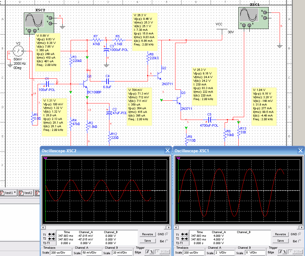

I will make a design in which all ac signal will be on the load(speaker) not on some resistor and getting wasted.
Instead of resistor , transistor may dissipate but it does some other job than just dissipating.

Boxedin,
The circuit is not ideal; I believe it would be better to use a high current IC, like the OPA134. These will drive more than 50mA, and the standard opamp configuration would be fine here, and with a bipolar power supply, + and - 15V, you would need only one cap in the entire signal chain.
The Rudi Stor circuit has many, many faults. Another is the gain structure; for a headphone amp you do not need this gain, which is presently around 47K/220R, a ridiculously high figure (220)which would very quickly overload the output with an input measured in millivolts. You probably only need a gain around 10 at the most, or 20dB.

Ilimzn,
I do you discredit; my apologies! I have neglected one thing; that the impedance of the output stage is indeed 110R on negative going pulses; not so for positive, of course.
Using a resistive emitter load, the current drive is feeble at the peak of negative going pulses where there may only be a coupe of volts across the 110R. A CCS corrects this, of course.
Furthermore, a 32R set of cans would need much more than 14mA of current drive. You'd probably go as high as 40-50mA, in fact.

Can you tell me the following please regarding your circuit:-
1. How did you determine that there was NO distortion ?
2. Have you analysed for inter-modulation distortion ?
3. What is the frequency response of the amplifier, in particular at lower frequencies - i.e. below 100 Hz ?
4. How stable is the dc operation with change of temperature, device and component tolerance ?
5. Why are you using a BC109BP for the input, this device is a VERY low noise BJT, usually reserved for the front end of amplifiers e.g. disc input circuits, it would seem to be wasted here, and a BC108 would probably be totally adequate.
Richard: whazzat:
Richard: whazzat:
Actually i don't like that circuit for many reasons. It was posted circuit and someone told me they built it and he liked it. I took that circuit and analyzed it.
I modified that circuit to this. This one i can increase the sensitivity to any level 0-100 mv to 0-1 v. WIde range. with Ac resistor i can change the voltage gain of first stage to adjust sensitivity.
Try simulate it and tell me.
More questiosn follow.
Here is the circuit in 20hz 10 mv input and 20000hz 10 mv input.
boxedin said:Actually i don't like that circuit for many reasons. It was posted circuit and someone told me they built it and he liked it. I took that circuit and analyzed it.
This circuit does not need simulating to assess the problems.
The TRIPLE darlington in the o.p. will be extremely unstable as shown, - if the leakage current through the frst of the devices increases by (say) 1 micro ampre, and the three transistors have gains of (say) 50, the current through the second will be increased by 50 micro ampres, and the third one by 2.5 milli ampres !! This is not an acceptable increase.
I further ask again, the most important question from my previous message,
.How did you determine that there is NO distortion ?
This is an important point, as one of the prime objectives of amplifier design is to reduce distortion
