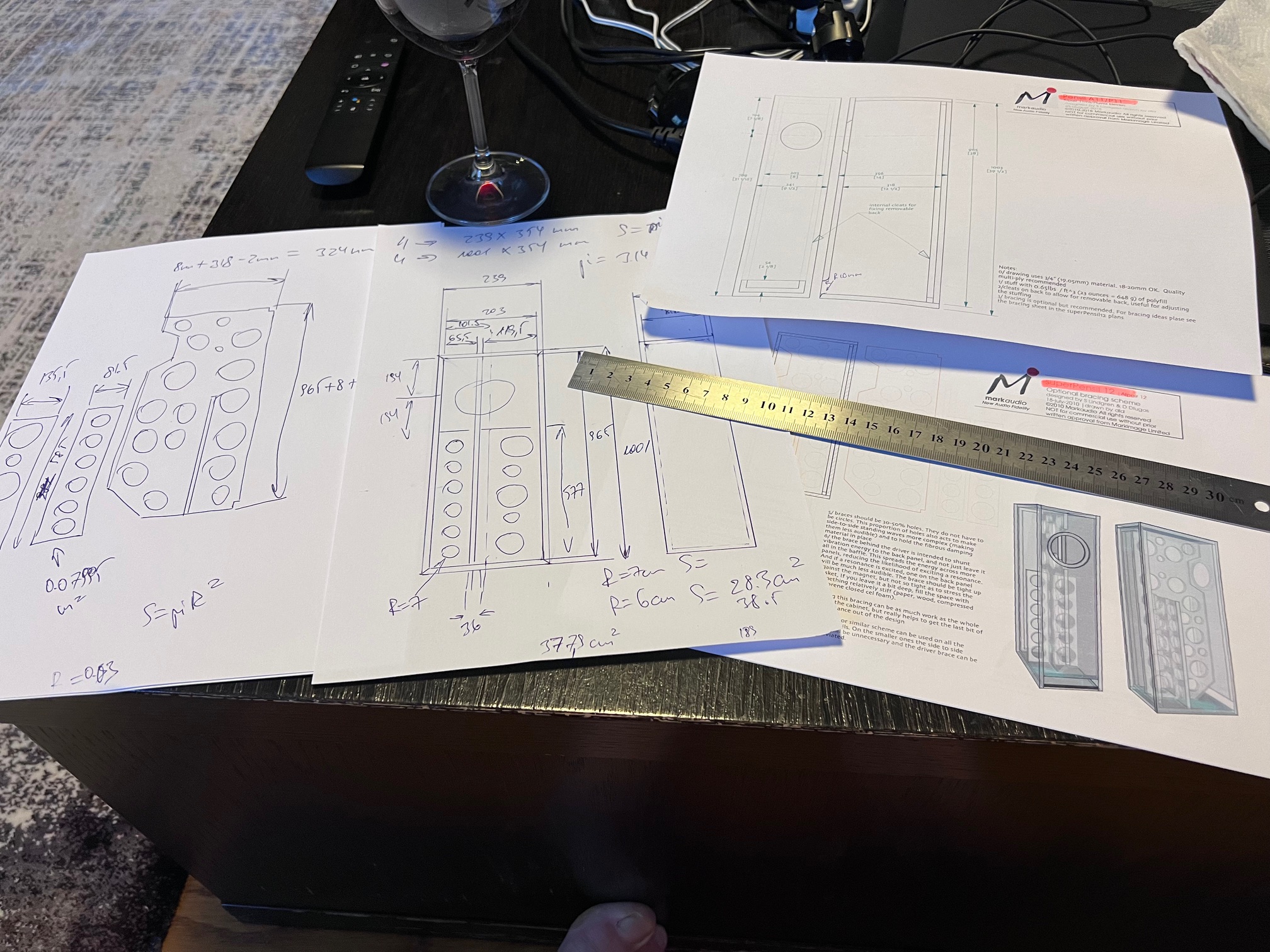

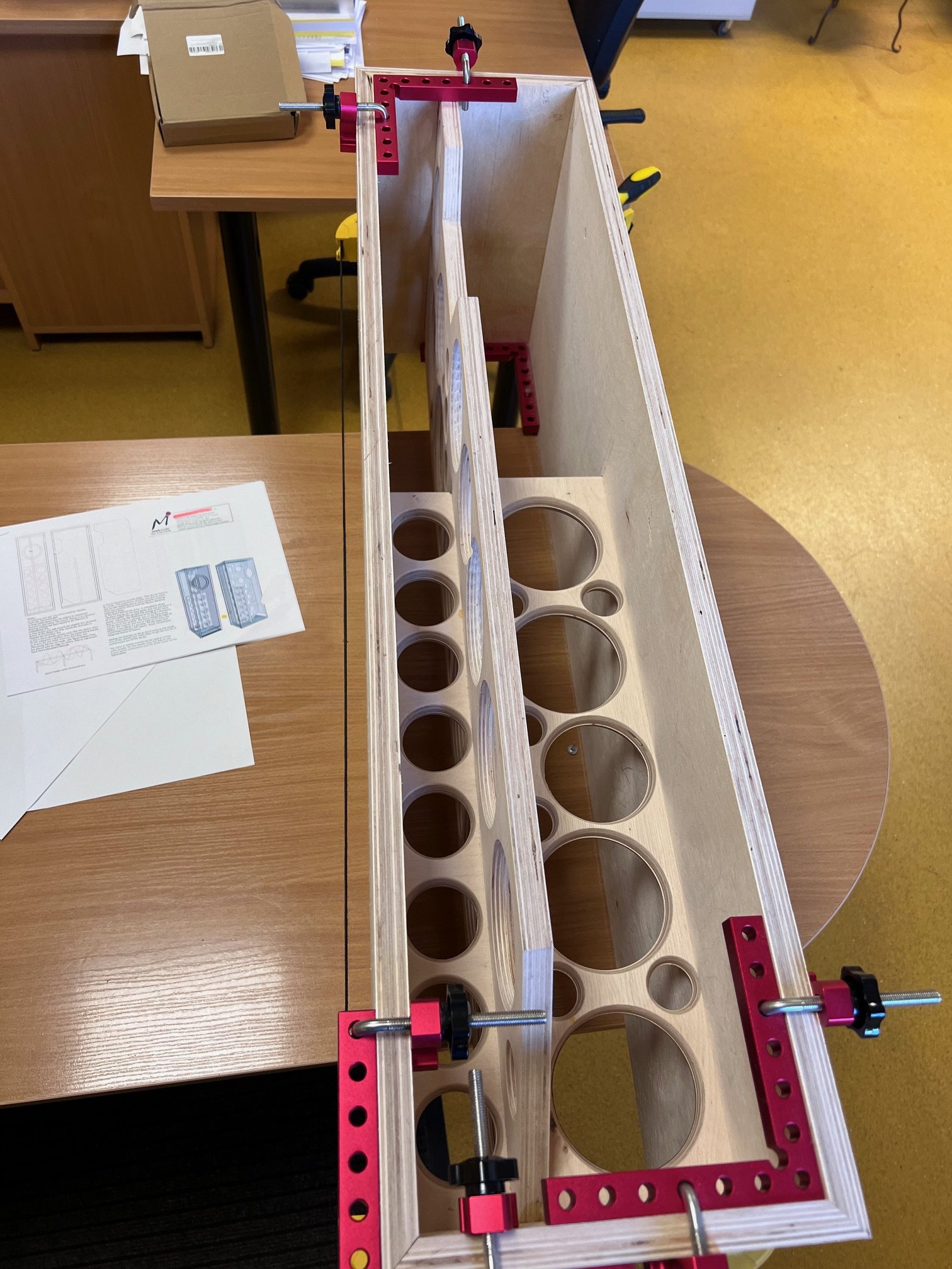

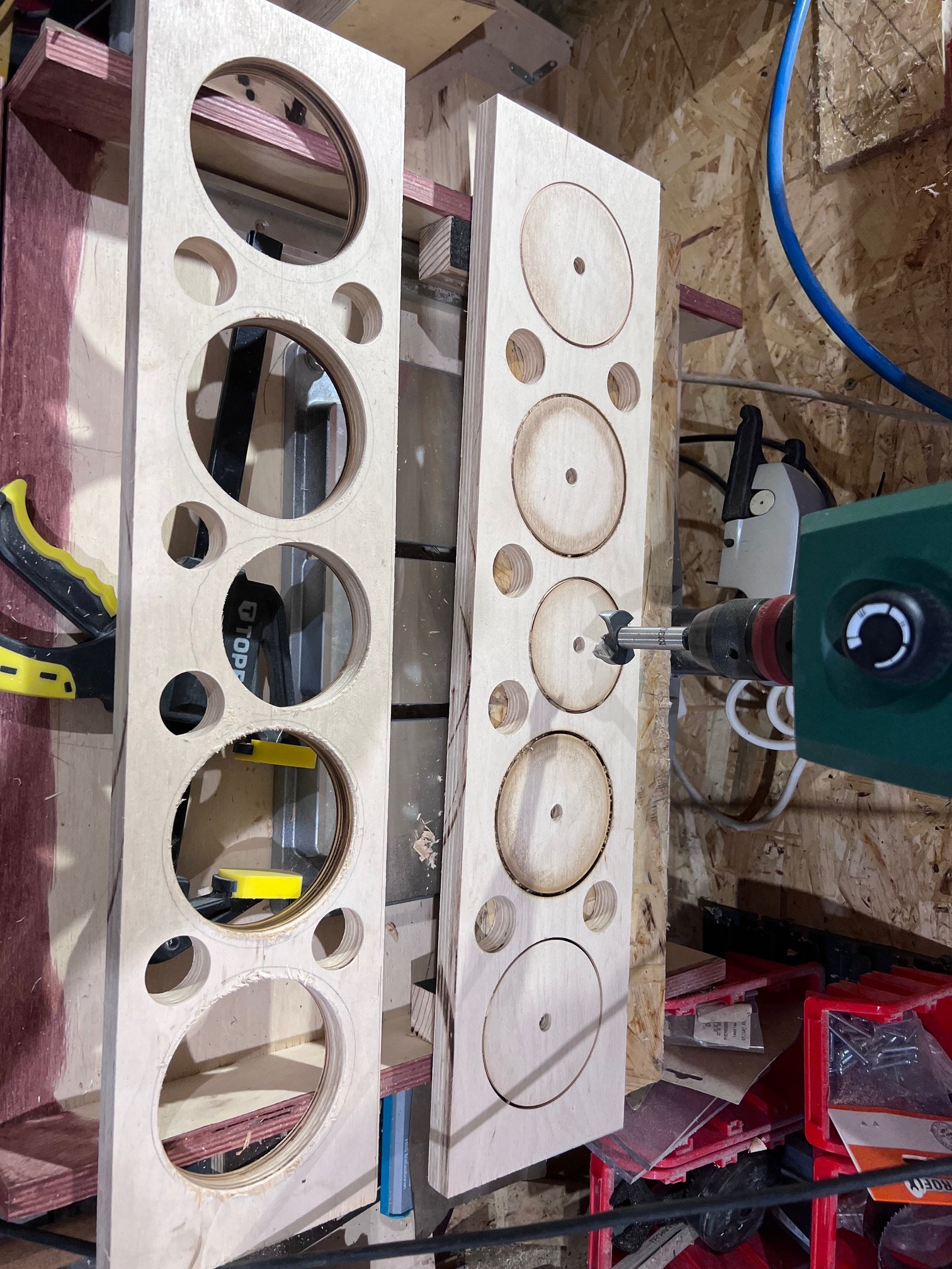

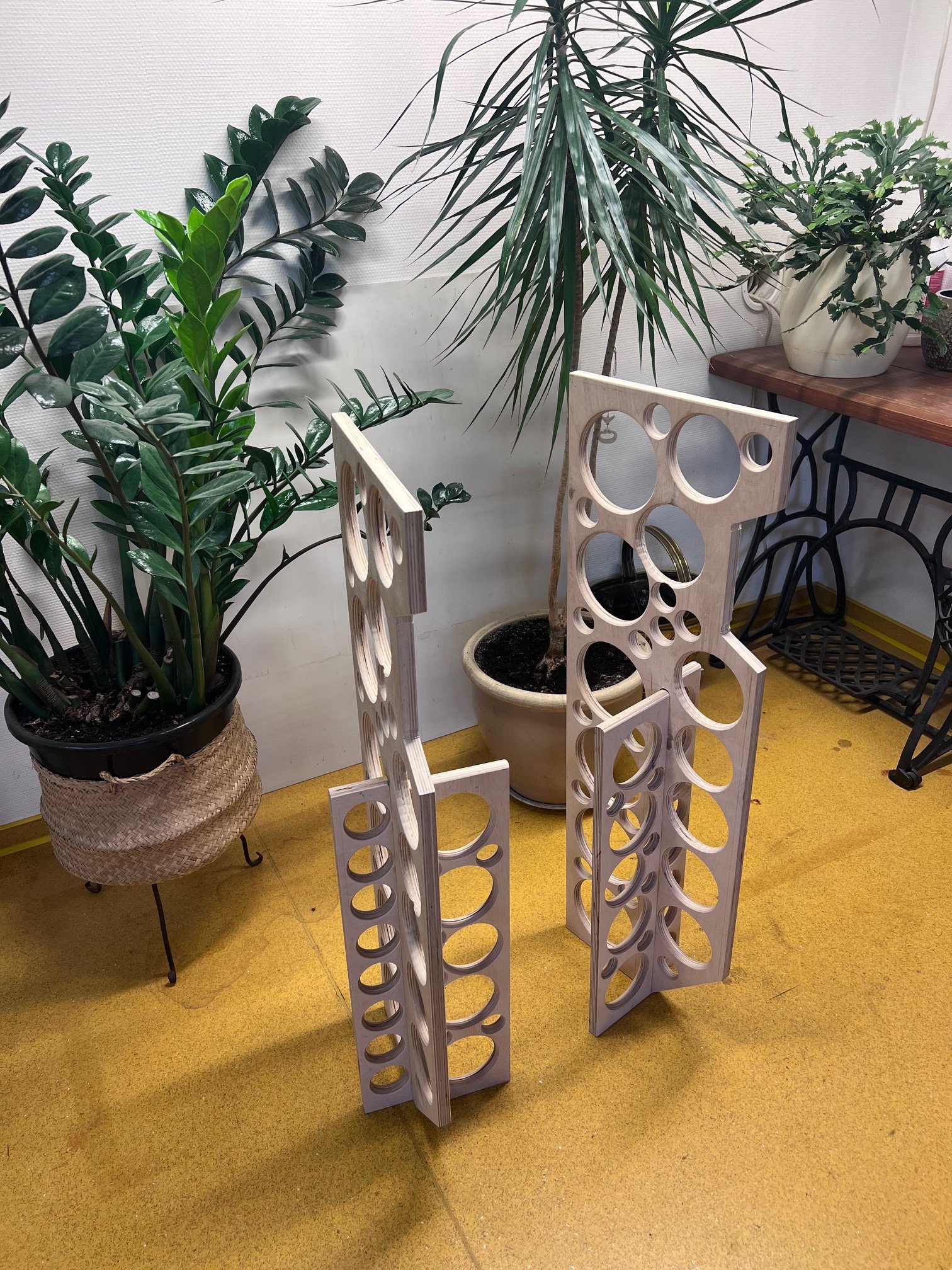

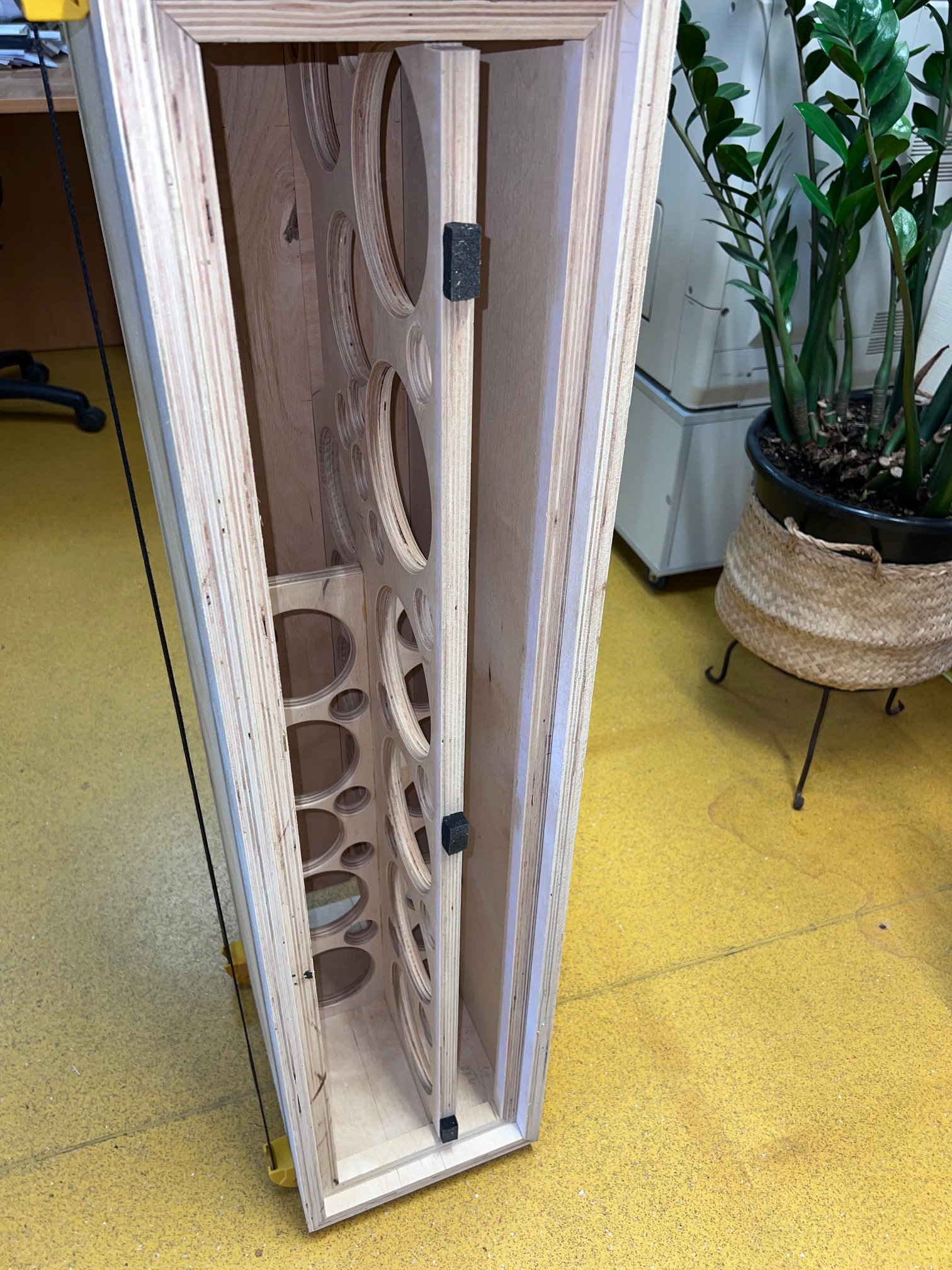

After spending a lot of time reading the forum, I started my first speaker project. I want to build Pensil P11 with Mark Audio Alpair 11ms full range drivers. As a first such project, maybe a little too complicated, but I hope I can do it. I probably won't write anything new, but I hope to receive some valuable advices from those who have already done it. Woodworking skills are very limited, so mistakes are very likely. I hope others can learn from my mistakes and avoid it in own projects. The materials I have are 18 mm plywood. Not the best (III/IV quality), but it is what I have. All the panels are already cut out, the internal bracing with holes was copied from superPensil 12 plans. It remains to be glued. For the final version, I plan to veneer the enclosure. But for now, the first question is whether it is necessary to strengthen the gluing places with sreews or nails. Will the glue be enough? Of course, there will be even more questions, how to stuff, how to make some adjustments. I plan to do some measurements with UMIK-1 and REW, but that is in the future. For now, here are some pictures of how things look now.

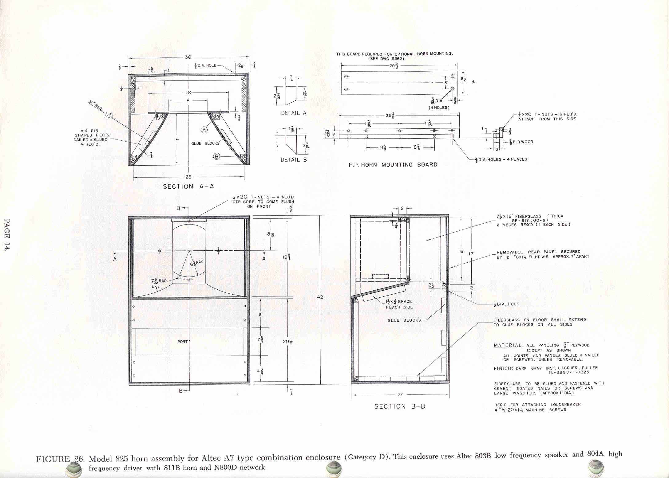

No! Reduces strength, so use glue blocks if you feel the need. Note Altec used 3/4" cove moulding cut from scrap to brace a ~260 lb speaker, so obviously other shapes/sizes that's at least this large is fine.first question is whether it is necessary to strengthen the gluing places with sreews or nails

Thank you, good idea! Moldings also will round internal corners.No! Reduces strength, so use glue blocks if you feel the need. Note Altec used 3/4" cove moulding cut from scrap to brace a ~260 lb speaker, so obviously other shapes/sizes that's at least this large is fine.

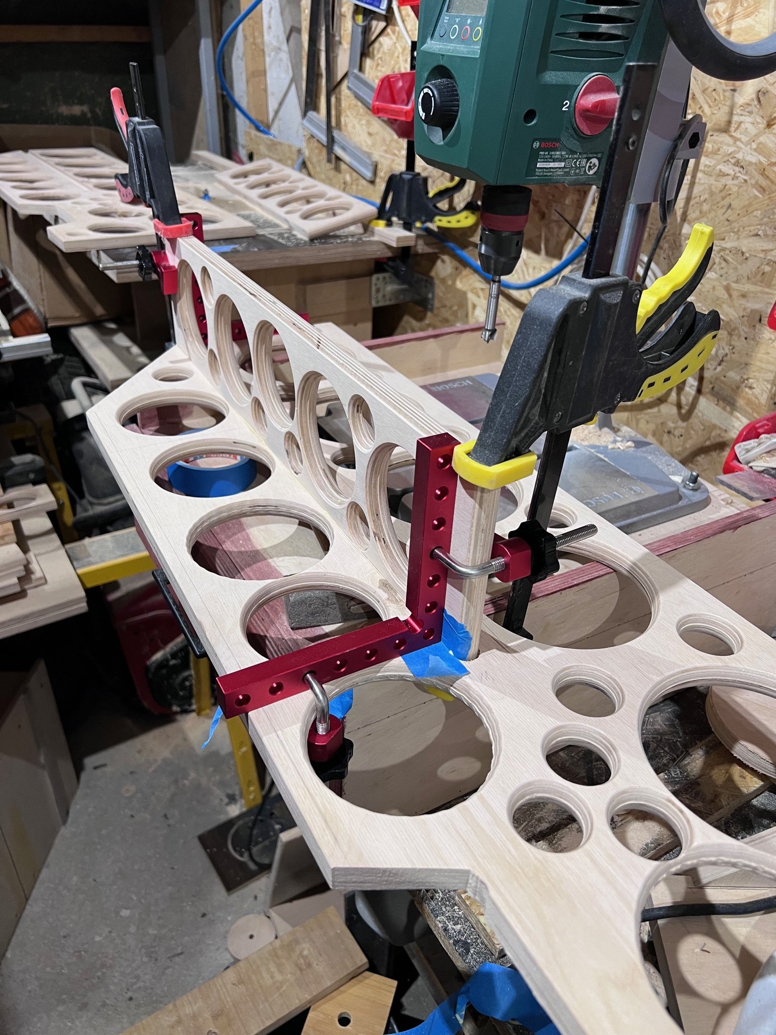

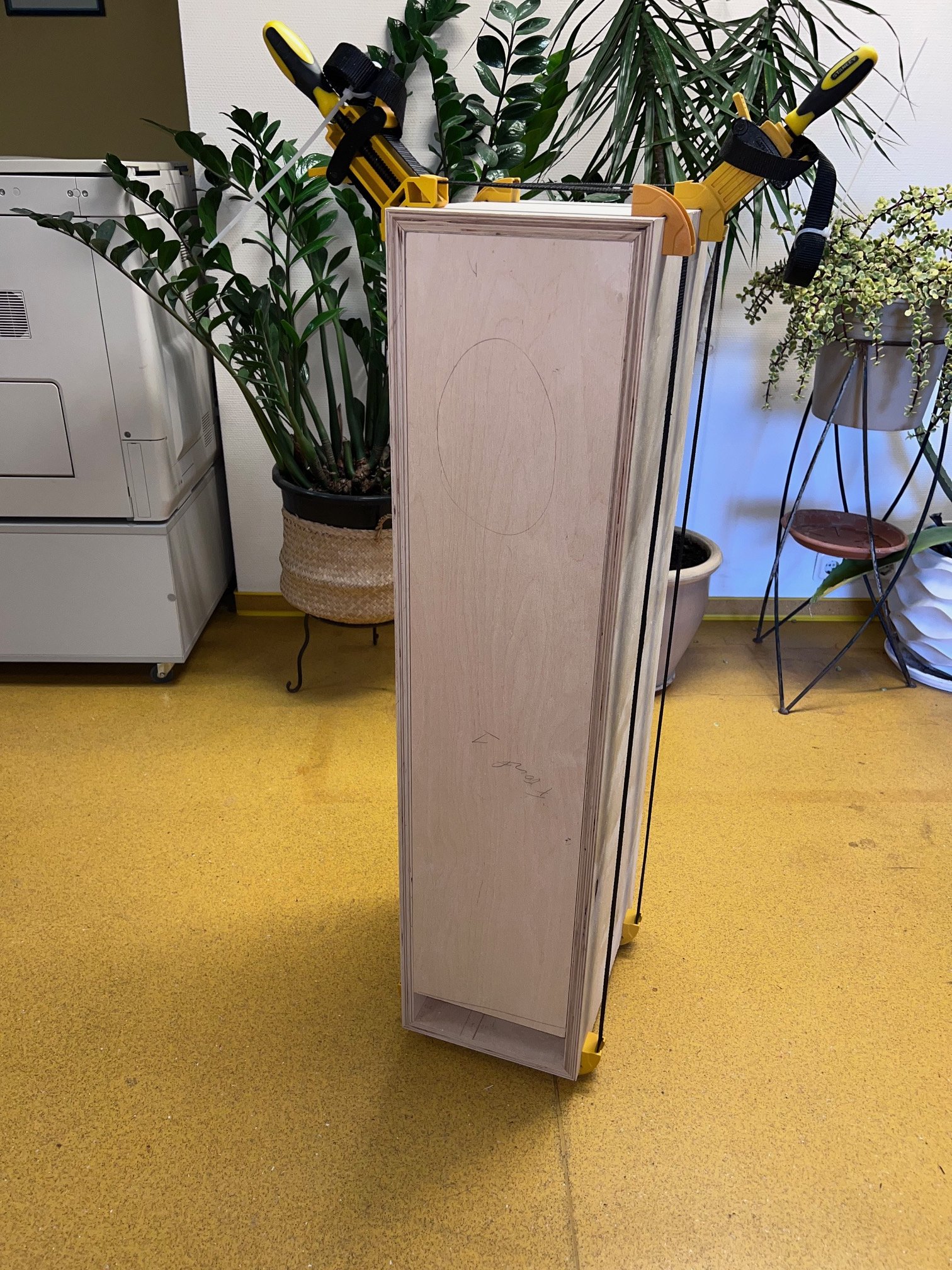

Where would one find those burgandy colored square clamps and the yellow cable type clamps. I don't believe I have ever seen these type of wood working clamps in any of the wood shops around where I live. Thanks,
MM
MM
Square clamps from Aliexpress, just look for "Right Angle Fixing Clip 90° L-shaped Auxiliary Fix" and cable type clamps from local store.

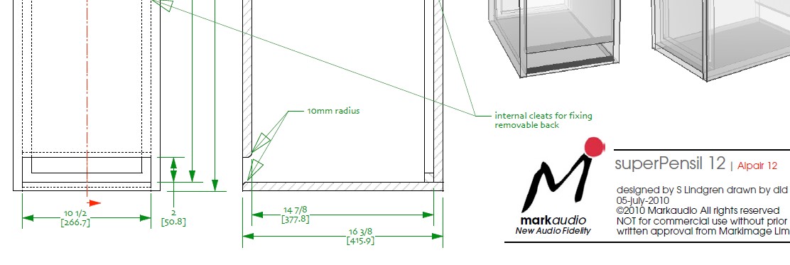

On superPensil 12 plans I see some rounded edges on the port:
Should I do the same on Pensil 11? Maybe I can cut it just at 45 degree angle like Sibelius? Bottom part will be visible and I am thinking that I must to veneer this part before everything will be assembled. Probably with a round corners not so easy. Well, veneering probably also not the best idea but so far I do not have high quality plywood or solid wood 🙁

Neither is necessary & won't bring any benefits, but nor would they do any harm either, so you're good to go whichever you decide on.
