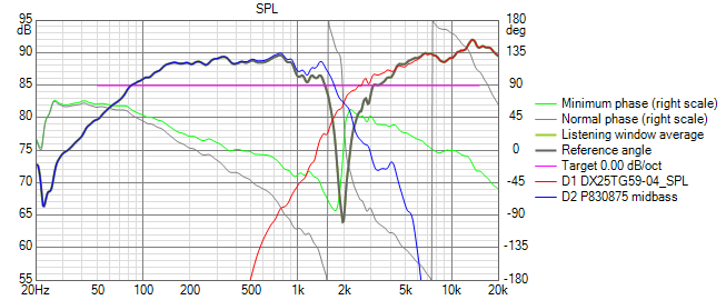

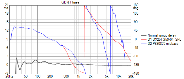

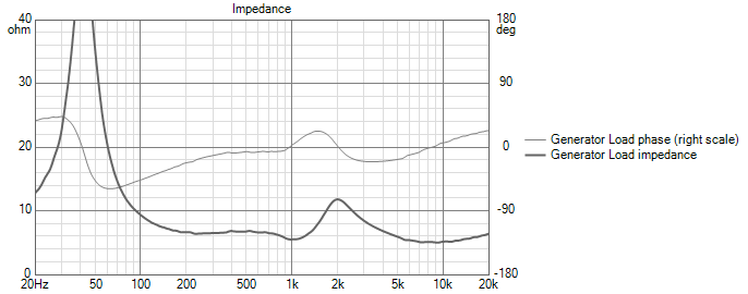

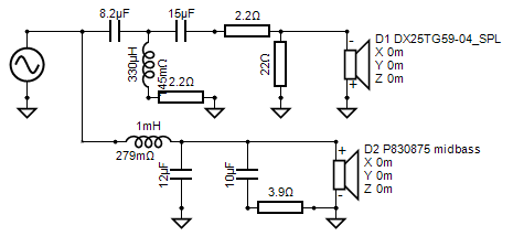

the Madisound service is no longer available but there is wealth of past crossover designs available for diyers. I have been fiddling this past month with vituixcad and shall try a xover p830875 and xt25.
Here a first trial. I invite any improvement.
tks

Dave, may I have your suggestions regarding components values for bsc. I lack experience in the bsc field .To reach the above design I have analysed dozens of known xovers and prceeded by trial and error. I have used simulated infinite baffle Frd and zma using vituixcad Splgraph
