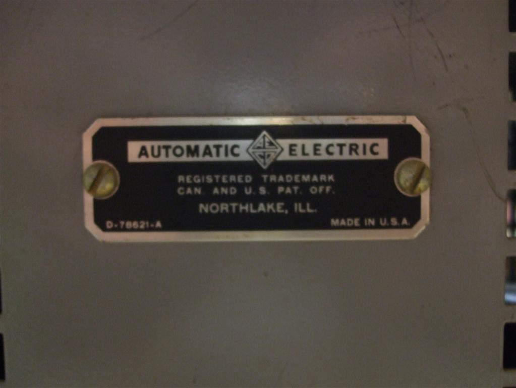

Model D-78621-A

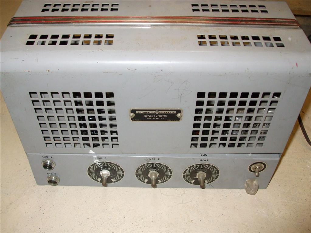

I was given this amp by a good friend of mine. It's from a large retail store. It's built in Illinois by Automatic Electric. I haven't been able to find any information at all about this amplifier. I can find all sorts of info about Automatic Electric but nothing about audio amplifiers. They built telephones mainly. This could have been a PA amp or maybe an amplifier for some sort of internal telephone system. It has 3 large relays in it and 2 mic inputs up front. The mic inputs lead me to believe it's just a PA amp but the relays have me stumped.
It's in very good condition and probably worth a bit to someone who collects old telephone equipment but it's a nice parts find for me. 7 octal sockets and a power transformer anyways. There's 2 transformers that could be wired as single-ended output transformers. Good for a few watts maybe.
It's mono and contains the following tubes.

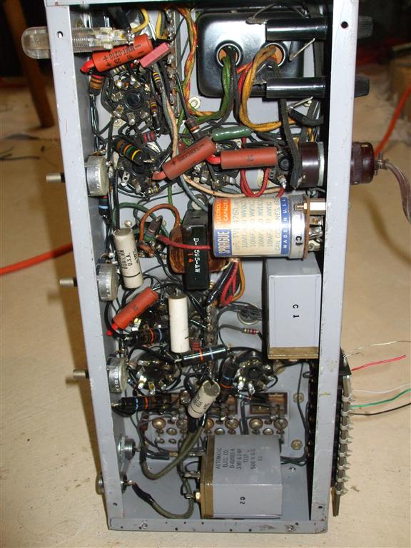

Yikes! That's a rat's nest.
You can say that again. All the wiring is the same shade of black. 🙄

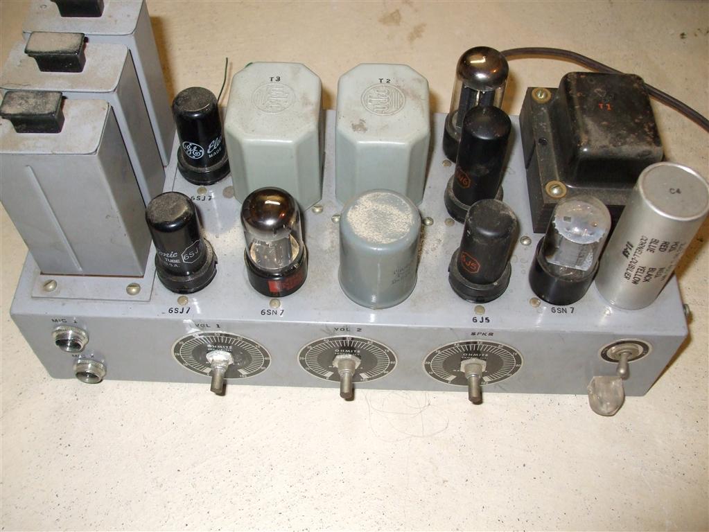

Looks like some UTC output transformers, very sweet!
I looked around in there for awhile and I don't think those are output transformers. One has 3 wires coming from it and the other has 5. I think the output transformer is that round thing in the middle in front. It's not a capacitor. It has posts on the bottom labeled 1-8 and seems to go to the terminals in back and wired to the 6V6.

I'm only guessing but I believe that this has a 600 ohm output. It was probably designed to feed a power amplifier.
A single 6V6 won't produce enough power to be a PA amplifier. The little round thing at the front of the unit looks like a microphone matching transformer. It is certainly not an audio output transformer.

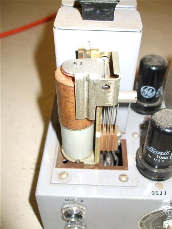

I sorted out some of the components. The two large transformers in the middle are one choke and one output transformer. The output it tapped at 500ohms and rated for 10w. Not much for a PA but fine for intercoms. The round transformer must be a matching/mixing transformer for the 2 mic inputs. Of the 3 large relays, the middle one has to be pressed to turn on the output. The front one partially mutes an input on the back but left the mic gains up. The third cuts the audio completely. There's an input on the back I'd guess for background music at speaker levels. I'm stumped on how the relays are activated.
Of the 8 terminals on back:
1 and 2 (audio in)
3 unknown
4 common for relay coils (ground?)
5&6 500ohm output
7&8 500ohm output (parallel with 5&6)
The 3rd pin could be for signaling the relays but I have no clue how it would signal all 3. Does anyone know how these systems worked? It's more for curiosity sake then anything.

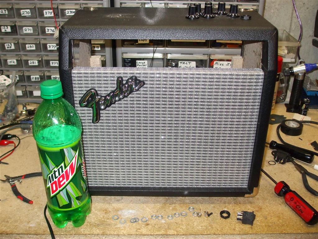

I have a good power transformer, tubes, output transformer, and misc other parts and sockets. Today I found a newer Fender 8" practice amp at a music store for $40. It's modeled after the older Fender amps like the Princeton with numbered knobs and the gray/silver grill cloth. I think I'm going to gut it and make a mini tube practice amp out of the parts from this intercom/PA amp. I might look for an old Fender schematic to base it off of. Might be a fun project! 😀
3rd pin was DC in to activate the relays. Took awhile to trace. They are delay relays. One activated the other activated the other. Weird setup. The muting relay is voice activated when someone starts speaking on the mic. Interesting little amp... that is now gutted to serve my tinkering.
