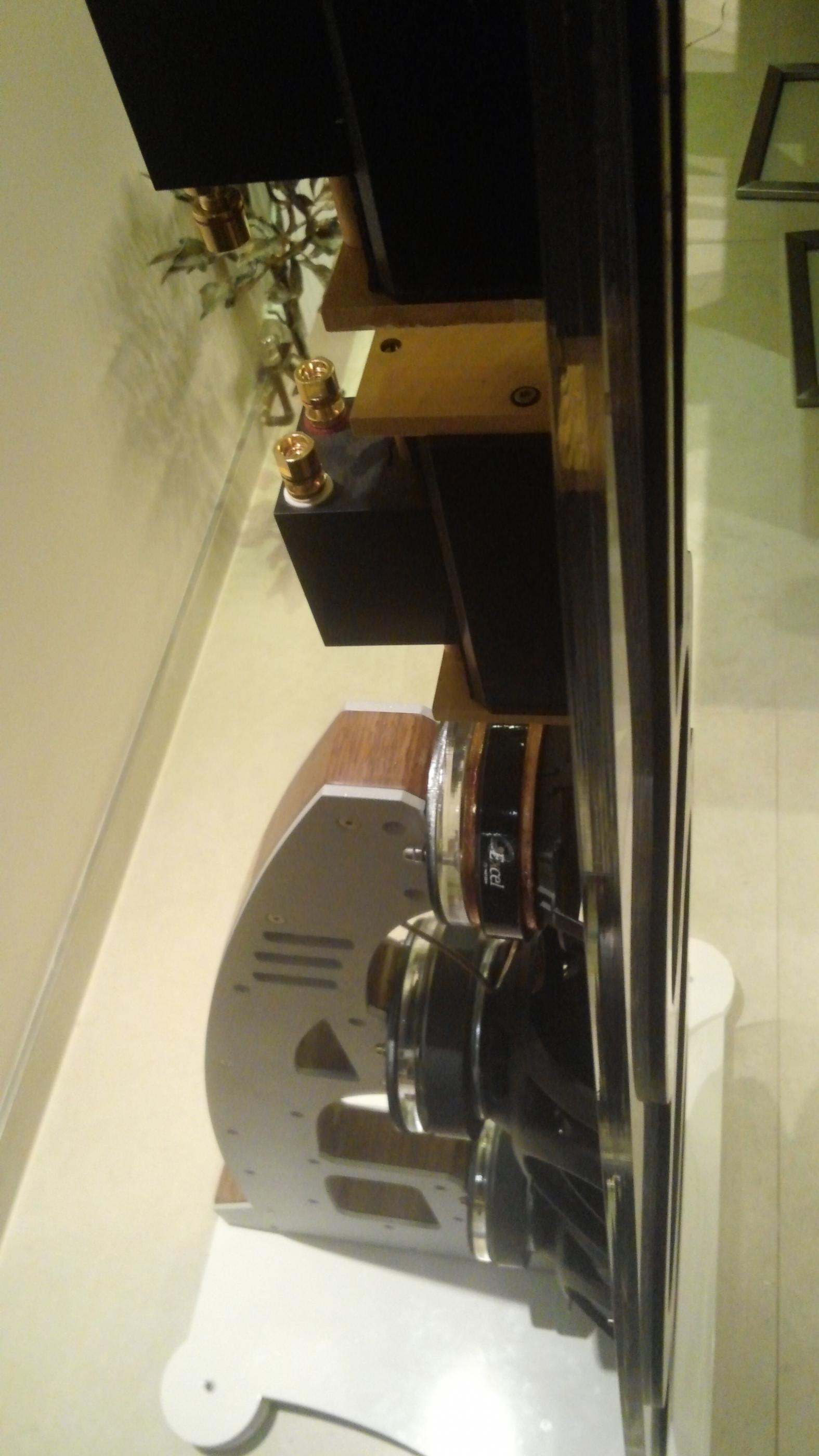

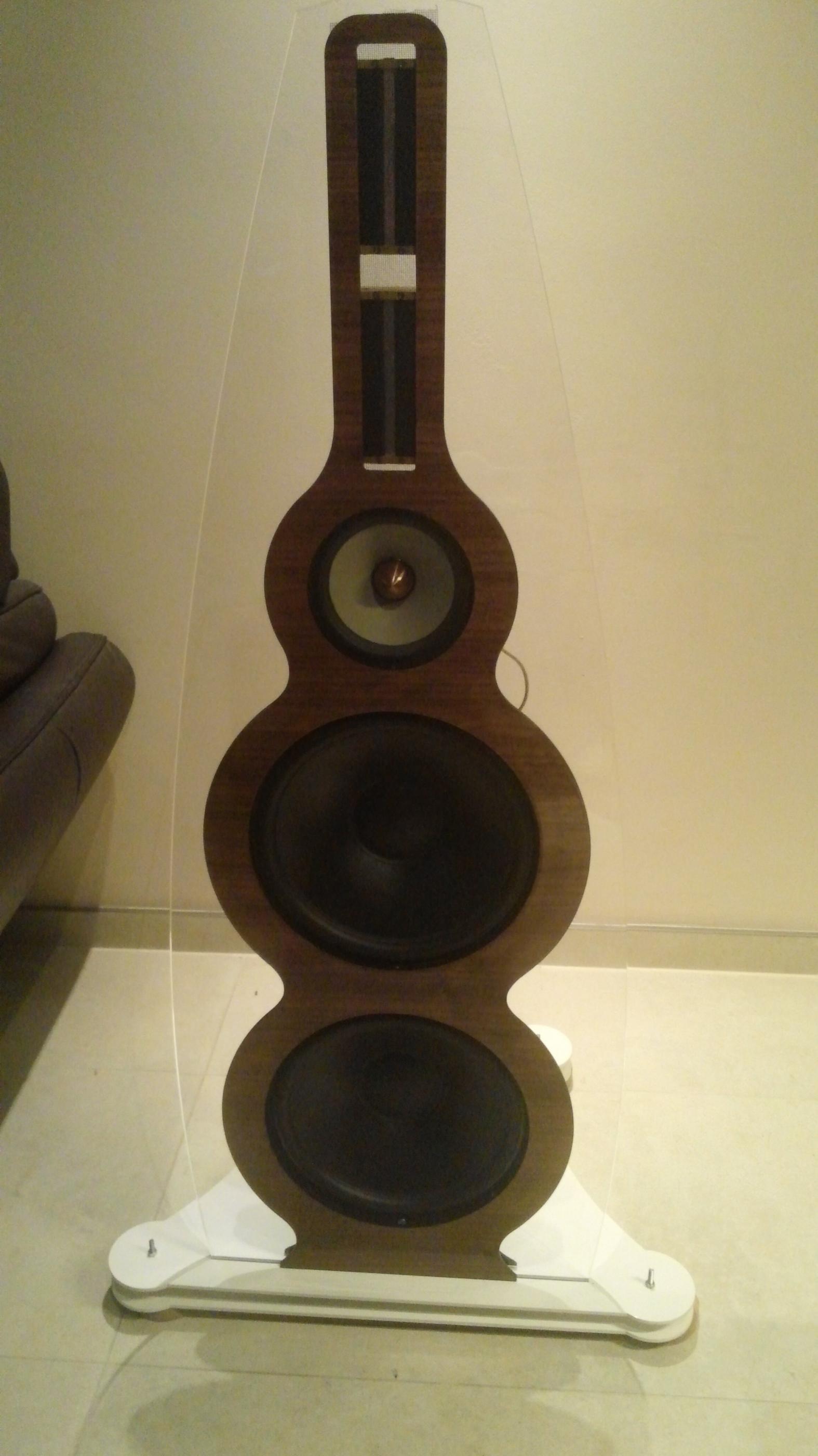

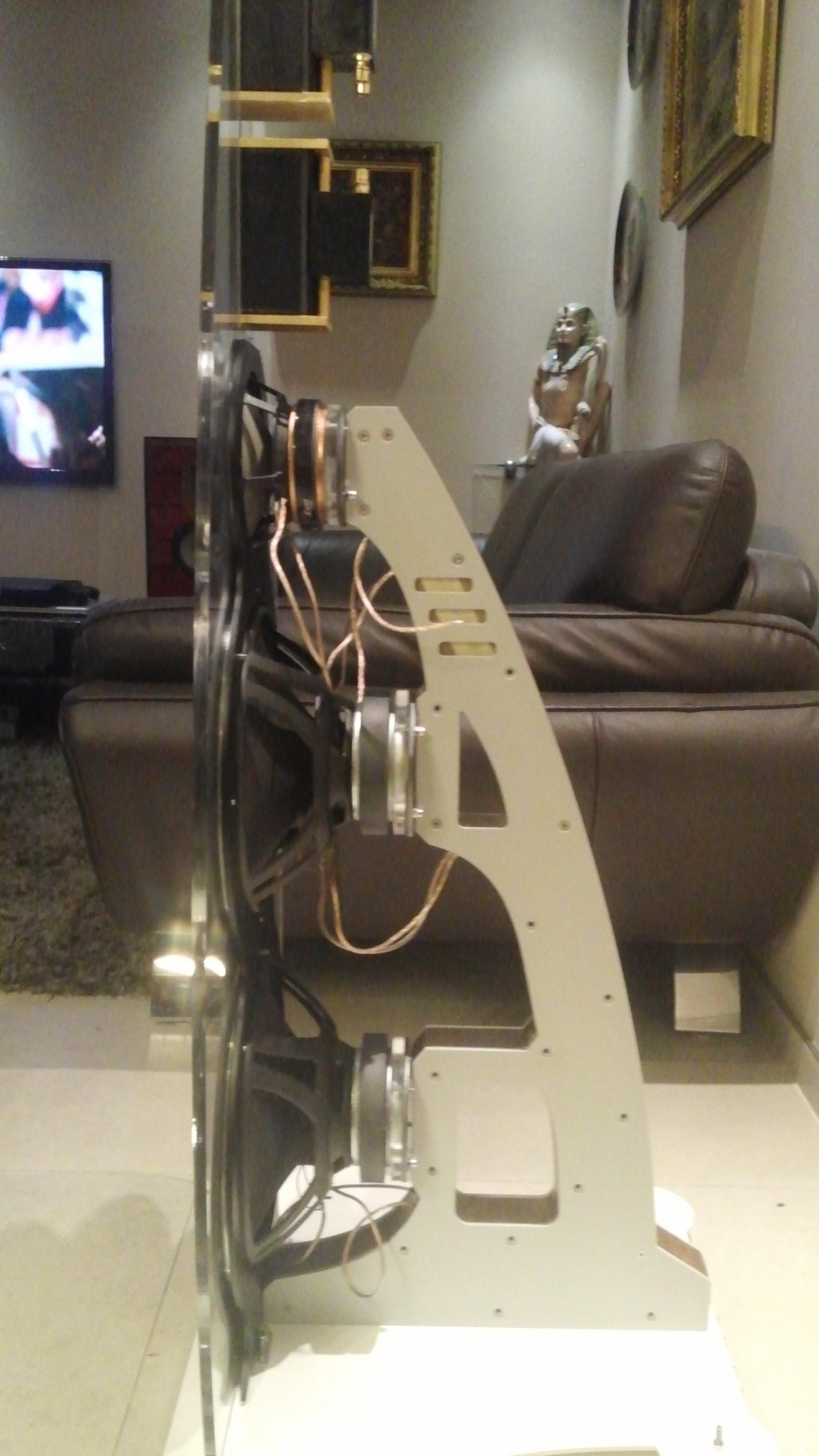

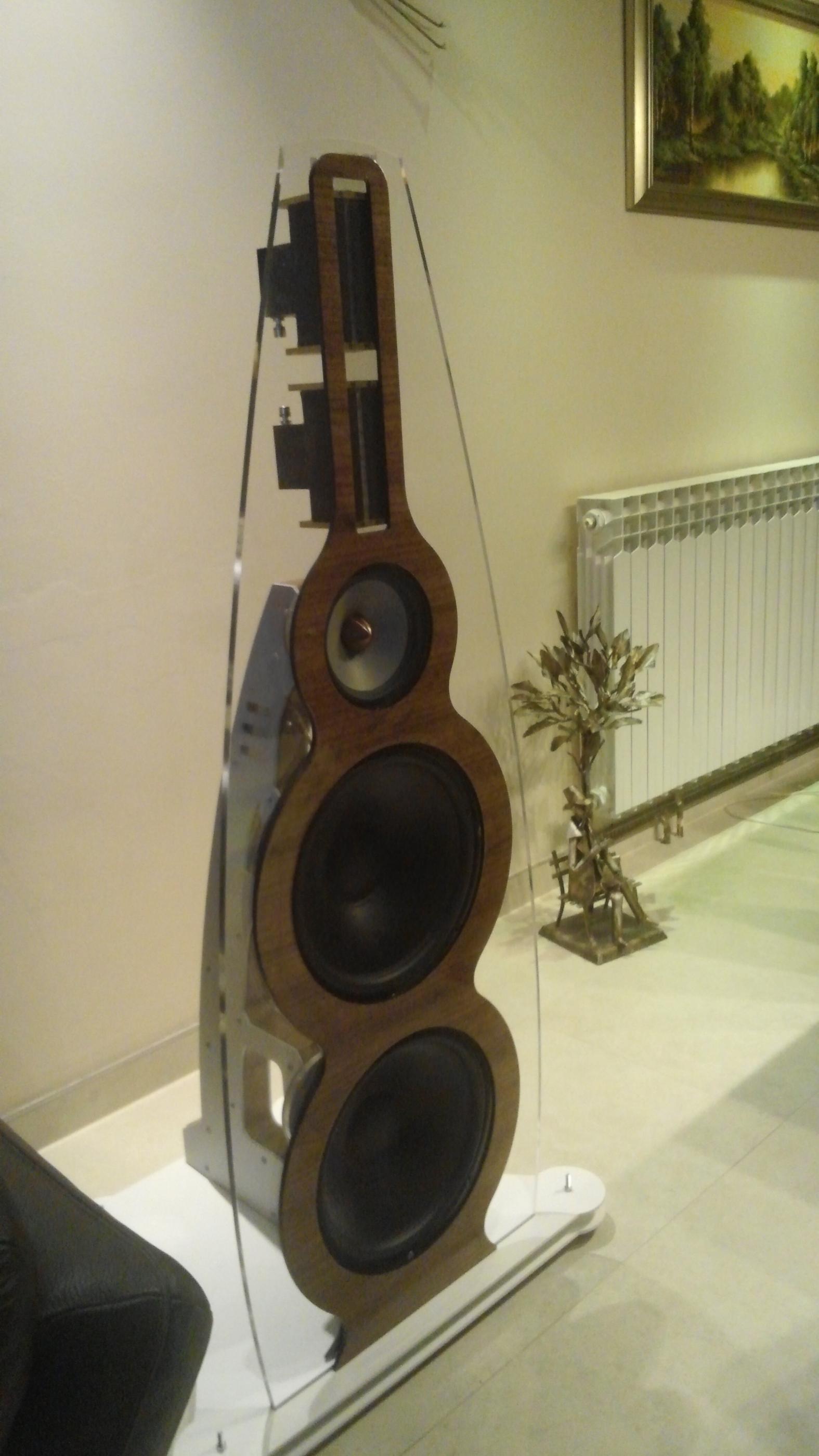

After several months design and construction one loudspeaker is almost finished. Speakers used Peerless SLS 12", Seas Excel , Own Ribbon 30cm long design. Temporary 2 Ravens are used instead.

Very nicely done. The transparent baffle is very well integrated and the excellent craftsmanship is evident throughout. Nice job. Looking forward to some measurements as you work on your design---mostly so I can learn from your efforts.
Few
A beautiful expression of the inherent nature of the cone drivers analogous to buildings that show their bones, like the Pompidou Centre.
But.... I think the way most people think about OBs is mistaken because in a room, their FR really does not suddenly "fall off a cliff" below a certain wavelength due to cancellation of phases. A textbook example might show a simple diagram of a circular baffle with a single driver in the centre and never the results of a complex shape like in this thread.
But but, you do need some bit of baffling to ensure some amount of rear wave is propagated out the back and to the rear walls, and that may be a bit more than in this beautiful speaker provides.
Ben

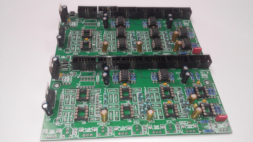

Hi
in this moment I'm using Behringer DCX-2496 but also I'm building Elliot Sound product LRX424 Project125. Maybe latter all change with mini DSP or similar.

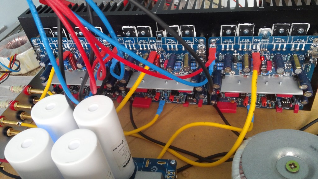

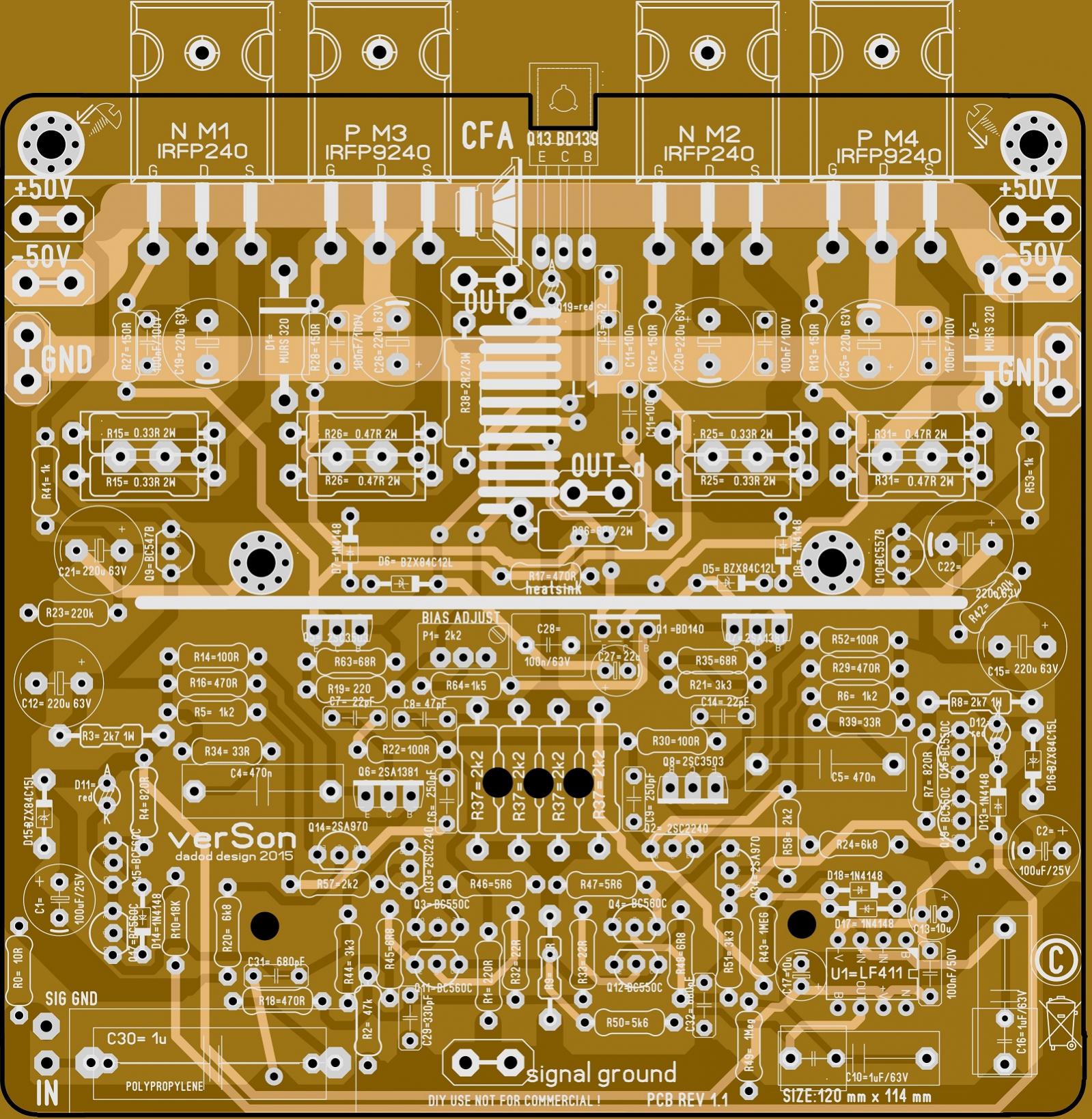

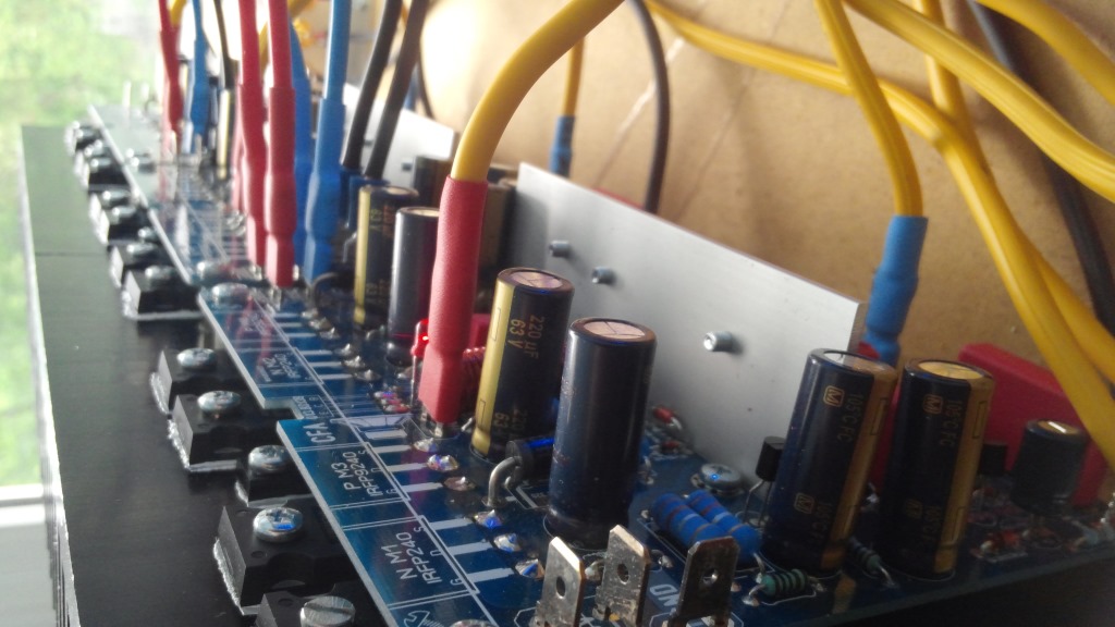

For amplifier I'm also building this project located here:
http://www.diyaudio.com/forums/solid-state/243481-200w-mosfet-cfa-amp-98.html
I have not made measurements because my own ribbon is not ready.
It is not easy to be in 3 projects in the same time. Therefore it is very slow.

You should try one woofer at a loud 80 Hz with a generic amplifier for testing only (if there is rattling noises)... IMHO 😉
The only improvement that I can envision is to reduce the baffle width around the midrange and tweeters to as little as possible. This will improve the off-axis response by making it very similar to the on-axis response but down a few dB.
For the woofers, there is no way you can get loud, low bass with the width of the baffle you are using if you go with a dipole configuration. You might think about a sealed box subwoofer for the lowest frequencies (e.g. below 60 or 80 Hz). This will reduce the excursion requirements for the woofers significantly, meaning you can get them to play louder within Xmax. This will reduce strain (distortion) and provide good low end from the sealed sub.
IMHO you should not worry about SPL (but a lot more about the THD), i've got only one 18' sub without any baffling for my whole listening room and it's more than enough (thanks to room gain).
My real worry with this design is the ability of the drivers in the 60-100Hz range particulary around 80Hz... the drivers should deliver only very very few sound pressures in this range.

Having heard the Granada open baffle speakers with twin 12 inch drivers crank out a great live performance jazz organ album, I have no doubt that our friends system here should be able to do very well in the 60-100Hz range. In fact it looks like a great system that perhaps would benefit from proper room placement (i.e. treatments for early reflections) a bit of dsp shaping and a subwoofer for the very low end. It may not be the ne plus ultra of all systems but give the guy credit for making a real work of art.
