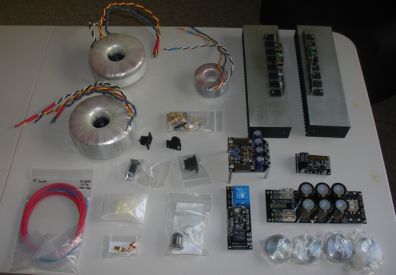

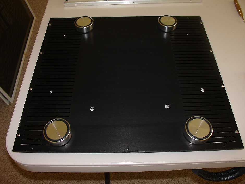

I've been gathering the parts for over six months (buying things as budget allows). I finally had everything I wanted but the case. I wanted to put the heatsinks inside the case, so I had Parmetal make me a custom sized case. It turned out looking a lot bigger in real life than in paper...😱
I debated whether to build the amp or rent the case as a small apartment to a graduate student.
But I finally got the case late this week. Work has gotten very busy so this will be a slow build. But here's the photos of the case and the parts.

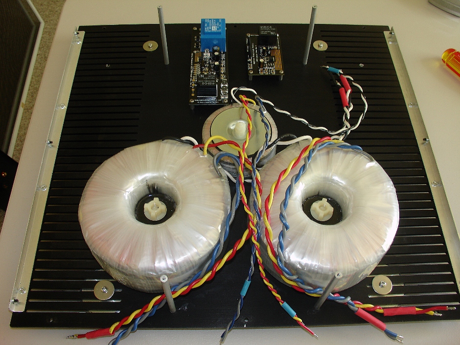

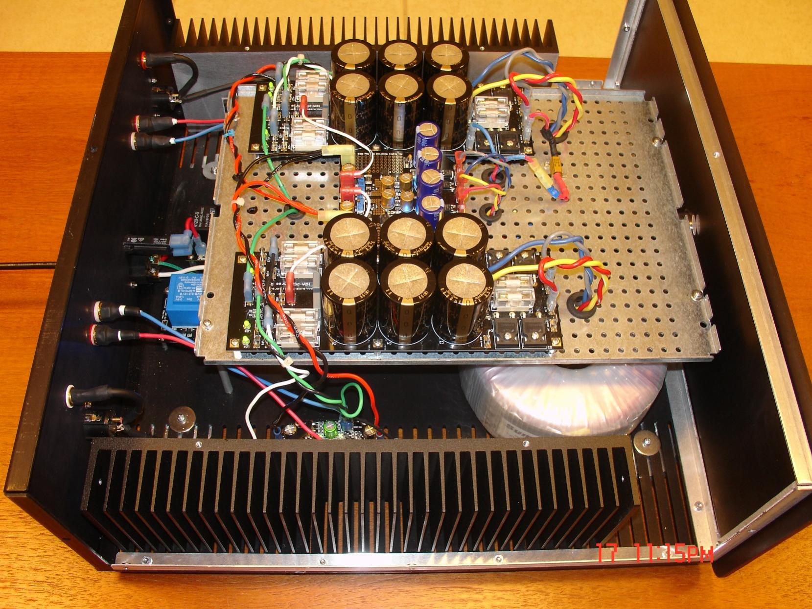

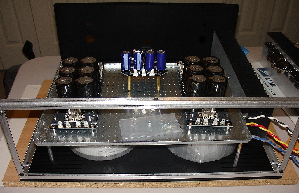

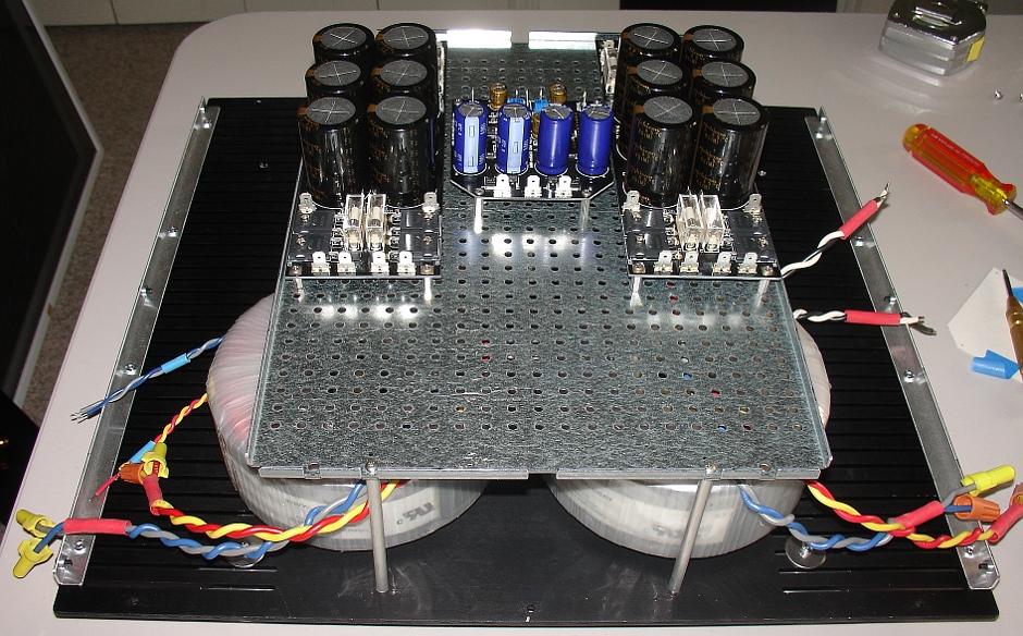

I have a layout question!
I'm planning on placing the power supply boards (and volt one) over the toroids, using a diyaudio store amplifier chassis bottom (the thick metal ones). The metal sheet is magnetic (steel, not aluminum). See the photo below.
Is the metal base enough shield to protect the ps boards from being so close to the top of the toroid (where the stray fields would be strongest I think)?
I could place the metal sheet perpendicular to the position in the photo so I can slide the ps boards away from the toroids and only the rectifier portion of the ps boards would be above the toroids. Would this be a better arrangement?
Or the boards are shielded by the metal sheet?
Or is using the steel sheet a bad idea (use aluminum instead)?

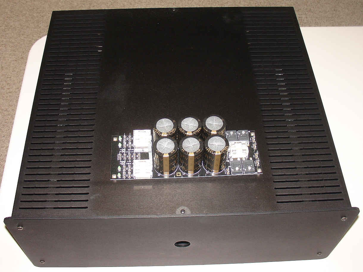

Some more progress...

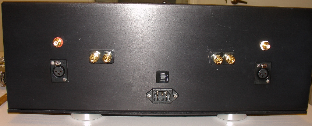

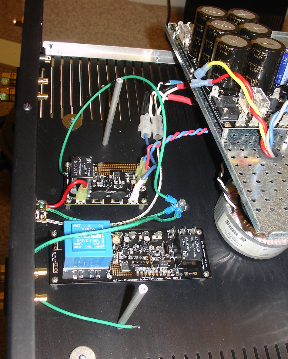

The cnc shop drilled the xlr connectors crooked... I tried fixing the holes but didn't get them completely square, but it lools better. I know it doesn't affect the sound, but I just wanted them to look a bit better.

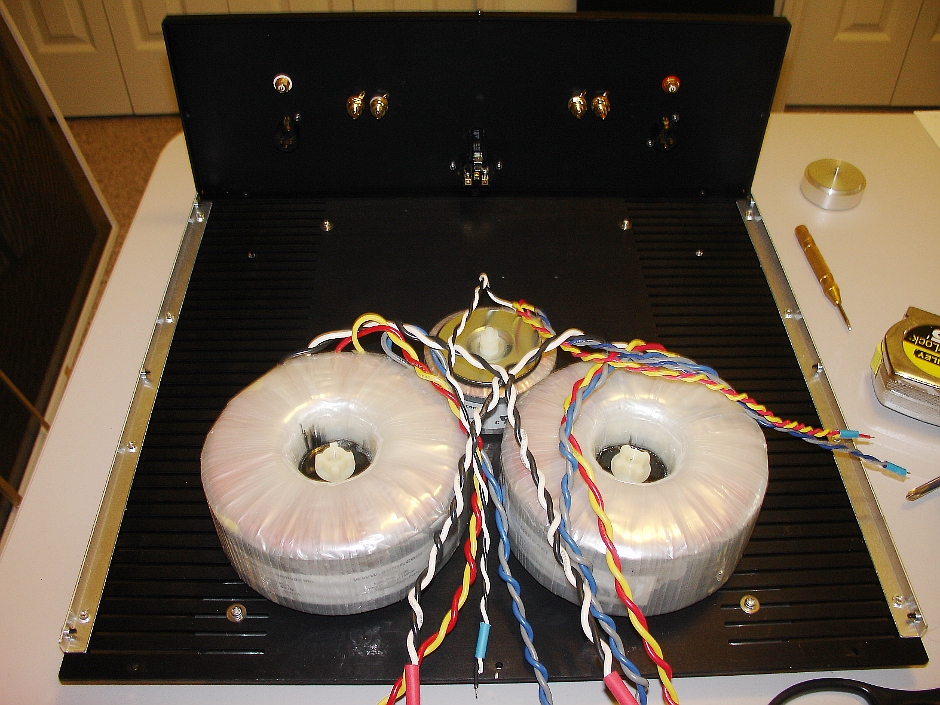

Put the feet and trafos. Ended adding one more foot to the chassis in the between the three trafos, it's a lot of weight.
Put in the AC controlling boards.
Added the "second floor" for ps boards.

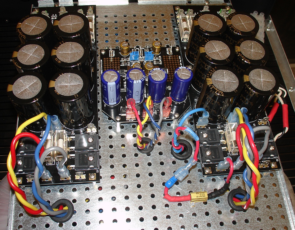

More progress...

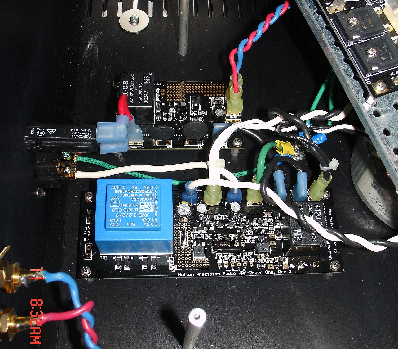

I fixed the AC control parts. Had a problem with the HPA-Power-One, so for testing I'm leaving it out of the wiring.
Drilled the "second floor" metal plate and ran trafo wires through the holes.
Fixed the metal base and heatsinks with amp boards, started wiring the power supplies to the amp boards.
Forgot to mention I tested the power supplies and all tested ok (no load output) and I set the Volt-One output to 80v, no load. Will readjust, per Anthony's instructions, after the amp boards are connected.

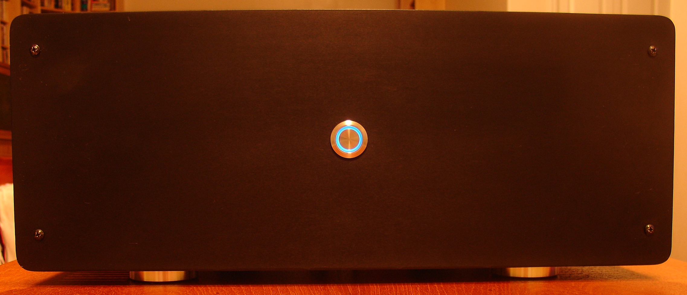

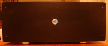

Sorry guys. It is finished and has been burning in for about a month. I will post the final photos and a review in the next couple of days.

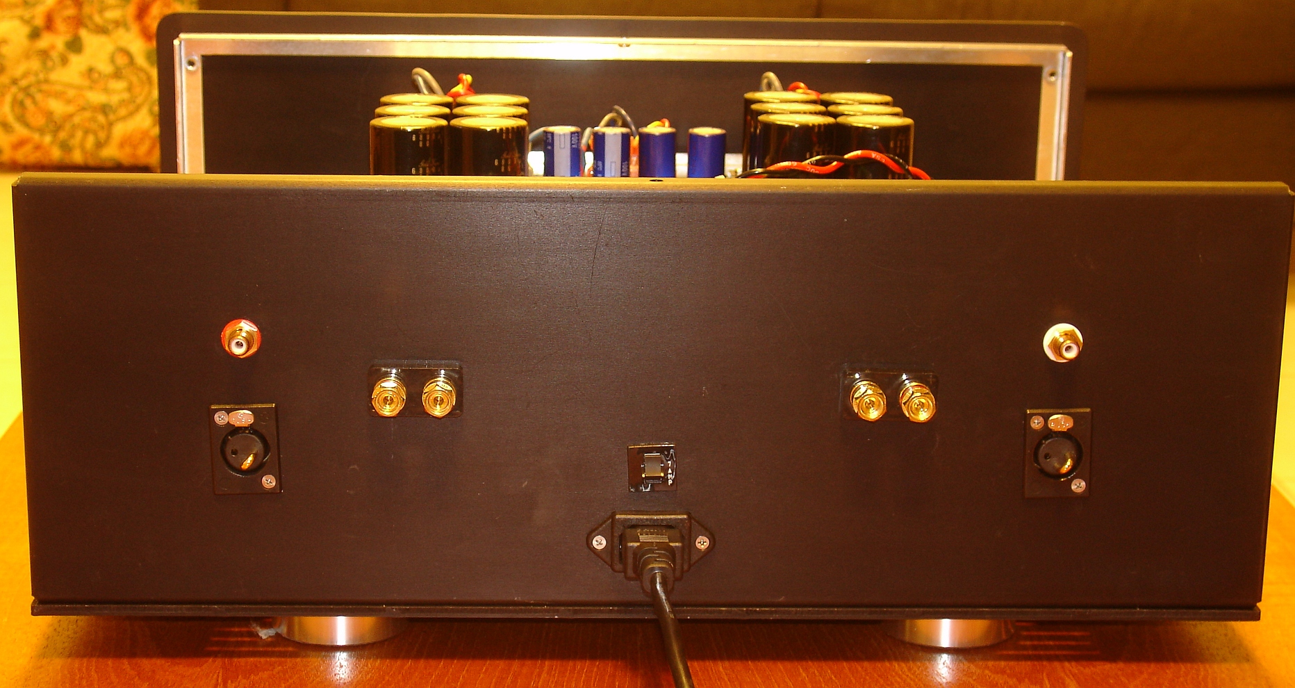

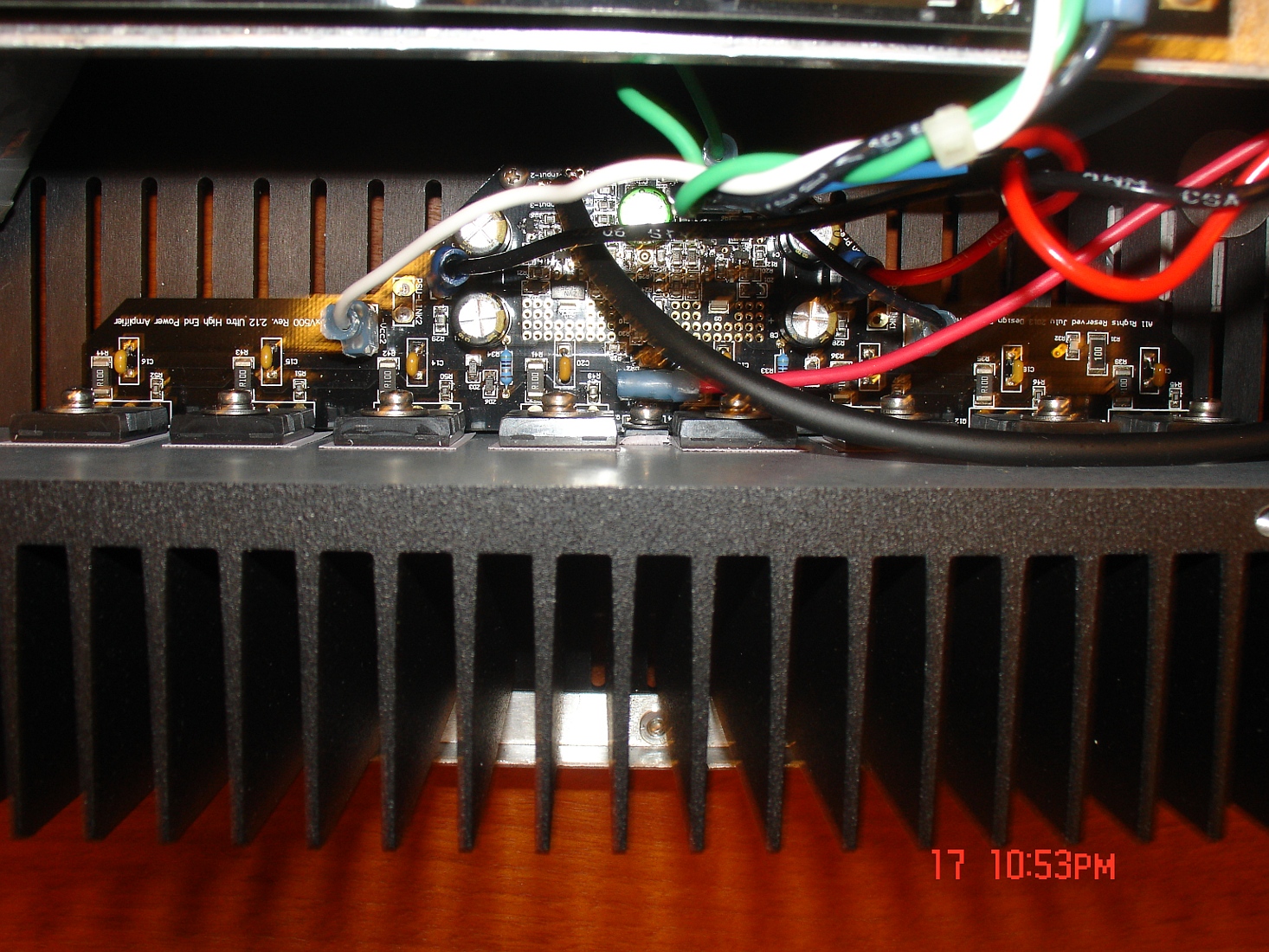

Amp running...
After completing it and realizing how big it ended up being, if you have the money, it might be easier to build two mono amps. However, the extra cost of going dual mono is not trivial.
In terms of power and its ability to drive my Acoustat 2+2 electrostatic speakers I have no complaints. The amp drives them very well! I drive the speakers to high volume levels without making the amp sound stressed. The bass is solid and well defined, the midrange clear, good presence and very smooth highs. The amp has excellent detail. But my favorite improvement bought about by the amp to my system is in imaging. The sound stage didn't get much wider than it was before, but it has gained depth and most importantly, all the instruments are clearly delineated and have space around them, things just float in space very nicely. Listening to some hires music really brings out the imaging capabilities of the amp (specially at night when all is quiet). Percussive elements (bells, cymbals, etc.) sometimes really do sound like they are in the room. Vocals have also benefited from the added detail. All in all, I'm very happy with the amp.
I used SumR toroids for all three transformers the amp has and I'm very happy with them. They were not cheap but not overly expensive either. They are dead quiet and very well built. I would highly recommend them. The amp itself is also dead quiet. Startup and shut off produce no thumps or noise of any kind. I have not tried using the amp's balanced input, all the listening has been done using the single ended inputs.
Now the caveats... my previous amp was a PS Audio 200c, over 25 years old, and a 250 watt class D amp (with a linear power supply). So I have not compared the amp to anything high end and modern in my system. I will be loaning it out to friends when I travel next year so I'll post their impressions when they give me feed back. However, my system now sounds good enough I don't have the desire to build another amp for a while. The nxv500 sounds great and I just want to enjoy my music for now!
It does need a couple of weeks of burning in. When I first played it I was a bit disappointed, the imaging and sound improvements were there, but not like what they are now. All aspects of the sound have improved as length of usage increases. Of course, it could all in my mind that after a few weeks of listening to the amp I have grown to like more the way it sounds...
Highly recommended!
