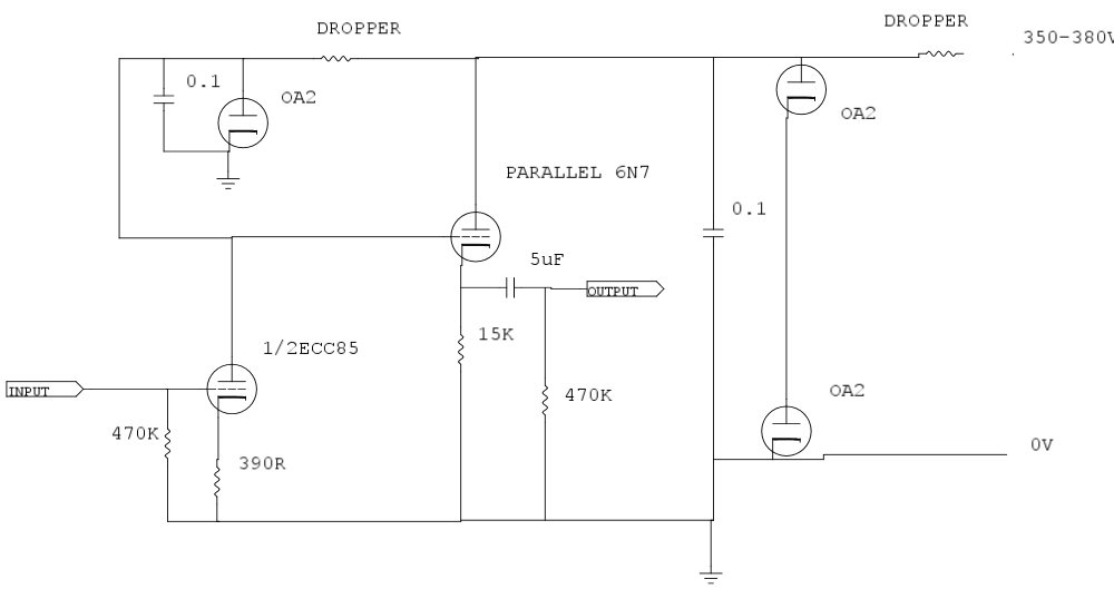

kianbach said:Explain please I'm a newbie
The anode resistor on the input tube is missing.

What sort of value should I use?
Is there a formula to work it out apart from Ohm's law for dropping voltage?
I've got some 6k8 and 10k resistors.Would either of these do?

I don't mean to be rude, but you're asking a lot of questions about arrows and you haven't yet defined the target. What are you trying to accomplish? Gain, source Z, load, distortion, signal-to-noise...?
Well,I've got an SRPP 6SN7 linestage atm and am looking for more gain and/or a different sound.A few months ago I tried Joel's 12AY7/6SN7 circuit but with ecc81 and 6N7 and liked the sound of it but was thinking of having 1/2 the B+ for the 1st stage and direct-coupling between stages,hence this sorry attempt at designing my own.I was hoping someone could point me in the right direction,I need to drive a SRPP 6SN7/2A3 SE power amp.

Use 300V B+ for ECC85 (omit OA2 and 0.1uF),
Va=150V, Ia=10mA, Vgc=-1V,
then
Rc=Vgc/Ia=100ohm (in your schematic 390ohm),
Ra=(Vcc-Va)/Ia=150/0,01=15kohm (dropper in your schematic).

Well it's built and running!Sounds nice,plenty of gain,Drives my 2A3SE no probs.Ear bleeding volume from my Lowther Acoustas.
Values as follows::
B+ 300v
Ecc85 anode R = 15k
Ecc85 cathode R = 220r
6N7 cathode R = 23.5k(47k x 2)
total current draw 25mA from a 100mA tranny.
