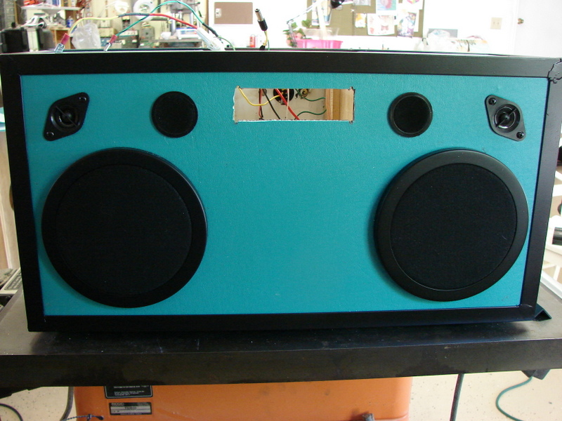

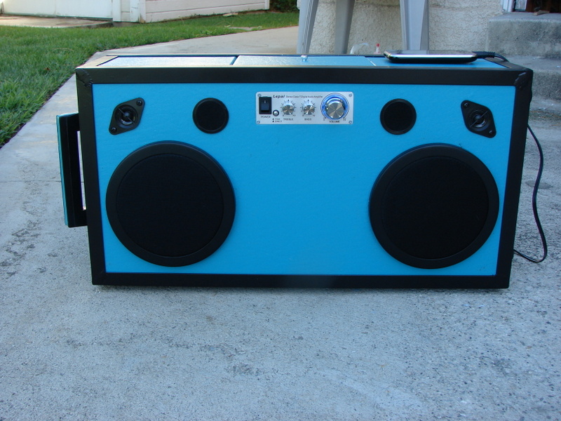

I am going on vacation at the end of next week and decided to build boombox I can take as carry on.

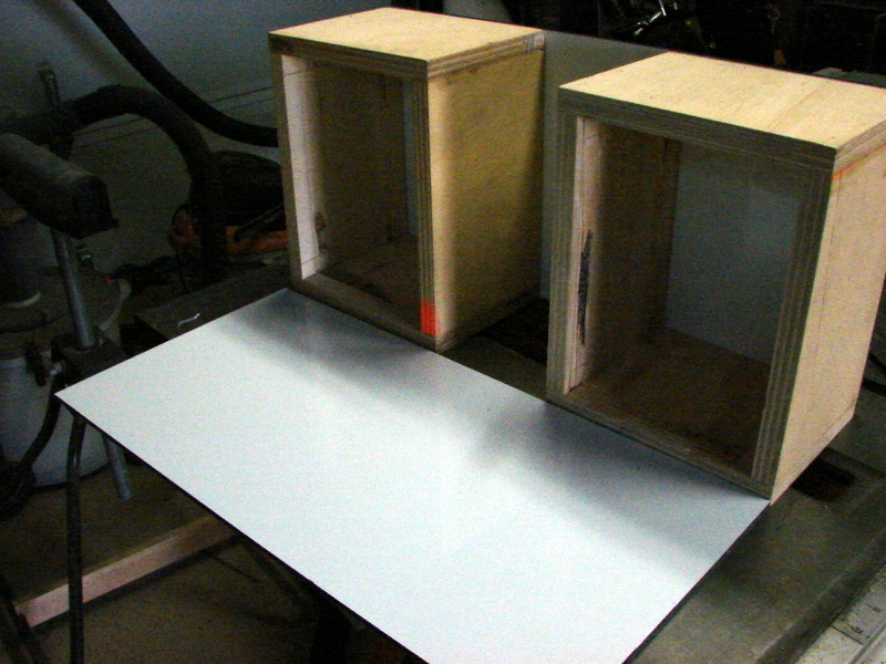

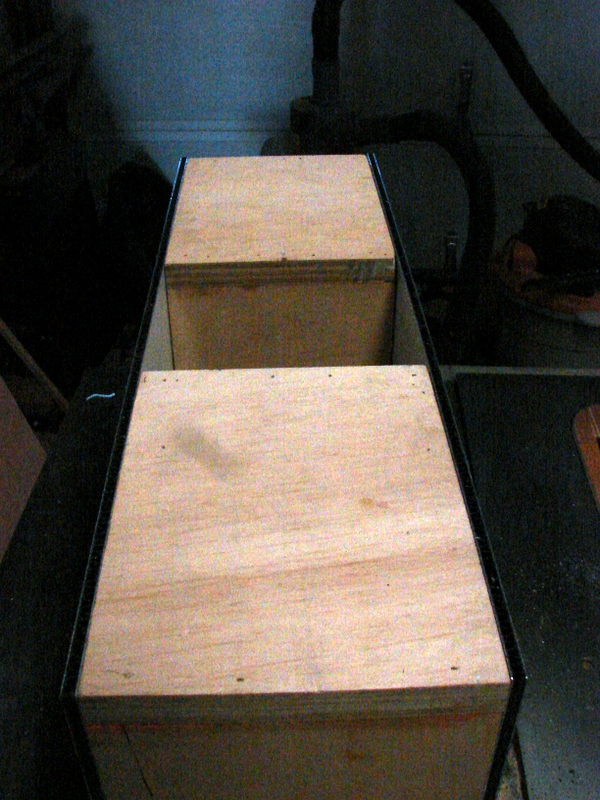

I used 4 Radio Shack 40-1354 drivers and 4 cheapo Audax tweeters. The pairs are wired in phase and the tweeters are crossed with a 4uf cap. The box has a basic speaker pocket made with 3/4 plywood and the fronts are skinned with a material I found at the surplus store. Don't know the name but it is pretty easy to work with. It is a 1/4 inch panel with aluminum skin with a plastic triangular comb to give it rigidity and strength. It is light and strong and cuts great in the table saw.

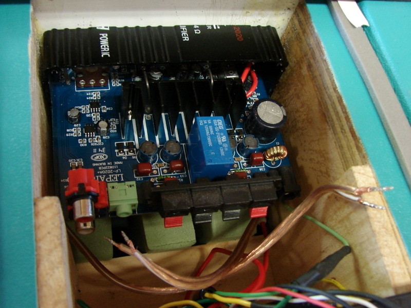

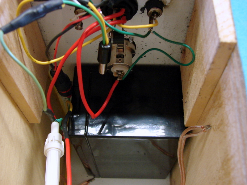

I decided to use a Lepai amp because it is what I had. Had I not had them I would have used something else. The Lepai's are cheaply made and very finicky. I burned one unit. I had to isolate the audio Input ground and the PS ground.
As far as the speaker tuning, I think I ended up with an aperiodic enclosure. Initially drilled a 1.5 inch hole to put a port. I tried different port sizes and looked at the impedance measurements for each. The impedance curve was the flattest with the 1.5 hole plugged with a piece of foam.

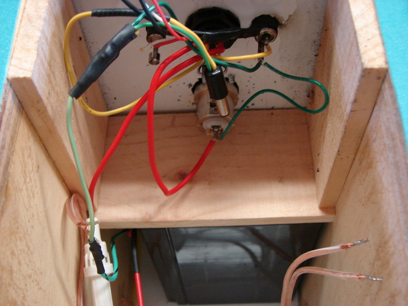

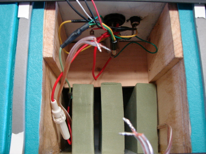

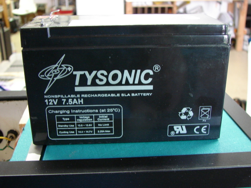

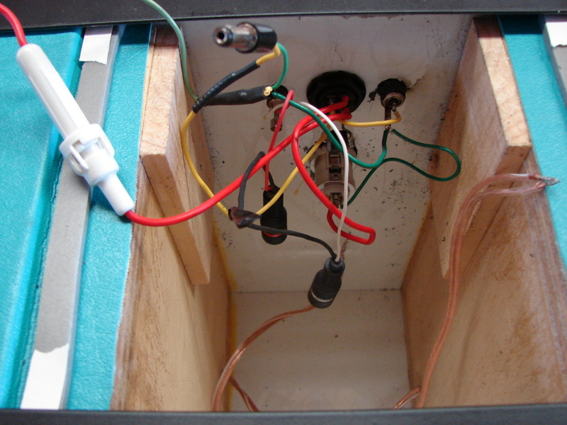

The battery is a 12V 7ah SLA battery. I used a DPDT to select between Battery operation and PS operation. In the PS operation the DPDT switch is wired so that the charger can be connected. The battery was connected with a 6amp diode in series so as to have the diode drop when the battery is fully charged. This way I do not have to modify the Lepai to accept the higher voltage.
I used the Lepai case itself as a large nut to hold the amp to the boombox, I used #2 screws.
Sounds quite nice and pretty loud. Need to find out if TSA will allow the SLA battery thru security.

second problem are you sure that the AMP can get this battery ? it is 7.5AH and i heard that for the Lepai you can connect up until 5 AH

how to connect the amplifier and the Battery ( just like yours ) together + i want to be able to charge it
