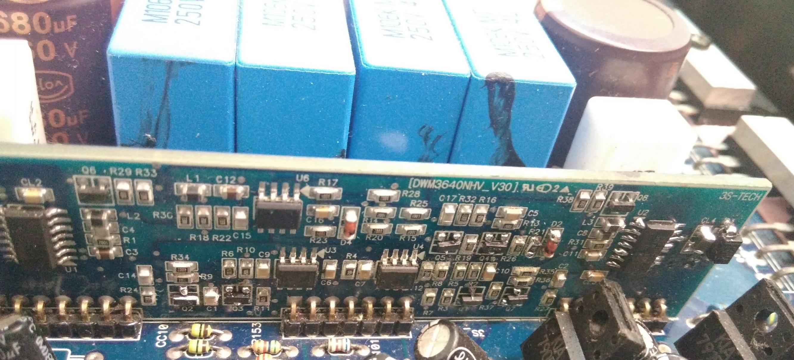

Another ir2184 base amp
The amp is going in protect.I could not find any fault so i disable the two driver ICs.By mistake instead of bridging pins 2 and 3 I bridge pins 1 and 2.Now amp is out of protect.
What does that indicate?
What should i check when it is in that state?

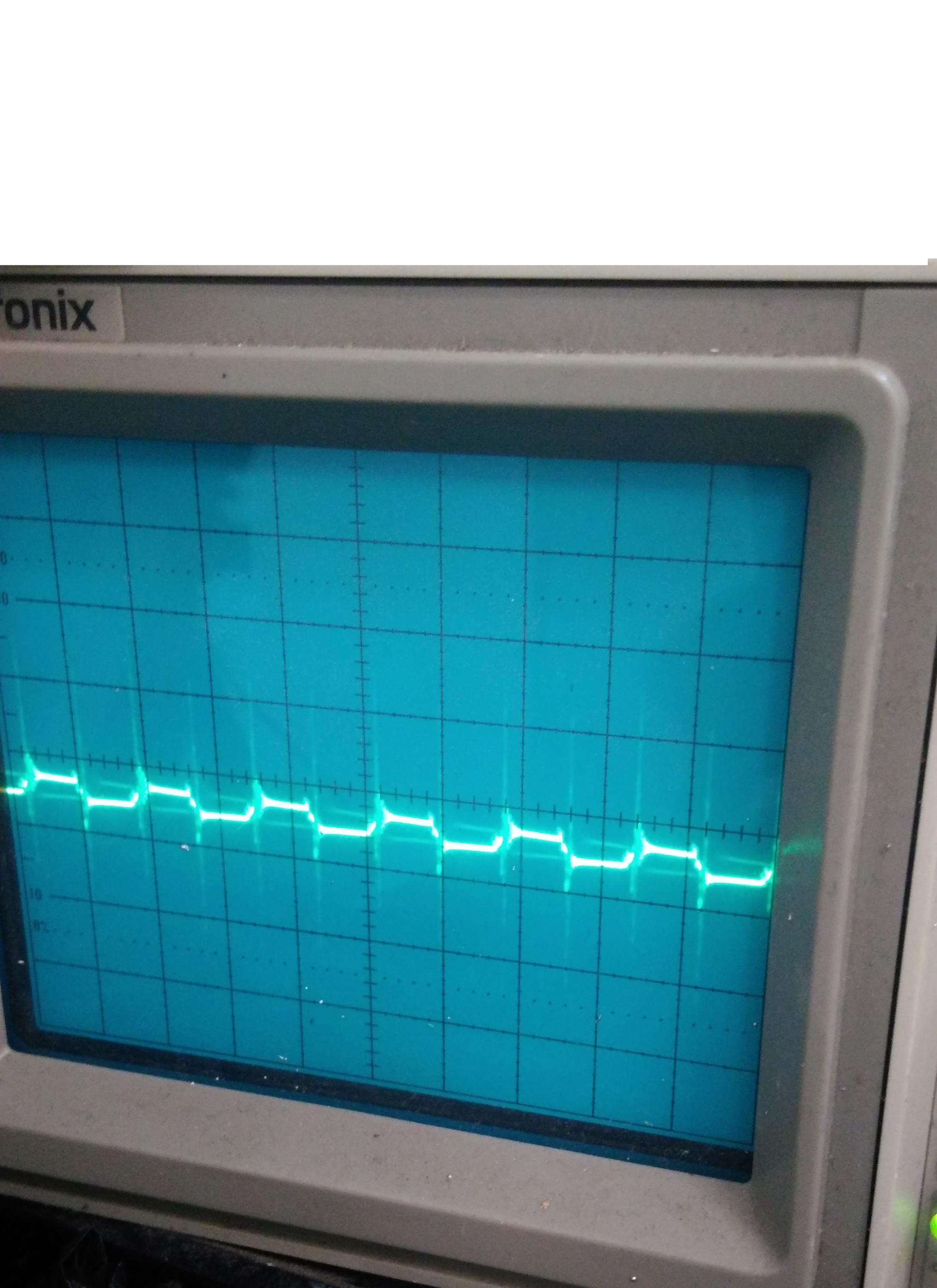

I see signal on pin 1 of the 072.The bottom clips before the top if I increase the signal.I see a square wave on pin7 of U4.The scope does not lock on the signal but I can clearly see the square wave.on pin one of the driver ICs I see a square wave but they not identical with same scope setting.
