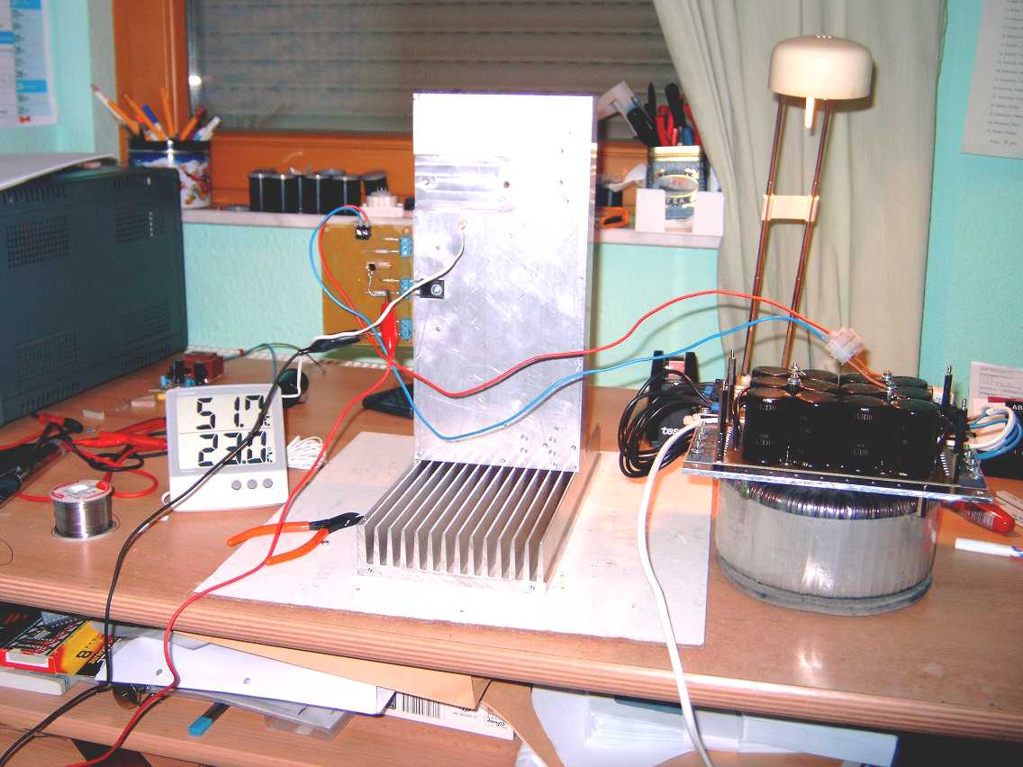

I tried my heatsink with a CCS and one IRFP254 by 44W dessipation. (22V/2A FET). My heatsink (one piece) is 300x140x40mm big.
This heat up approx. 30°C above ambient.
I turned them flat (horizontal fins) so this heat up 6°C more.
